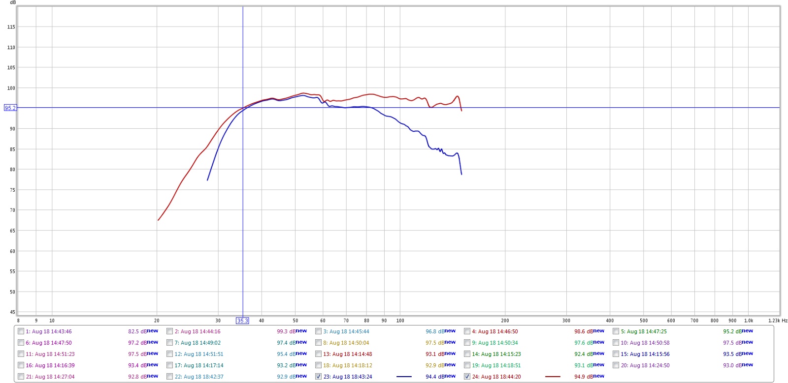

I didn't boost the low end at all and in fact my room required a 10 dB cut at 43 Hz (room resonance). Ignore the crazy dip at 90 that's also room as verified by my running a sweep with my T60 running full bandwidth (which has a naturally rising response) and it showed the same massive dive so clearly it's a room issue.

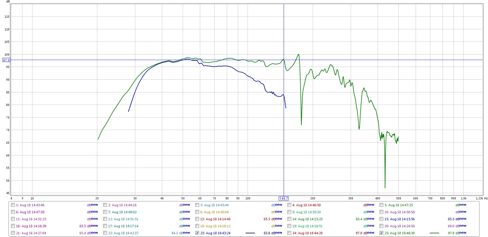

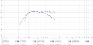

Ask and ye shall receive, here is a 3 inches from mouth away from the corner measurement done at a level where I had 0 worries about excursion, I took all filters EQ HP/LP etc off and here is the raw response in red with the HP LP no eq at all response in blue.
Yup that's looking nice.
Flat as a river stone to 117

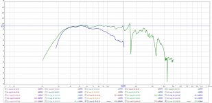

Oh, the green line picture is just run up to 500 Hz for those who are interested.
Mind you guys that the simulation showed a 3 db dip from 55-100 Hz whereas the "measured value" is actually darn near flat, ofc it's not an ideal measurement (center of a room measured extreme nearfield) but it's the best I can do for now.

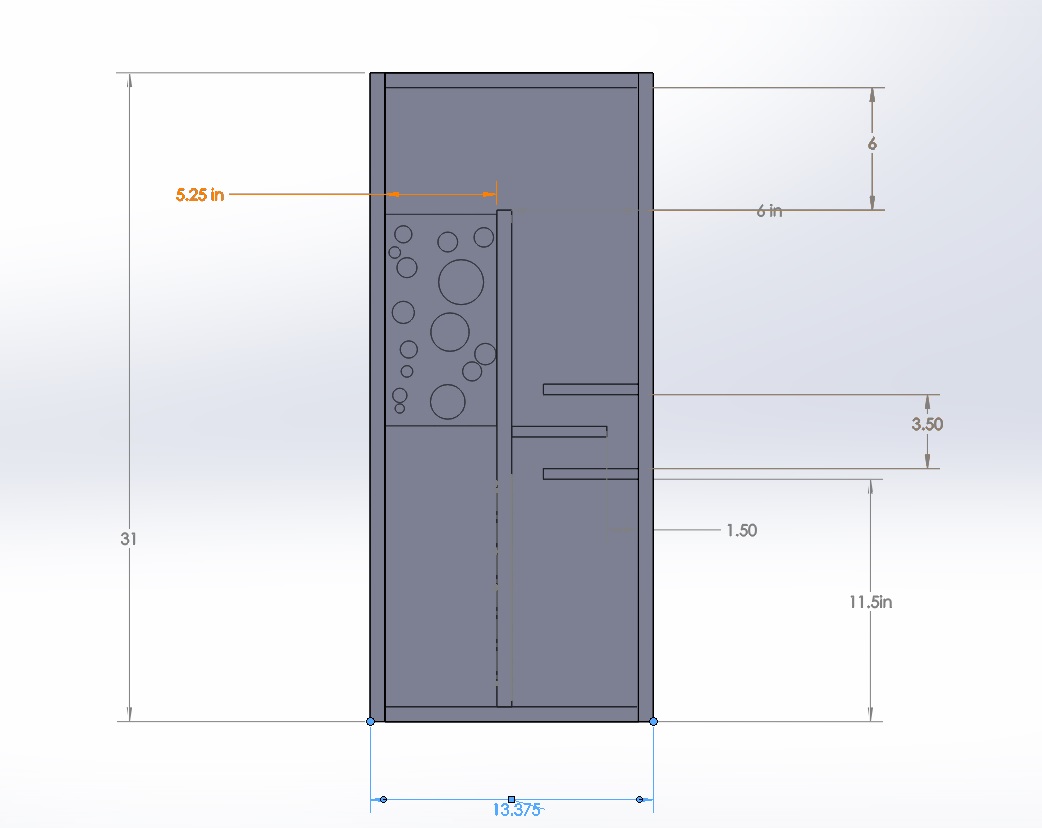

I actually changed it slightly from the "final CAD model" because I screwed up due to failure to label EVERYTHING. The only difference is the rear panel is shifted one wood thickness (3/4 inches) down. Other than that it's the following dimensions.
Here's my best effort at using solidworks to label all the pertinent details.
PS this is as close to "as built" as I can get the dimensions (added in the goof up).
Note my "actual brace" didn't have quite as many holes, I went to town when I was messing with solidworks. also, all my widths are only as accurate as the saw I was cutting on and I'm pretty sure the "5.25 inch" section could actually be 5.5 which shifts things over slightly, not too worried though as it shouldn't change much.

Thank you for getting those close measurements, its good to know that the saddle shaped response in the sim is really not an issue in reality. The same goes for the peak at the upper cutoff, its not nearly as bad as what we see in simulation
I typically care very little about saddles and peaks unless they are extreme because I expect to use EQ even if they do show up in the final measured result. I used 4 filters all with huge +- and widths to get the thing close to flat including room response, and that's starting with a relatively flat sub . Efficiency and displacement limited power handling are what I look for (and why the sws looks appealing).
(-might add the port lengths to that drawing) - how is the constricted port shown in a hornresp model?

Also, the port lengths are labeled. The width between those two panels is 6 inches, the distance between ports is also labeled, takes a little math but you can do it.
