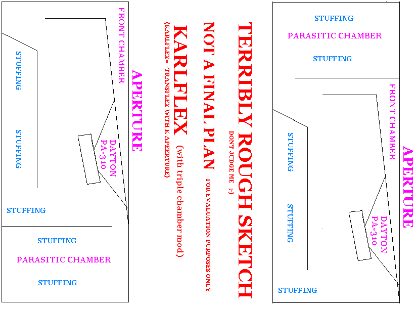

Freddi ,
Yep , that looks about right .... In your sketch it looks like you have the parasitic chamber's vent placed just after the main vent in the baffle? That does work in sim, and i think this method makes the front chamber seem larger, and does an exceptional job of controlling excursion ...... I also tried connecting the chamber to other areas such as immediately before the main vent (as in the H-PAS patent) which works well and last but not least i tried having the parasitic chamber's vent placed near the driver (S2-ish in HR-speak ) similar to the TC-Karlflex that i built recently and these latter options do have a nice flat response but compromise a small amount of cone control (only giving up about one quarter of one millimeter, no big deal)...
fwiw I once added a cavity to the top of a K's front chamber - Clements H-Pas
seems to be a re-naming of his earlier patent - guess these days easier to simulate
Freddi ,
I like the idea of flat response - - are you going to make a new simplified Karlflex? what do you see for "need" of front chamber volume in akabak with the 12" PA310? is there a sweet spot of not too much/not too little? Karlson's K12 from 1954 had around 0.6 or so cubic foot front chamber and around 1.2 cubic foot rear chamber.

FreddiTech works! Karlflex with FreddiTech mod
Freddi ,
This is my answer to your sketch in post #1320
I think you will like this
I toyed around with the idea in Akabak and found that your extension to the front chamber can act like a quarter wave stub, and at around 30 to 35cm in length it does a nice job of taming the 5th harmonic ripple! The 3rd harmonic is already suppressed with this Karflex design because of the offset driver, but the 5th and higher harmonics can be a problem in an extended bandwidth design like we are attempting to create with this PA-310 driver (we wouldn't worry about getting any higher than 240hz with the Alpine or LAB15 drivers , but with the PA-310 we can reach much higher) .... With this mod there is a considerably smoother transition from the upper pipe harmonics into the range where the front chamber starts to add gain and augment the output ... I will post the Akabak response charts later for comparison when i get back on my Akabak computer
Freddi ,

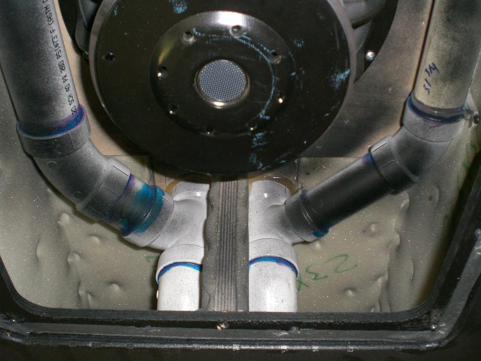

TB,
I think Danley may have used tuned stubs in one of his early Tapped Horns, was it his DTS tower sub? I bet someone can fill us in on that..
Hi Matthew,
I didn't phrase my response to X correctly (sorry). TD used it in his first TH the DTS-20 (see his patent). He used what he calls 4 stubs, and what looks like 2 stubs made from pvc pipe. Closed end 1/4 wave stubs. I posted that in the collaborative thread a long time ago, the pictures are from the Klipsch Forum. I like the way of using duct/viscosity in AkAbak, just didn't have a good feel for the visc #.

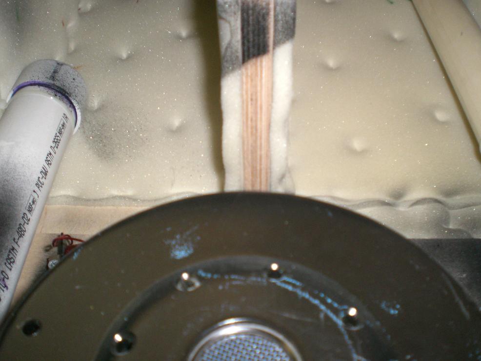

TB46,
Ok , that is an interesting setup ... In these pictures we are looking through the driver access panel right? So the 1/4 wave stubs have their open ends near the mouth of the TH? Or am i looking at this the wrong way?
Yeah , the use of VISC is helpful with these quarter wave stubs, it really smooths out the resonant range of the stub in Akabak without creating much loss down at FB ... I have been using VISC=50 but maybe that is a bit much according to X ?

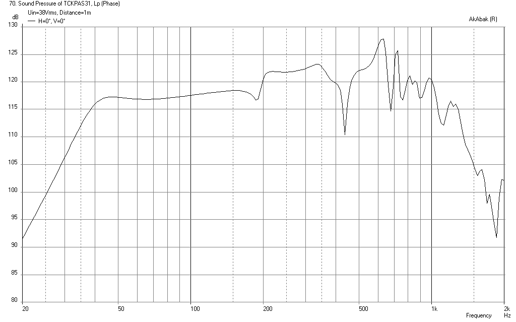

Here are the result's of the FreddiTech stub added to the Karlflex in Akabak (an idea based on his sketch from post #1320).... One set of graphs has the standard S1 CSA and the other set has a squeezed down S1 which consistently seems to work a little better and frees up more space behind the driver just in case someone wanted to use a driver with more mounting depth, or it also opens up the possibility of having an even larger front chamber , or even a baffle that folds inwards at the midpoint for mounting two 10" drivers! ...
Mr TB46 , i have a different version of the script that uses the Clements style chamber and an extra long S1 section with expansion which was inspired by some of your sketches and sims and your suggestions of the H-PAS concept , it actually looks pretty good too ... Let me know if you want to see it ..

Hi Matthew,
Post #1330: "... we are looking through the driver access panel right? So the 1/4 wave stubs have their open ends near the mouth of the TH?..."
We are looking at the back of the driver through the access panel in Post #1329, the stubs have their open end connected through the driver baffle into the general throat area, and the other end of the pipes seems to go up inside the horn path, and those stub ends are closed.

Hi Matthew,
TB46,
Ok , I think i get it now, so the open ends of those resonant pipes would basically attach to the S2 section if we were modeling the DTS20 in Hornresponse ...

Ok , you got it ! I will post a script that you can throw into Akabak and use as a guinea pig for learning purposes
The particular sketch and script that i will attach to this post are the product of some of your ideas and suggestions .... I remember seeing some of the excellent drawings that you created a while back of different Karlflex revisions and some of them had extended and folded S1 sections that tapered down towards the closed end , and i thought i might try experimenting with that idea in Akabak ..... I also experimented with the Clements H-PAS concept that you suggested as well and it seemed to work well in conjunction with the long tapered S1 .....
I noticed some patterns regarding the excursion controlling effects of both the Clements concept and also the Augsperger-Weems method (they both accomplish some of the same goals) which i will expound upon in a later post, but i can say that in a 90 liter package this style of Karlflex with the parasitic chamber will likely have good cone control but unfortunately will (likely) be overdamped with the PA-310 HOWEVER this same 90L box could be excellent for something with a stronger motor like a Definimax 4012 .... In order to make a Karlflex cabinet with parasitic chamber work well with a PA-310 it would have to be made wider than the default 13.5" width in order to avoid being overdamped by allowing for more internal airspace (The sim i will post here is 1.2x width or 16.2" wide, about 35" tall and 112L net) . It would be a larger cab but generates respectable output from the Dayton driver ... Might be good for a set of cabs that won't need to be quite as compact or portable (these are 13% larger than the Fredditech Karlflex boxes for the PA-310).....
This sort of parasitic chamber does not seem to require much stuffing, only a very small amount, at least in this configuration...
When using this chamber the main vent can also be made surprisingly short (about half the length of a normal Karflex vent/constriction at 40hz tuning) ...
