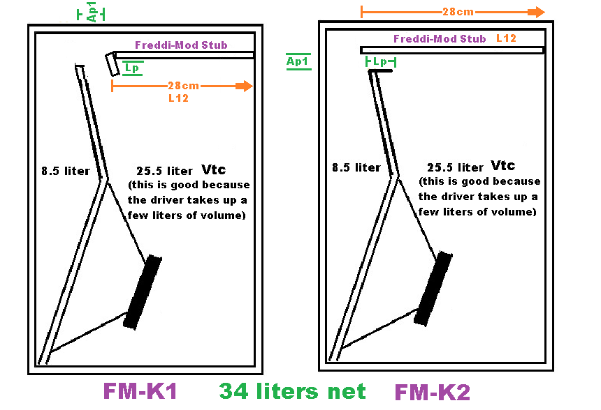

A couple of rough edits
Ok , here we go ...
Freddi, now that i realize that this cabinet is probably around 12" deep i can see that the duct concept which you came up with earlier works out well if we need to make the Freddi-Mod stub 28cm long in a cabinet this size ....
See the rough edits below, FM-K2 (your duct idea) works out better than the FM-K1 at this cabinet's depth .......
FM-K2 style looks like a winner, shall we move forward with it and proceed to fill-in the rest of the details?

Matthew - according to the schematic from one example above it looks like fhe front chamber would be around 16 liters (segments 2 +3 volumes) sans the stub volume. Is that correct?
Does segment 2's lenth correspond well to the "upper half" of the front chamber's height? What can
be adjusted there with some confidence ?

It is looking like XRK's original outer dimensions work perfectly for us because we end up right at where we need to be with the internal volumes (and close enough with the rear/front volume ratios if we stick with XRK's baffle angle) ....
MMJ - the 8.5 liter and 25.5 liter numbers are from that illustration of xrk971's XKi for my P-Audio SN10C coax. What do you think will be the best chamber numbers for this Delta10A Karlflex ? Might they end up being the same as X's alignment?
Yes, I think they might be almost identical to X's alignment ...
If our Freddi-Mod stub has a Cross Sectional Area of 143cm2 and is 28cm long then that results in almost exactly 4 liters of volume in the stub, and if we add that to the 8.5 liters in the traditional front chamber of X's cabinet design then we end up with a total combined front chamber volume of 12.5 liters which is incredibly close to half of 25.5 liters ...... A 2:1 ratio ...
Unfortunately no, as far as i am aware there still is no accurate way to go about modeling a Karlson's front chamber/aperture/slot in Hornresp ..
Lets say I want to examine that 8.5 liter front chamber for xrk971's XKI. What would be done?
You would do that by making the S1 and S2 CSA 143cm2 and L12 28cm in length ..... NOTE: S2 and the interchamber duct (Ap1/Lp) connect directly together in the Hornresp model but reducing the CSA of the interchamber duct to 143cm2 may be problematic when it comes to air particle velocity , so this is something that needs to be checked on with enough voltage driving the model to make the driver hit it's Xmax rating ..

Good news ... Looks like the interchamber duct only needs to have about 145cm2 CSA in order to avoid problems with Air-Particle Velocity , even if the driver is pushed to 6mm of excursion:checked: ...... So you were totally right about 180cm2 being an unnecessarily large duct:checked: ....
Did i ever tell you that you have a very good feel for this? ;) You are good at this..:up:
145cm2 also happens to be the area figure which you can use with the Freddi-Mod Stub resulting in just enough volume to get our combined front chamber to rear chamber volume ratio extremely close to a 2:1 :D ..

Since the Freddi-Mod stub takes the place of the old interchamber duct it seems to me that we can go with X's original outer dimensions considering that our new interchamber duct doesn't have enough depth to take up any significant volume of it's own .. :)
well - in the dream land of wishful thinking :) - its getting closer (146cm.2 model is attacjed)
Since the model says a stub of 10.5" is ok, can we assume the small unslotted portion of the front panel effectively lenghtens that stub "a bit" ? If so, should the gap between the stub's front edge and inside of the front panel be made the height of the stub opening - ?
Will the stub board be less than 10.6" in length due to the front panel proximity and "left turn" added kength of that duct?
How deep should the cabinet be to make things work in harmony?
