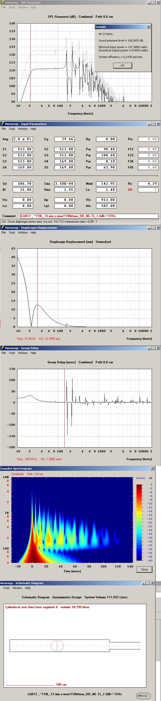

hey MMJ - if you ever get time, would you eyeball this K as a constricted transflex and come up with a hornresp model? I want to see how this style behaves in general in the low end and how it might scale (the drawing below is scaled down from an 8 inch K) (I've no idea how to fudge its exit)

my 41.5" tall K18 with curved upper reflector came out pretty nice sound-wise - it goes to 4KHz on-axis with the old EVM18B - But I don't feel one bit confident about "designing" the things. Just blocking say 6 inches of the narrow upper part of the aperture results in a less airy and less agile sound (why?) I like the sound of this one a lot - but not its looks - maybe a trim strip below the woofer would help a bit.
help me make one of these too in a 10" or 12 "
this cabinet is ~41.5" tall, 21.5" wide and 16 inches deep
- it has no front "shelf" but does sport a rear lowpass choke/shelf

The K12 and low tuned X15 copy from post #2155 look disastrous with those deep notches in response , the 115BK is not so bad .... .
Your 41.5" tall K18 from post #2156 looks relatively fantastic!
What features of these designs do you suppose makes some of them perform better than others? Do you feel that the shelves and chokes play a part here?
If you prefer the taller dimensions (like your K18) then yes we can definitely scale that for your 12" Eminence driver while retaining the height ... ... I like the idea of a longer total path length with minimal internal folds and less Mass Loading required at the interchamber duct ....The "Freddi-mod" stuffed stub at the end of the interchamber duct would help to tame some of the harmonic energy that such a QW resonator would generate... ..... Will have to see what Akabak thinks of the idea . .. It only takes a path length of four feet (or 4.5 feet) with constant CSA in order to get into the tuning range that you want..... Would be easy enough to integrate a "choke", it is basically like setting up a rear compression chamber or ported throat chamber if i am understanding it correctly ..
