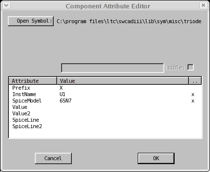

subckt where?
Being an idiot adrift in the world of spice, could someone write out exactly what and where I put a tube model into LTSpice so that the engine will recognize it?
I tried entering this as a Spice Directive
.subckt 5687 curves markers P G K
Bp P K I=(0.1305431537m)*uramp(V(P,K)*ln(1.0+(-0.02783234437)+exp((6.358374034)+(6.358374034)*((18.10314636)+(-49.38307311m)*V(G,K))*V(G,K)/sqrt((23.05269276)**2+(V(P,K)-(-0.7195968334))**2)))/(6.358374034))**(1.26765549)
.ends
and putting
5687 curves markers
into the value line of the tube in the schematic, but it won't accept this or any other variation I have tried.
Thanks for any help,
Michael

Model name should not have spaces in it... So do something like (either as a Spice directive or in .included file):
.subckt 6SN7 P G K
Cgp G P 4.0p
Ci G K 2.6p
Co P K 0.7p
Bp P K I=(0.02101361337m)*uramp(V(P,K)*ln(1.0+(-0.07065996889)+exp((4.906641927)+(4.906641927)*((21.00937615)+(-88.11984935m)*V(G,K))*V(G,K)/sqrt((26.83919821)**2+(V(P,K)-(5.377562838))**2)))/(4.906641927))**(1.370968473)
.ends 6SN7
Then set model parameters as in the attached screen shot.

Most excellent
Andrei,
Thank you, that did the trick. I haven't played with spice in a year or so and I wasn't competent then. I do distinctly remember having similar problems then, but I have changed computers and I couldn't find any old files to refer to.
Your curve captor seems to work well, once I sort have figured out how to enter the values. Still some work to do on that front too.
Thanks again,
Michael
