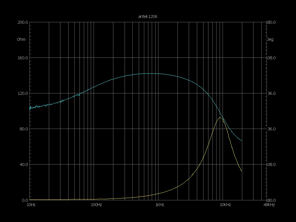

I did a simple test of a transformer that I am testing for step-up use on ESL's and it seems to be right in line with the values I am getting from VA and one other program that I use for for finding values and impedance's with single frequency's.
I will check in more detail just to be sure though.
Here is the plot that I just did using a modified Antek AS-1206 with the 120V winding's open and with the magnetic and electrostatic shields removed.
What took less than 5 minutes saved me hours and hours and hours of having to plot each individual frequency manually by hand on some graph paper!!!!

Glad to help. When I started, we did everything by single measurement and graph paper, so I know your pain.
Look at the values above 10K carefully. I used a 10 Ohm load resistor and I think the impedance droops. I am about to retest with 200 Ohms.
