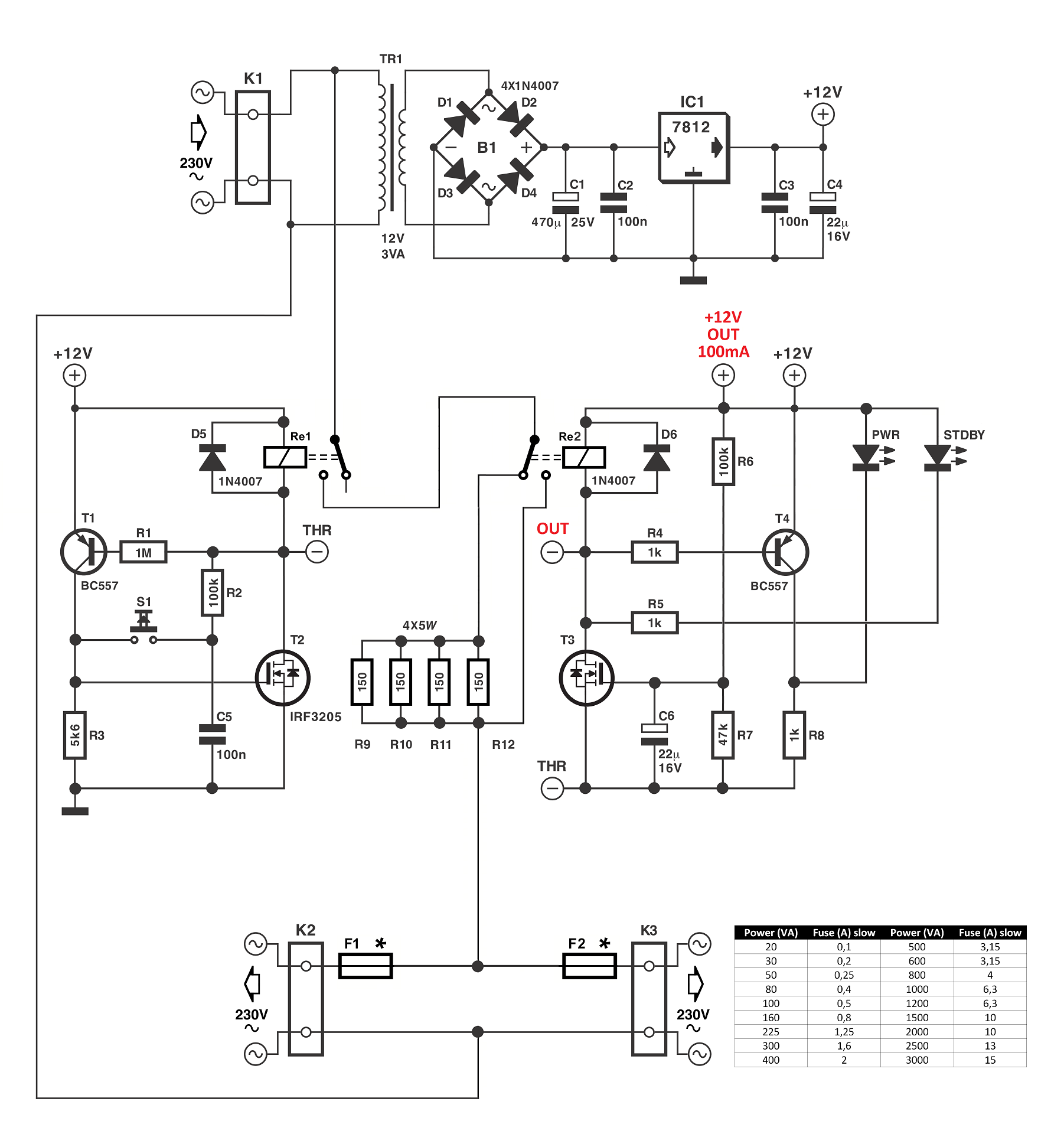

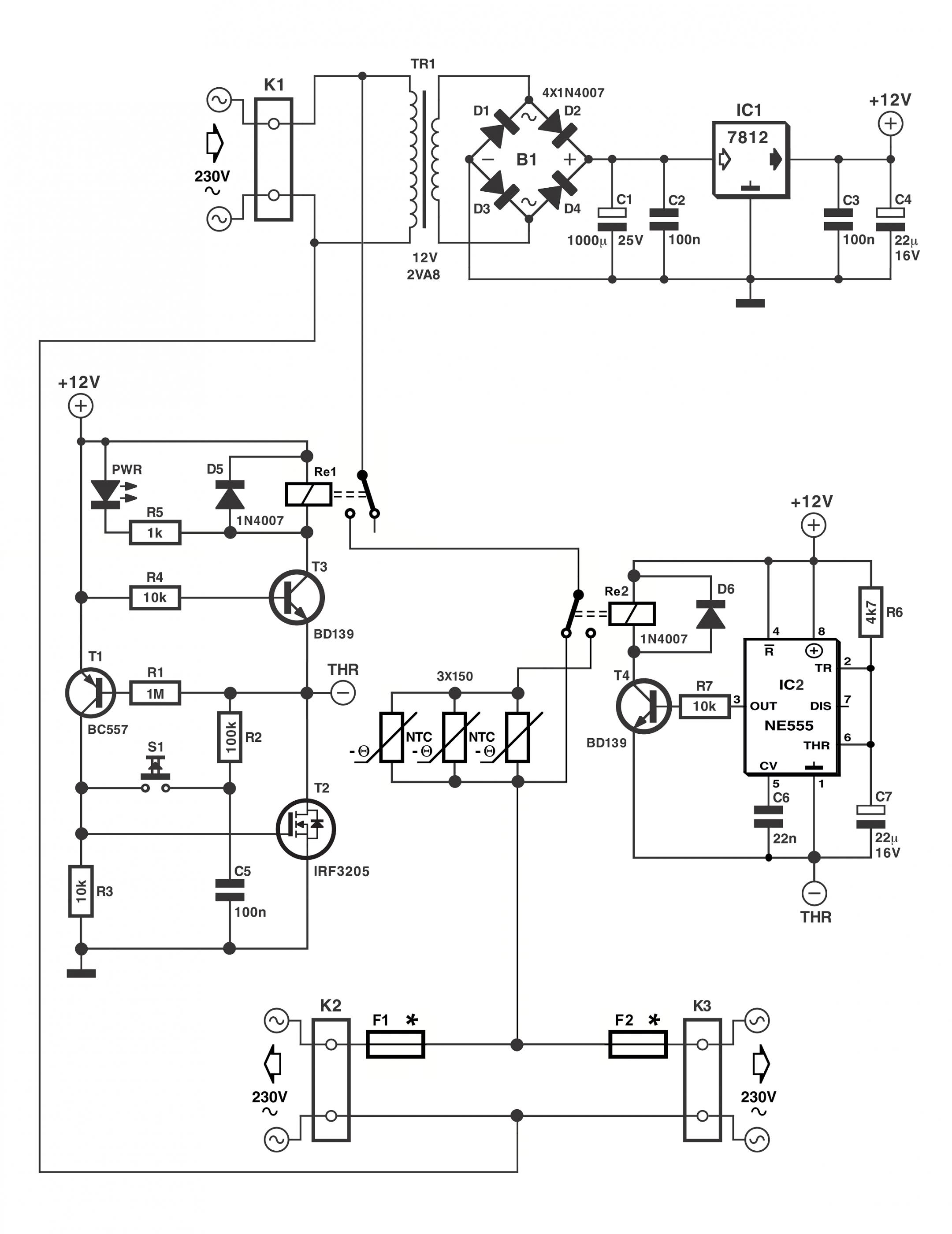

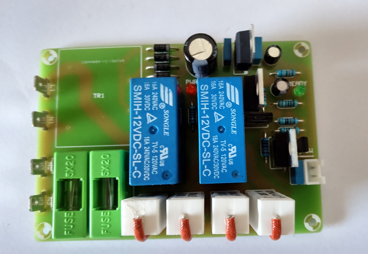

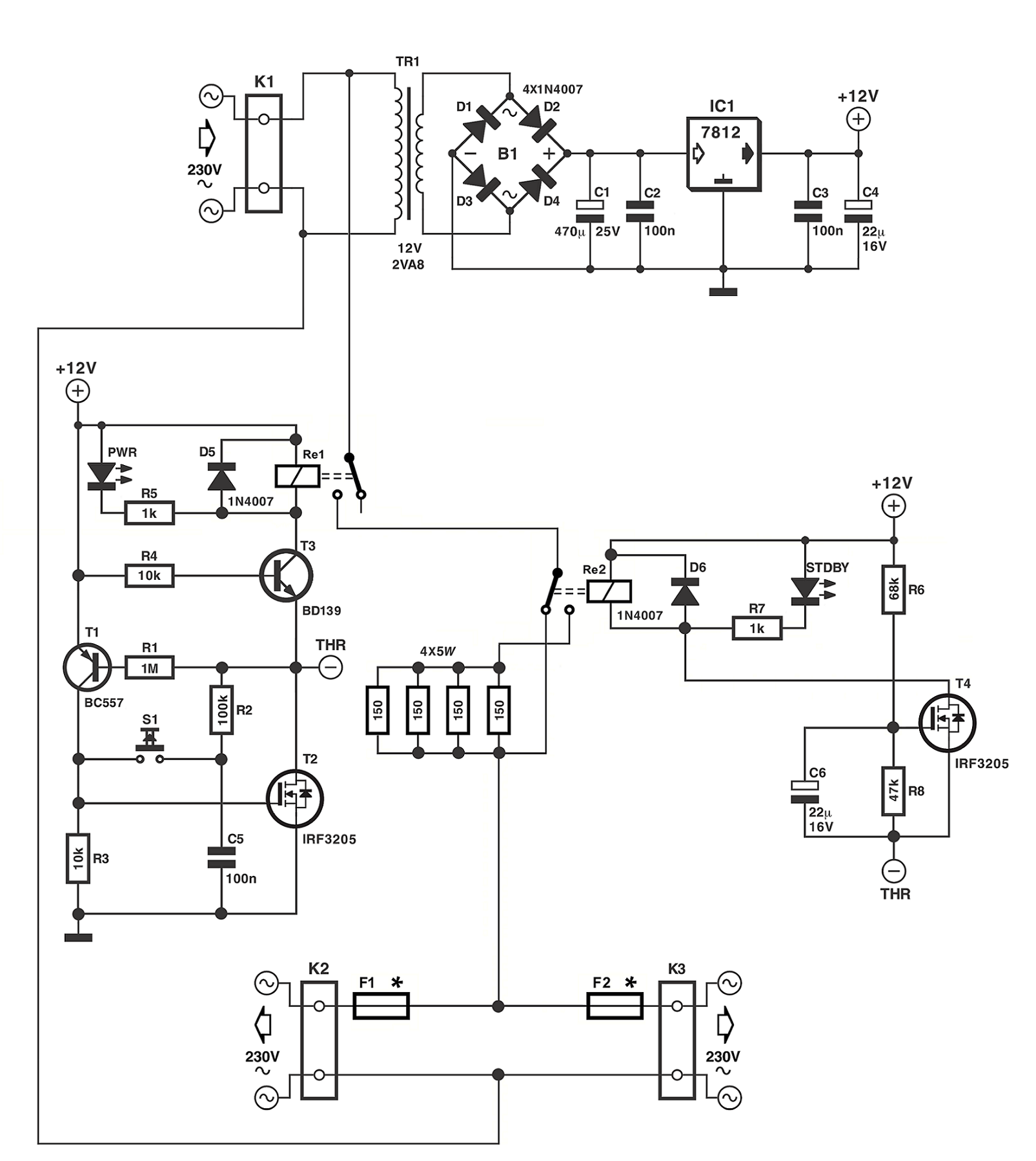

Hi everyone. I have designed a softstart with push button so that the amplifier can be switch ON or OFF upon pressing push button.
Delay is 114ms and would like to show schematic if this will work and how many time it needs soft start to be connected to thermistors? I read online that the recommanded time is 100ms.
So what do you think of schematic? Do i need some modifications?
Here is the schematic:)

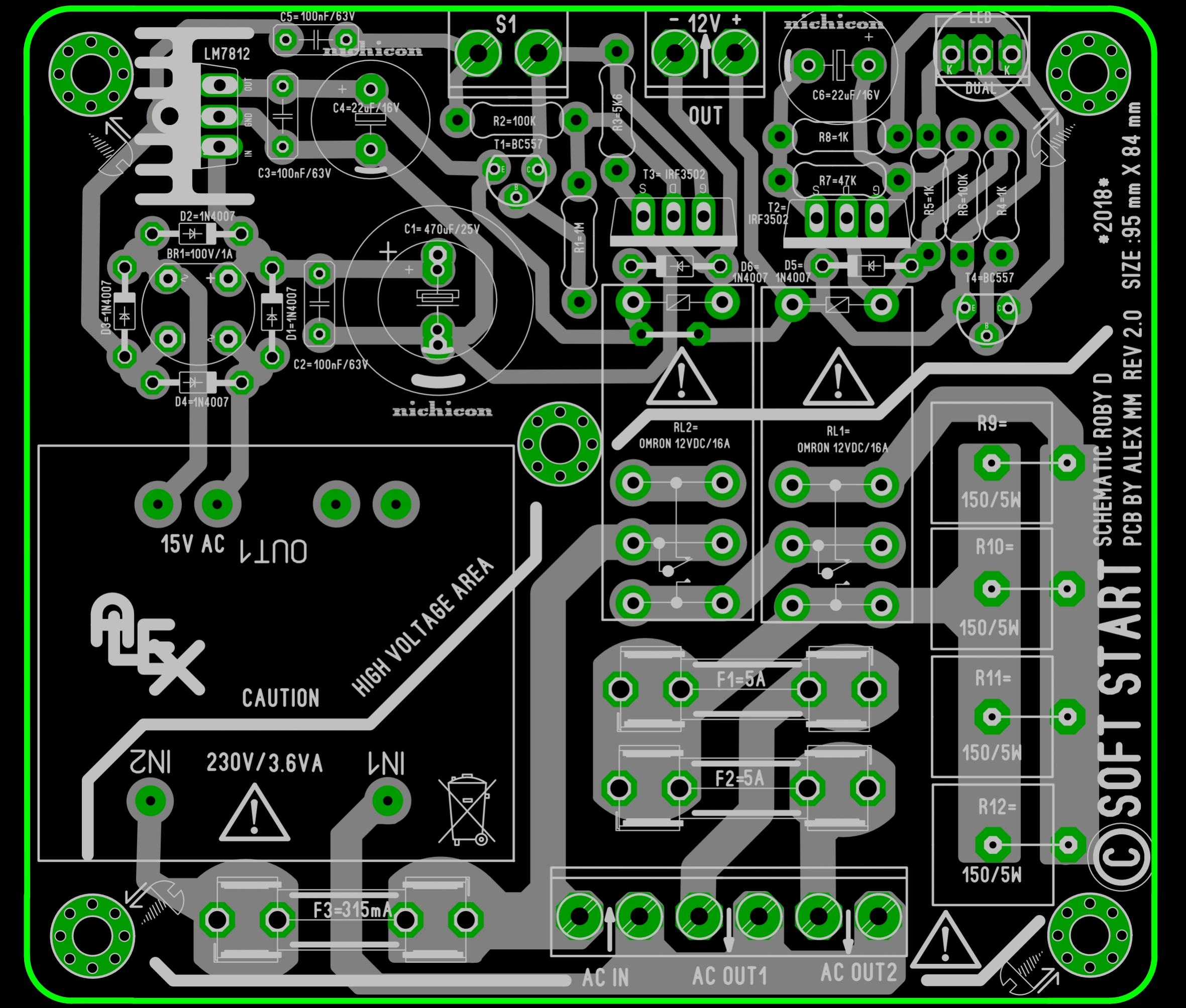

Here i publish UPDATED SoftStart that have delay 1,5sec. That is more that enought (1 cycle = 50Hz/230VAC = 217ms, @50Hz we have 5 cycle to limit inrush current so 5 cycles x 217ms = 1086ms or 1,1second is needed so 1,5sec is set using R6 - 68k and C6 - 22uF to give 1,5sec delay)-
Here is schematic and PCB files who wants it to build it.

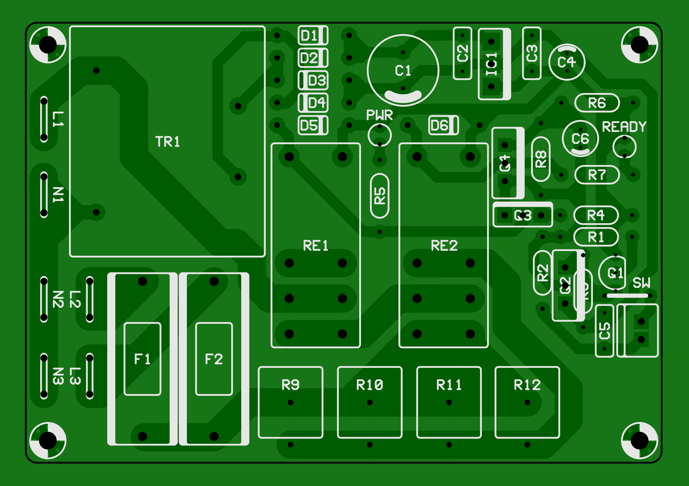

  • SOFTSTART-PCB.pdf

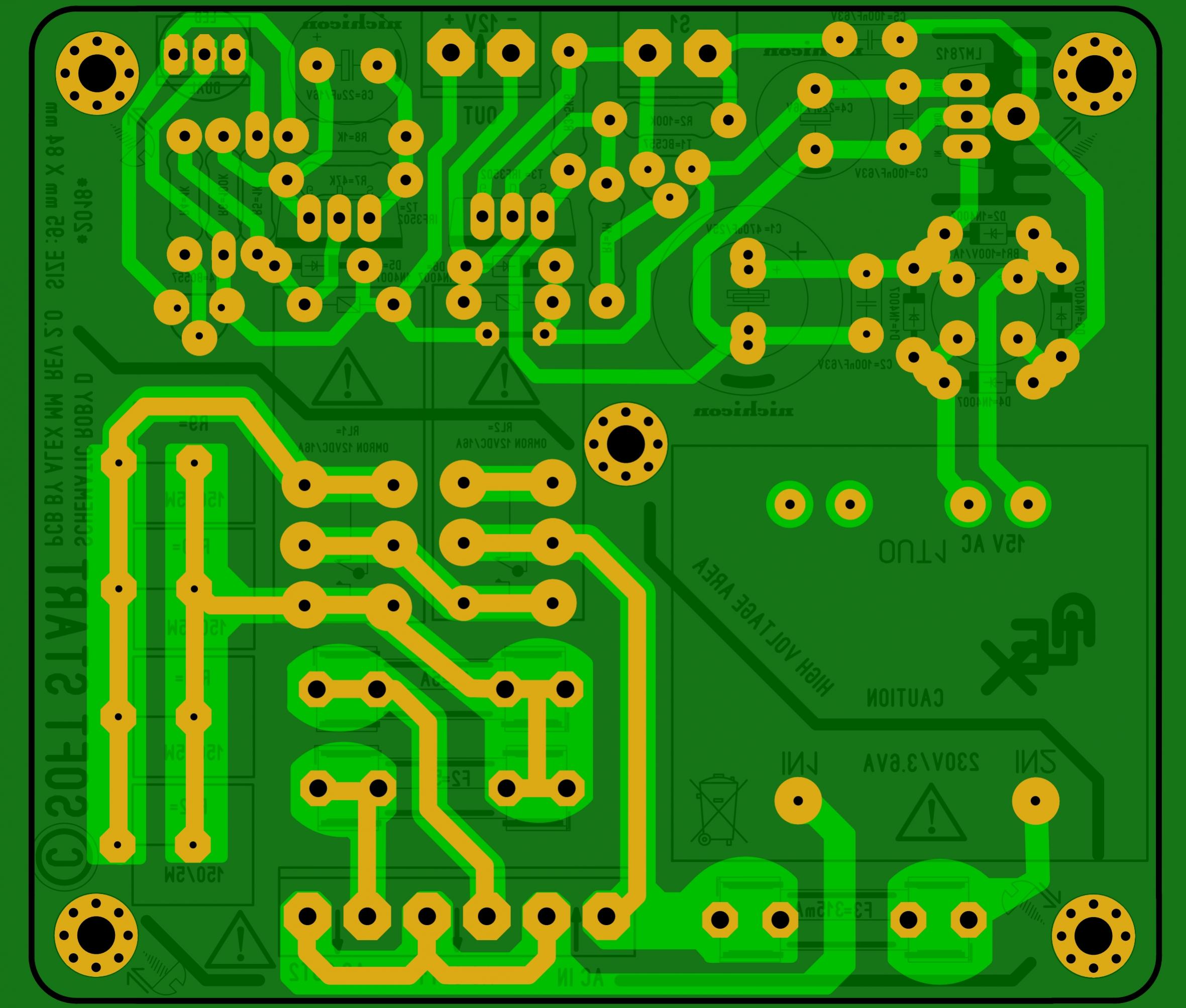

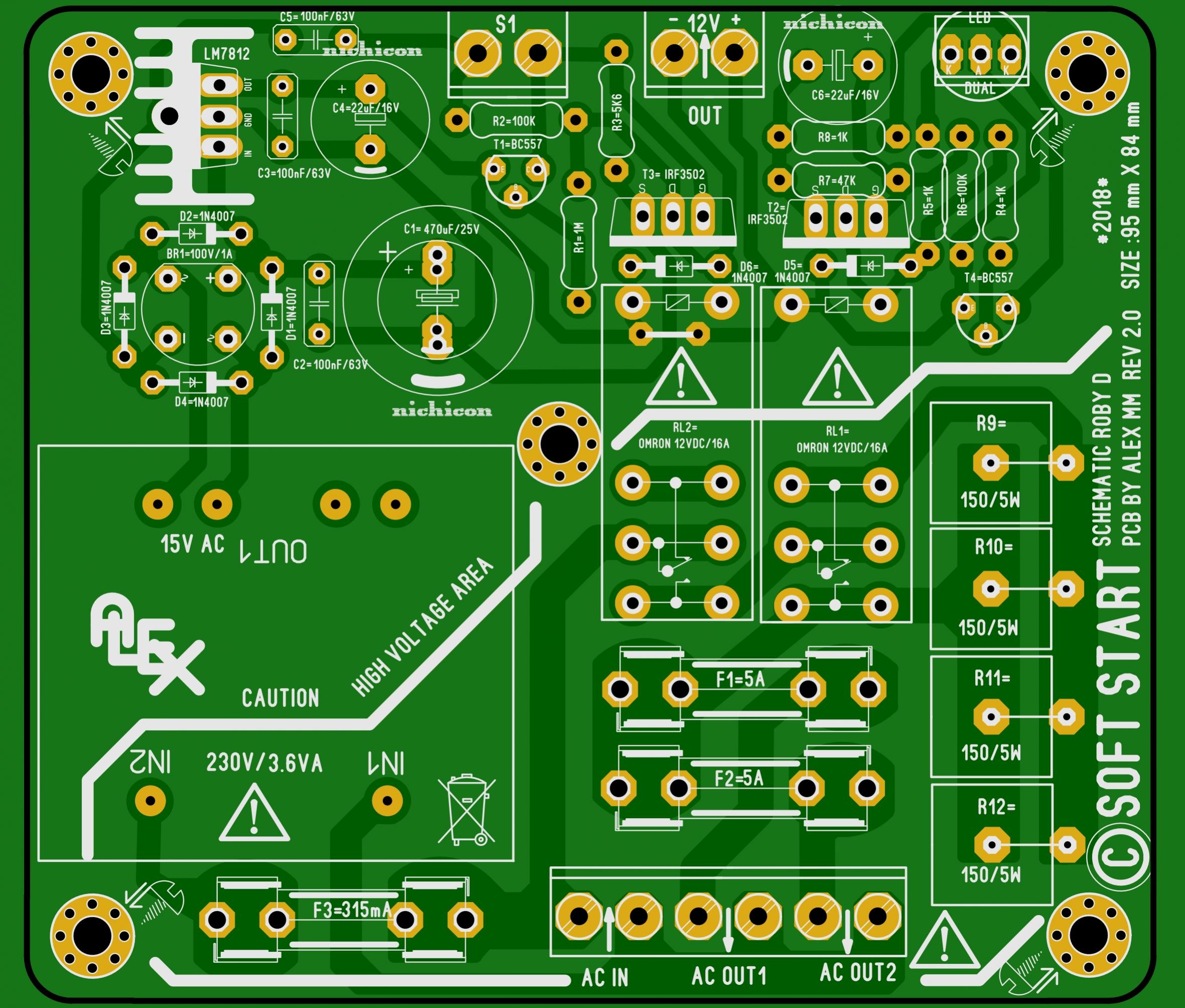

PCB rev.2
And another PCB with schematic changed a bit .:)
Alex

Thanks for comments...i designed schematic and PCB design was from viktor_1986 that have done very nice design (V1.0)...and PCB designer for (V2.0) was alex_mm know for master of design of PCB...version 2.0 is much better that 1.0 because it have AUX 12VDC for speaker protection, fan control etc...
