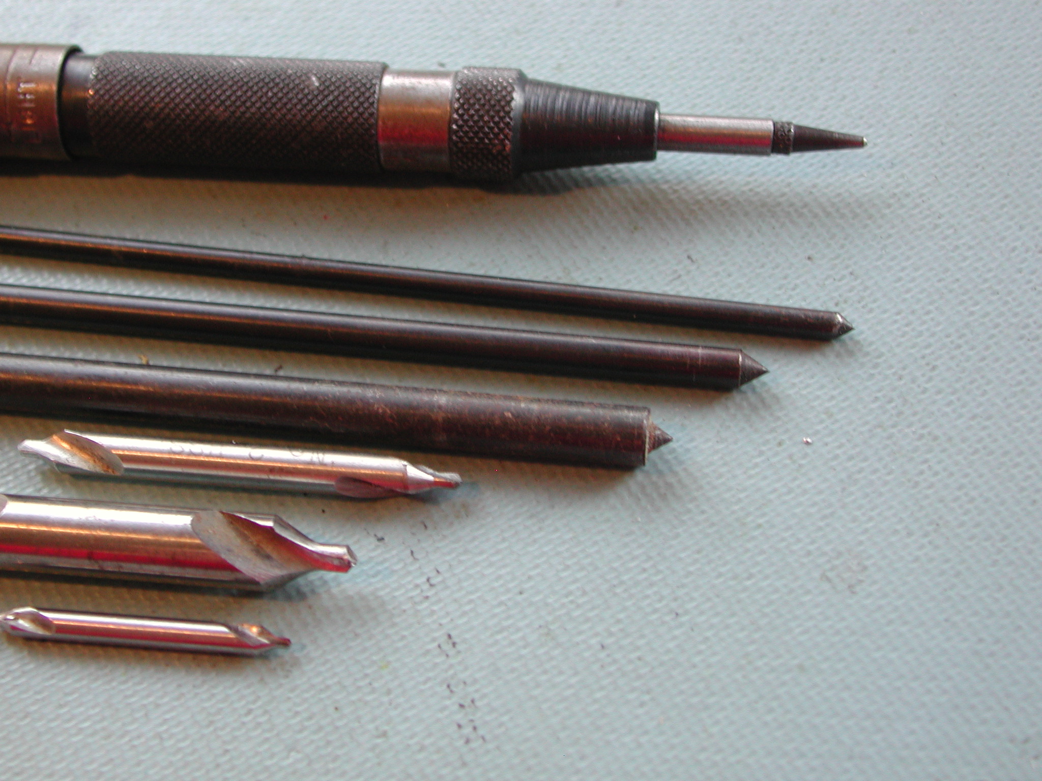

Here are a few of my weapons of choice.....
The three on the bottom left are centering drill bits, they are stiffer than a groom's pr#ck and won't walk. These are a couple of bucks each from McMaster or elsewhere. Double-ended for twice the life. Use these for making your pilot hole; they even provide a countersink for your final bit size to find it's happy place.
The three in the middle are transfer punches, allowing a hole pattern to be accurately transferred from one piece to another with the punch mark in the center of every hole. These come in sets of about 25 pieces and the ones shown are either Harbor Freight or Enco; about $10/set.
And, last but not least, an automatic center punch. I have three of these, two Generals and a Starrett. Generals are available at Home depot for around $15 and the Starrett is at least double that. I have found over the years that the cheaper ones can be a pain when the spring won't fire, that's why I sprung for a Starrett.

So, preferred center punch style: auto or hammer & pin? It could be an unskilled craftsman blaming the tool here but I'm finding that using an auto punch doesn't seem as consistently precise as the hammer & pin method.
I think the last time I used the manual method, I had a rotary phone.......
The general punches I have are two different sizes, with the small one being more accurate. The Starrett is the most accurate IMO. Dialing in the spring force may help with staying on the mark and sizing your divot appropriately.

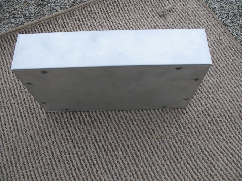

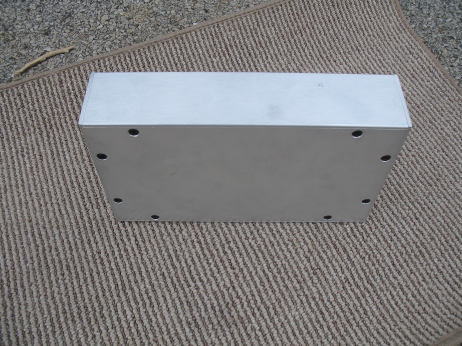

You won't need it, but we can supply just about anything you want for the top plate. The down side to a thicker plate is that it will stick up above the sides. Though we could probably mill a recess if you MUST have it.
We've updated the picture of the 17 x 12 on our site. It now has Saer standing on it. He's the heavy one at 170 :eek:. We have a 6 x 10 that we call "the brick." We plan to park his truck on it and see what happens. Just haven't got around to that yet.
