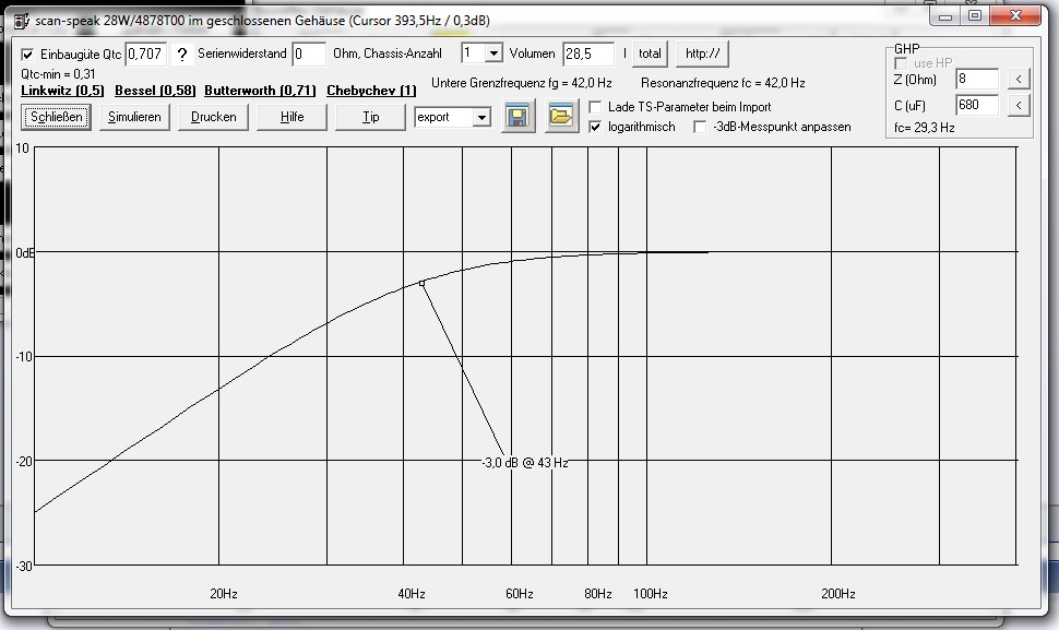

Very interesting is, besides the BR enclosure, it's excellent for a sealed enclosure! In only 28l it goes down (-3) to 43Hz, -8dB at 28Hz! That makes it an excellent choice for fans of closed subs.

I have to say, that is a most awesome combination. Essentially, this sub could be flat to sub-sonic levels in the right room, with a 1 ft3 enclosure. An apartment dweller's dream.

Especally because with a that high Xmax it's still able to deliver quite high SPLs. The impedance of 4 Ohm is also excellent to get higher power output from amplifiers.
