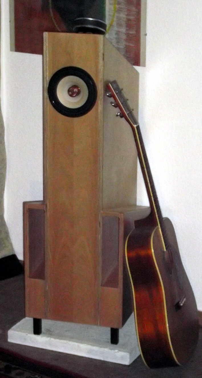

Hello !
As i did not find any info or listening experience on the Satori MR16P-4,
i want to share here i built a pair of 19 liter br with the Satori as a FR Speaker.
Like it very much !
Powering it with a EL 509 amp 9 Watt.

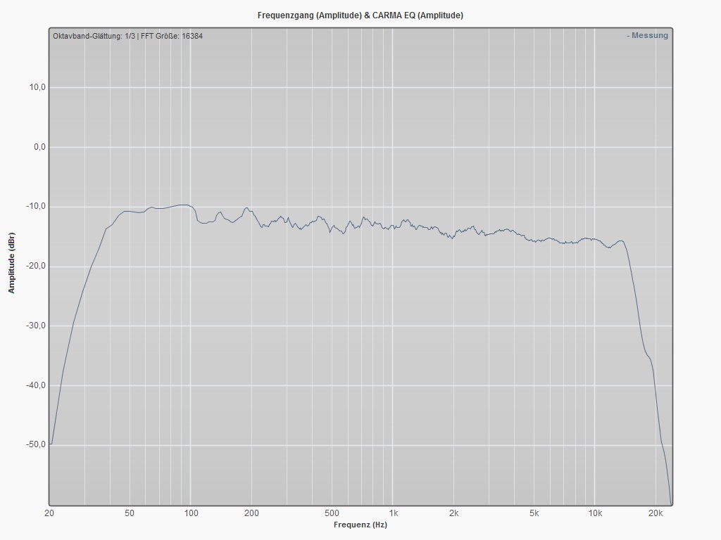

Using an impedance correction network
and a mini dsp for bending (also) the room.
cheers,
Alex.

I imagine the mids are fantastic. How is the sound signature above say 2khz? Is there a paper treble coloration or anything at all disagreeable?
For my ear it sounds very smooth. Maybee a little sensitive in the 10Khz region but tonal very relaxed. Natural feeling. Things i missed on my fostex.
I spent some time on the impedance correction network, that is also a kind of output transformer correction.
And also use mini dsp for room correction.
cheers Alex.
