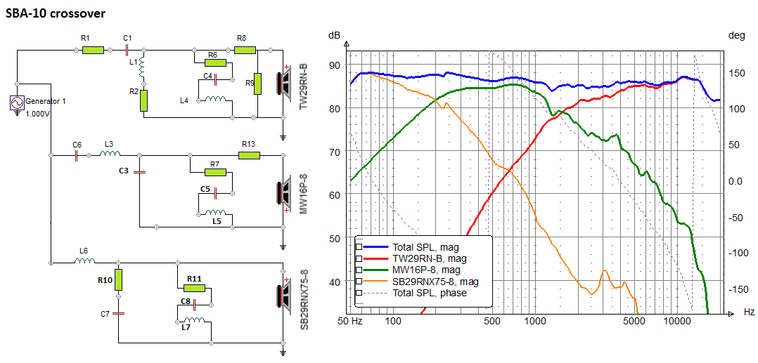

I think you can. You can measure and put the resulting graphs into something like xsim and see what happens when you play, or you can play with eq on the computer and see that you want say 3db down at 1k and 5db down at 12 k, then again you can play. That is how I tune my speakers to the room. Ttoels designs are his best effort to fit any room, and will always be a poor compromise on what can be achieved.
Let's scrutinize that measurements to see where we're at.
If you look at 200Hz level and lower it's about 2dB hotter than 400Hz-1200Hz. In return, 400-1200Hz is also about 2dB hotter than 1200 and beyond.
What does this means ?
Since lower in frequency we go, we get less directivity untill the sound becomes omni, this means that the level of lower frequencies doesn't fall off axis as fast as it happens to higher frequencies. This makes 200Hz and lower to remain loud and becomes louder in regard to higher frequencies as you go off axis. That's where so much bass comes from. Midrange directivity is not constant also and it also falls off slower at lower frequencies in regard to higher. Same applies for the tweeter. All this leads to bass heavy, dark sound.
Now, you'd think that TG doesn't know what he's doing, right ? Wrong. It's not what he does but more where he does it. In Scandinavia wooden houses are quite usual, while in East Europe they are almost exclusively made out of brick and/or cinder block.
This kind of voicing is usual for lossy wooden walls that flex and absorb much of that energy down low or for a very large listening room. Put this speaker in a classic British or East Europen house/apartment made out of hard materials and add few walls in close proximity to the speakers and it will be mayhem with bass.
For frequency response that suites smaller rooms (under 30 sqm) made out of hard materials one should turn to Kef voicing. Not letting the woofer dig much lower than 35Hz is preferable. If you have really good listening room or just can afford to place the loudspeaker where ever you want in the room, then full 6dB baffle step design is the most you can afford to do, usually it gets to about 4dB. Troels did 8dB baffle step here and it shows on measurements and in listening also.
Looking at this measurement i could bet that Troels listened and tweaked this speakers in house with drywalls or wooden walls.

EXACTLY my thoughts!!! Thats why I'm listening with my bass port partially stuffed/sealed. Also when I was experimenting with DSP EQ I found out that even as little as 0.5 db attenuation is very notable i suppose due to room gain multiplier... So my plan is to try simple L pad on bass.
In my case, Troels was well responding until I have asked him what could be wrong with the tonal balance I had where he only suggested that I simply needed more damping material like carpets in my listening room. I already have carpet and furniture in my room. I have other speakers so I know something is wrong in the levels of mid/ low high frequency range. In my case, my issue is not fine tuning but more serious. I had my friend to come over and he has ATS-4 (also from
Troels ). He confirmed the too much amphasis on the mid/hi frequency range with music having higher energy in that range for my SBA-10. However, Troels indicated that voicing is done in the design and both ATS-4 and SBA-10 should have the same tonal balance response....
I have listened to Bassivus played audio files and they seem well reproduced. However, I would be curious that he compares with music having more energy in the mid/low hi frequency range at higher audio level...just to verify if I did something wrong in the build or the result is as designed. I have built the crossover using the Jantzen kit with detailed instructions, following reverse polarity for the mid driver, ...
In order to have a more enjoyable tonal balance I had to add a considerable resistor value in series with R1....but I know it is only a rough patch and can bring other imbalance...like reducing corner frequency of the tweeter even further down...
I am even wondering if some parts delivered by Jantzen are not in spec ...or there are variation in the manufacturing process of the tweeter so mine have greater sensitivity or higher gain in the low end...
I am even considering changing the mid/hi crossover with help from a friend since I have no experience in that area.
Any hint?

in your case i would consider another detailed check on the wiring of XO. If it turns out ok I would try putting damping material with masking tape on the baffle edges of upper part and maybe even pillow behind that "empty" baffle part and have a listen.
Padding down the woofer passively is not a good idea. Why not reduce the attenuation of the mid/tweet section?
tried it... sounded awful! At least on tweeter. I have reduced attenuation on mid slightly. You would'n believe how much room plays role in bass gain. when I was playng with placement in one place I had 20db peak on 65hz and just 10 cm from there almost flat
Yeah, another swamp of the passive xover, level matching is not easy often.
In the end I'm planning attenuating with L-Pad for less then 1db also improved the lowest point on impedance curve slightly. There are other problems there but I can not discuss it openly since I was more than once reminded that I must keep the XO values confidential
However TG openhanded accepted my remark that R11 on bass is heavily underrated and said he will change it to 4 resistors in parallel in future kits... I burned my finger on it after playing slow sine sweeps on bass...
L-pad on woofer, though feasible, is not particularly good idea. If i'd make some atenuation of that sort, i'd probably use series woofer coil for it. Rdc can be anything from 0.25-1 ohm. Any larger value than that and i'd do biamping.
I tried 4 ohm series coil for a specific subwoofer aplication some 10 years ago. It worked without a problem but the coil got warm (not hot) when playing really loud. You'd need heck of a resistors to make an L-pad that would be immune to that. Not to mention the decadency of spending so much power on fancy heater
Changing series rdc in front of woofer will affect the Q of the speaker but since you are using it sealed, it is negligible.
The smartest thing would be, in my opinion, to totally redesign the crossover or to use biamping: woofer on one amp, mid-hi on another with the existing crossover.
