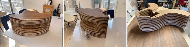

@ richluvsound do you have any detailed photos of your build? Where did you find the plans for your clone? I'm looking for the specs in order to build an optimized woofer cabinet for my 1601a woofs.
marco_gea If you have any detailed plans I would love to see them.
Thanks to you both for all of the info!

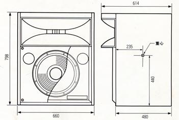

Larry, I've been looking for a while. Seems like information is scarce on these things and also Augspurgers. On a long shot I sent an email to Kinoshita san in Japan but never heard back. If you are successful in finding anything out I'd like to know.
This is the only thing I've found. All it provides is outer dimensions. It doesn't show the internal bracing.

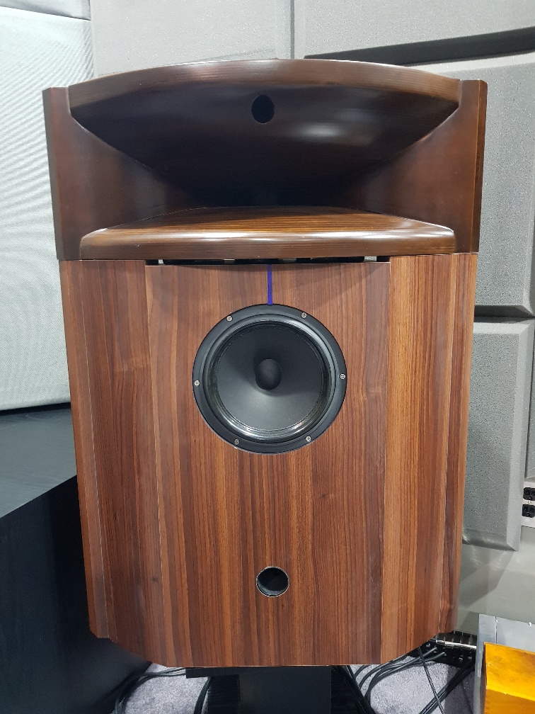

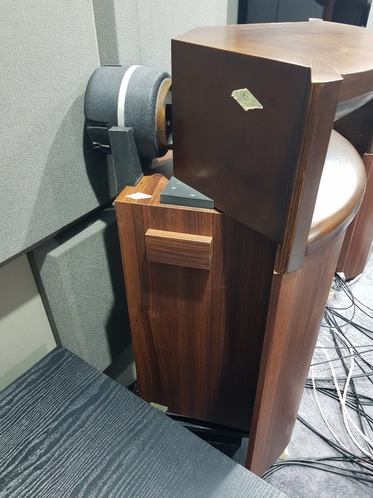

Halo Everyone,
I have finished my system using TAD 4003 with Scanspeak ellipticor for midrange (photo attached).
My next goal is to use all TAD drivers.
I want to make clone 2404 with TAD 4003 (/w original horn replica) and TAD 1601b. I will put the horn in top of the woofer cabinet not inside.
Crossover will be active in DSP. 1601b: 50hz - 650hz, TAD 4003: 650hz -20khz. 10hz -60hz: separate subwoofer.
Can someone help me with the woofer cabinet inner size after bracing and glasswool material? Also port hole and length. I dont know how to calculate them. Please can you help?
Last question : will power amp of 140watt@8ohm enough to drive 1601b?
Thank you so much!
Best,
Daniel

At 97.5 dB efficiency 140 watts will be more than you need, unless you are using it in a huge room!
Also, glass fiber insulation is not only unpleasant to work with it is downright dangerous if you inhale the fibers. Do a search and you'll find posts recommending recycled cotton fiber batting as an alternative.
Did you make that horn? If so, it's a great replica!
