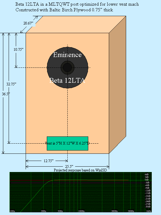

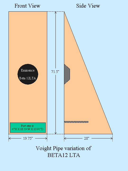

>So is the PiAlign enclosure design a good match for this driver?
All things considered, I believe so, or I wouldn't have recommended it.

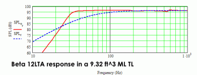

>I am looking to get down to 45Hz or so since the Fs of the driver is 45Hz.

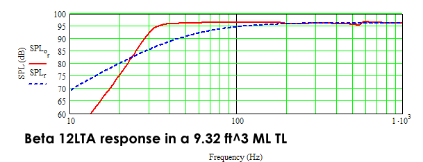

Well, as I noted, the Pi Align is tuned to ~33Hz, so it meets this criteria, though in a sim it looks much less efficient down low than a much bigger cab until you factor in the driver's very low linear excursion (Xmax).

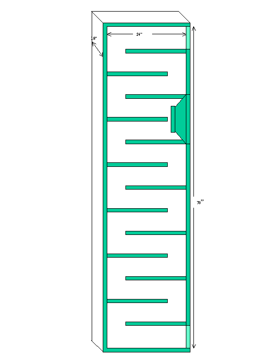

If you can accept whatever audible distortion there is at 2*Xmax and whatever SPL it makes at 10W max , then a ~5ft^3 cab tuned to ~27Hz yields a ~45Hz F3.
>Is my driver 2/3 of the way down the pipe nuts or is there a chance it might work out?
Dunno, what does MJK's TL worksheet predict?

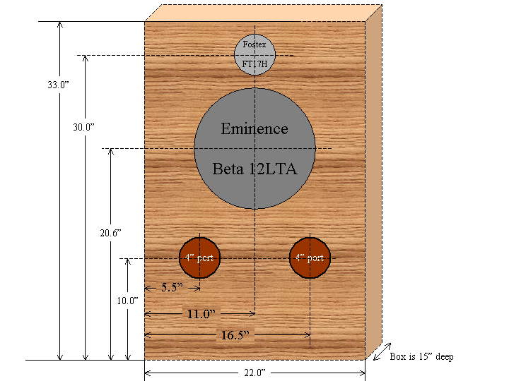

20.6" up from the floor puts them at ear height?! I take it there's something involved to space them up off the floor.

Sorry GM, I didn't make myself clear enough. If I was building an open baffle with an Eminence driver and a tweeter, I would use a coax type. I didn't use that combo in my case because I already had the Goodmans 201.s.
I presume that you are referring to the polystyrene baffles which were mounted on particle board. They have now been replaced by the panels with the glass wings.
My tweeter crosses over at around 10K.
Cabinet Dimensions

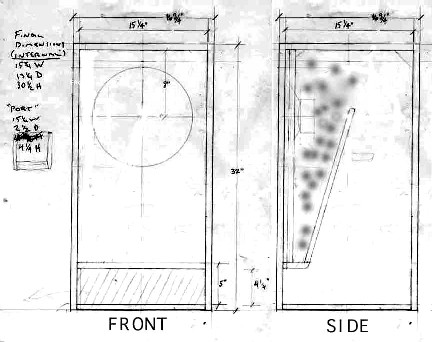

Here is an alternate cabinet design to assure the driver is in a more correct position. Parts are all here the 300B amp is complete. Just placed a pair of Mundorf caps on order for the amp. Crossover for Speaker will be assembled with Solen caps 1st. If I am happy with the sound then better caps later.
