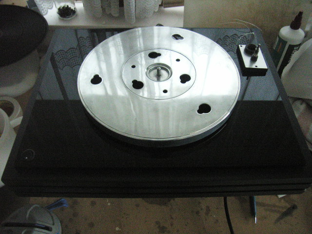

By this stage I couldn't hold myself back, everything had to finished, so I quickly recleaned the sub platter and platter and wacked them on........................:smash:
And I know the Tone arm is no where near ready to go on, I couldn't wait any longer, so off came the perpex protection sheet.

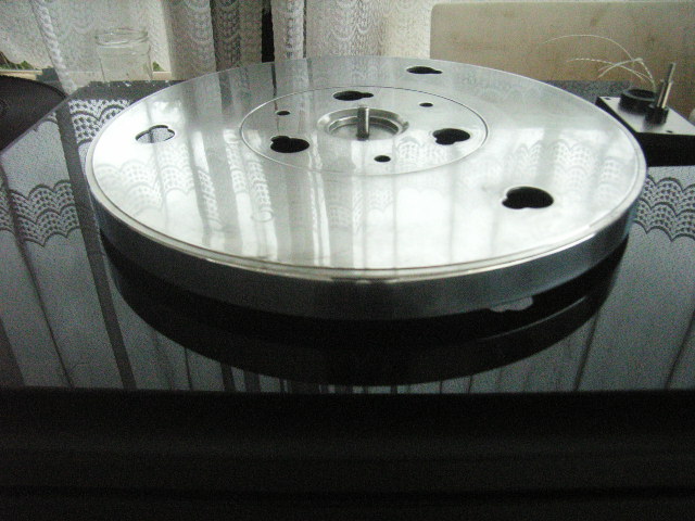

Spinning
The platter spins nicely and is very quiet.............

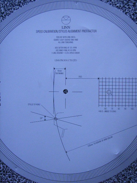

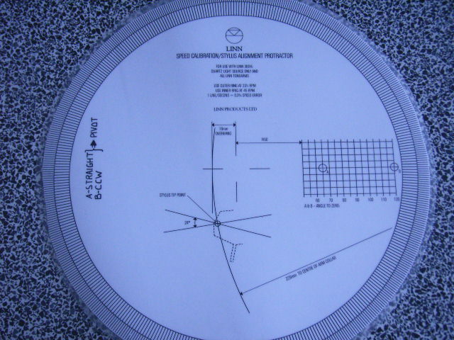

Thanks to Alan, a fellow member from Auckland. He lent me his Lynn Alignment protractor. I haven't been able to start on this part yet as I was sick for 2 weeks.

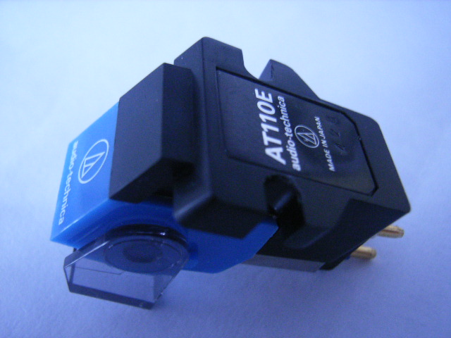

Question. I will be using a cartridge off my Dual. It's an Audio Technica 110E. But the mounts are at the top as apposed to the really old and totally munted Sure.
Can you get new screws for the Head shell, as I'm going to have to cut these down so I can screw them into the head shell, at the moment they are far too long.
screws used to be available in a range of lengths. Maybe more difficult to source now that vinyl is less popular.
The really hard steel used in a 12.9 cap screw will not be easy to cut/file/saw. And when you have managed to saw it using the incorrect technique your saw will be useless for the second screw.
Then you have to file and/or grind the damaged end to allow the nut to fit well. A thread file will not look at 12.9, if you can find one with a fine enough matching pitch.
I don't know if they are metric or imperial, but 2.5mm does fit.
The problem then is finding a wholesaler willing to sell two of each length.
if screw' aren't too heavy in original length,just place nuts on top of HS and screws from bottom ...ie-upside down.
in fact-that's correct way of mounting
some cartridges have tapped blind holes in the top for mounting purposes.
One must be very careful to ensure that the securing bolts/screws do not bottom in the holes when tightening. The risk of damaging the plastic casing is quite high if bolts/screws are too long.
Some cartridge manufacturers supply suitable/unsuitables fixings. Most arm manufacturers supply a range of fixing lengths.
