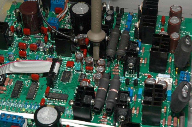

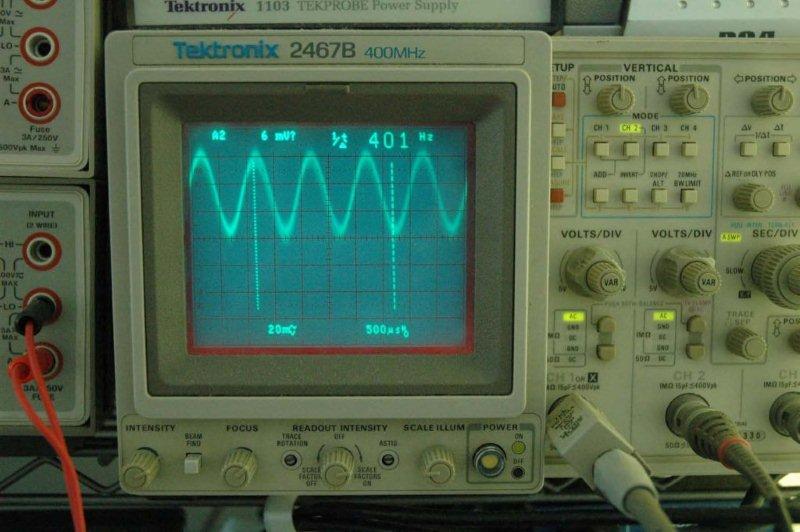

I have two pictures to show how I take the measurement of the voltage Vpp at the output pin of the PCM1794A. It is about 60mVpp with Ipp 7.8mA and thus giving an impedance of 7.8 ohm. Minus the 4R99 in series at I/V input and thus the input impedance is about 2.8 ohm at the BJT I/V. Note that the noise at the PCM1794A Iout pin is not that much as the scope bandwidth is set to 400MHz.
Hi Spencer
I am assuming you are asserting that a lower impedance value is better. If that is the case, why not take the series resistor out completely?
Best wishes
TC

Chris,
I inject 0dBFS 1kHz digital signal to the SPDIF input from my AP and check the waveform at pin 3 of PCM1794A and you will see 60mVp-p signal as shown on scope. If you prob the input of the Jfet I/V (after 4.99ohm resistor), the wave form become about 20mV. So the current across the 4.99 ohm is about 40mA/4.99ohm or 8mA peak to peak.
I also check the waveform at the 472 I/V resistor and it is about 3.8Vp-p. So it confirm the 8mAp-p current again.
Let me know if you have other questions or measurement that you want to know.

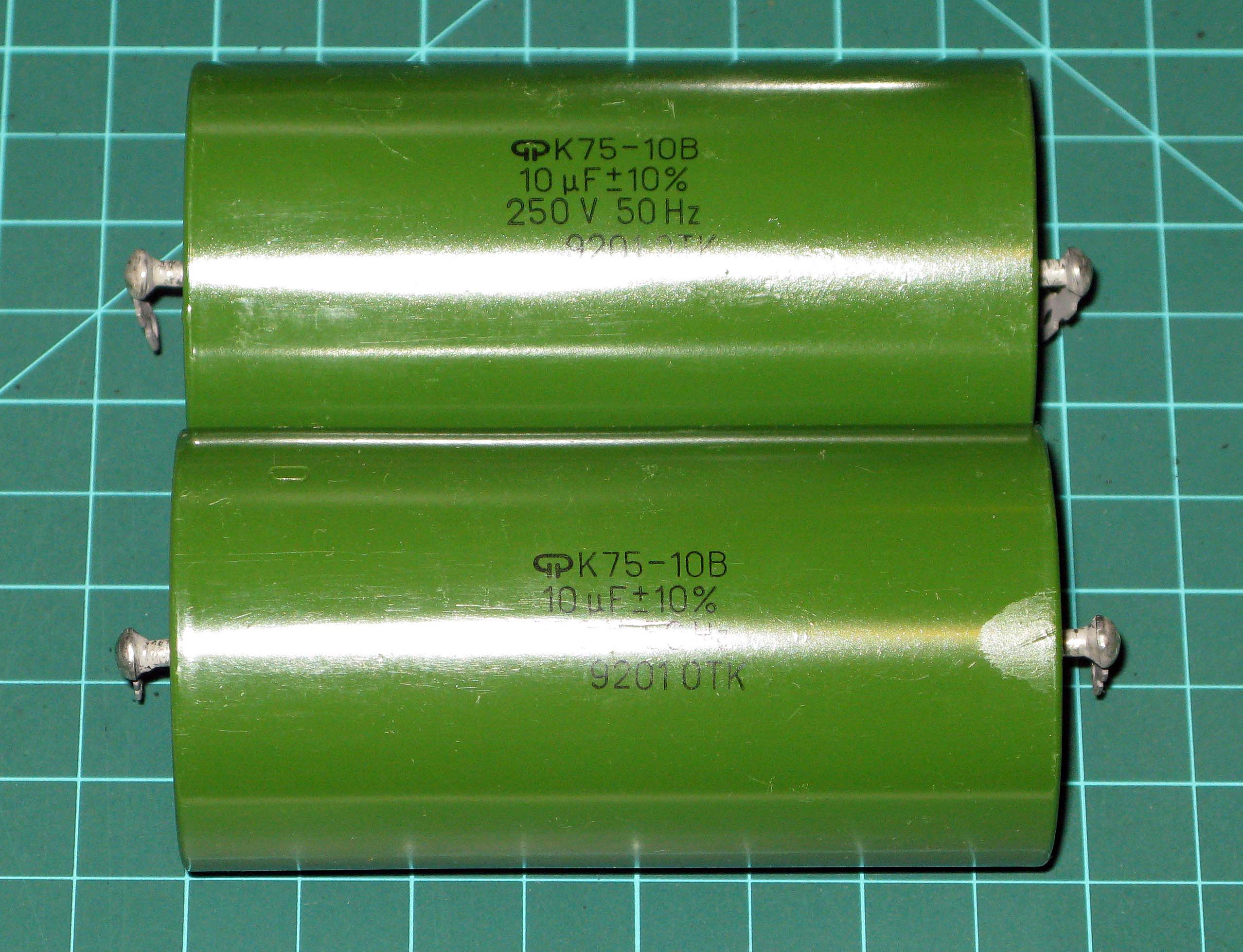

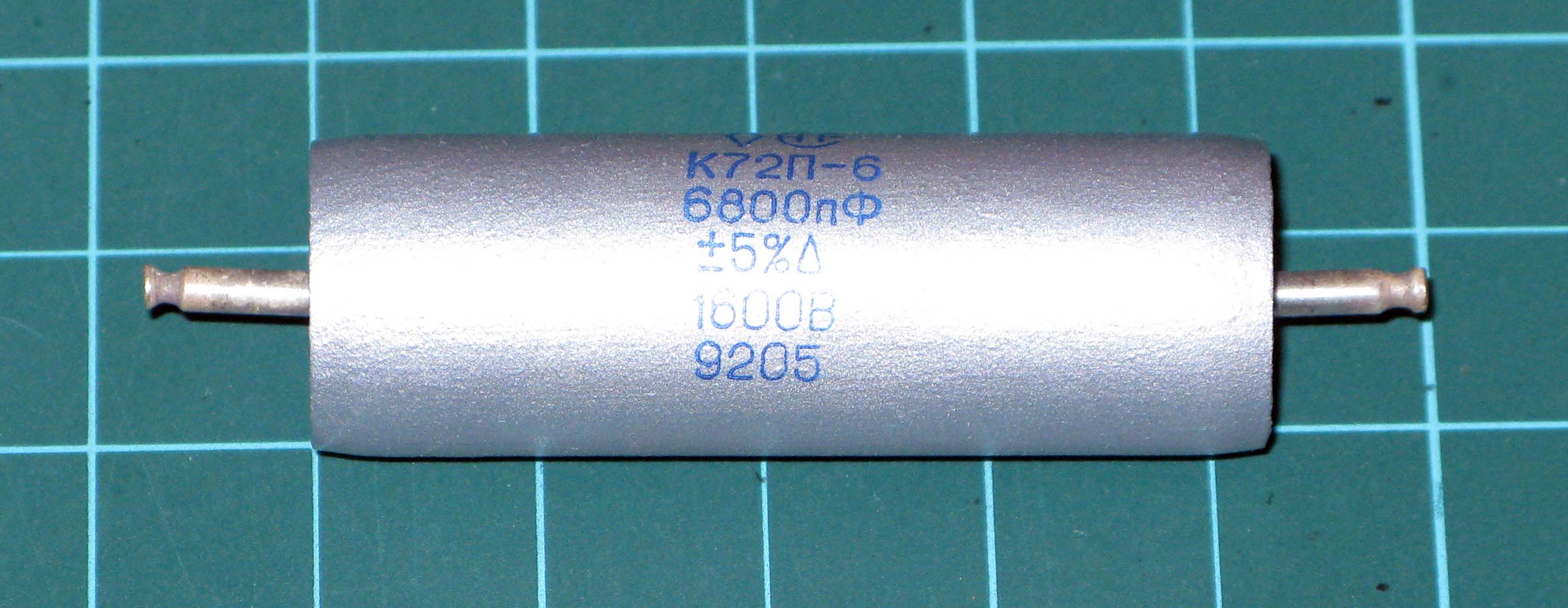

Big Caps!
Hi
Look what the Postman brought today!
I will be replacing the 8 6800pf caps with these 1600V Teflon ones ….whoa!! Yes 1600V – crazy, I know. I will also be trying out the monster K75-10’s too.
I think the Teflons should be very interesting and the K75 is a hybrid PIO - PLIO??
This is going to be an interesting weekend!

Hi TC,
Don't forget that large capacitors are basically antennas that might either pick up or radiate stuff you don't want to know about. That seems to be one of the huge mistakes that are made around the world. If you look carefully at circuits designed for these capacitor types, they are either not at risk for noise pickup (radiation is another matter completely), or they have designed a space for those parts where they are shielded from other signals, or signals that may be radiated from those caps. I'm talking about metal shields or metal enclosed areas in the circuit.
Component selection can be tricky business. Don't forget about the obvious problems either.
In case you are wondering why large capacitors can be a problem, think about one of the two capacitor connections. It is connected to the outer foil, and so acts in the same way that a sheet of copper would the same outer dimensions. Now, if you would never connect a sheet of copper in that location, why would you do the same thing using something that simply looks different?

Bigger Not Better?
Hi Chris
I am aware of the interdependencies and how they can affect sound but I thought the main culprit were the TXs. That was why when mounting the two boards, I was concerned that the TXs were too close and whether using two would add more noise (phase, EMF interaction, etc) as I have no equipment to measure it.
As far as my audible experience goes, I don't believe these biggies have had a negative impact. In fact, the experience has been to the contrary. However, that is not to say there isn't or the designs were optimized to begin with. Maybe I am just not hearing them – selective listening ha ha!!! Perhaps on the bench, the measurements may be worse, and I am sure they will be L.
Anyway, I am glad that you raised this. At least I am more aware of the possible downside. However, as I have them already and they are very easy to install, I shall give them a try anyway ….. Perhaps someday, I will have the ability to measure the impact.

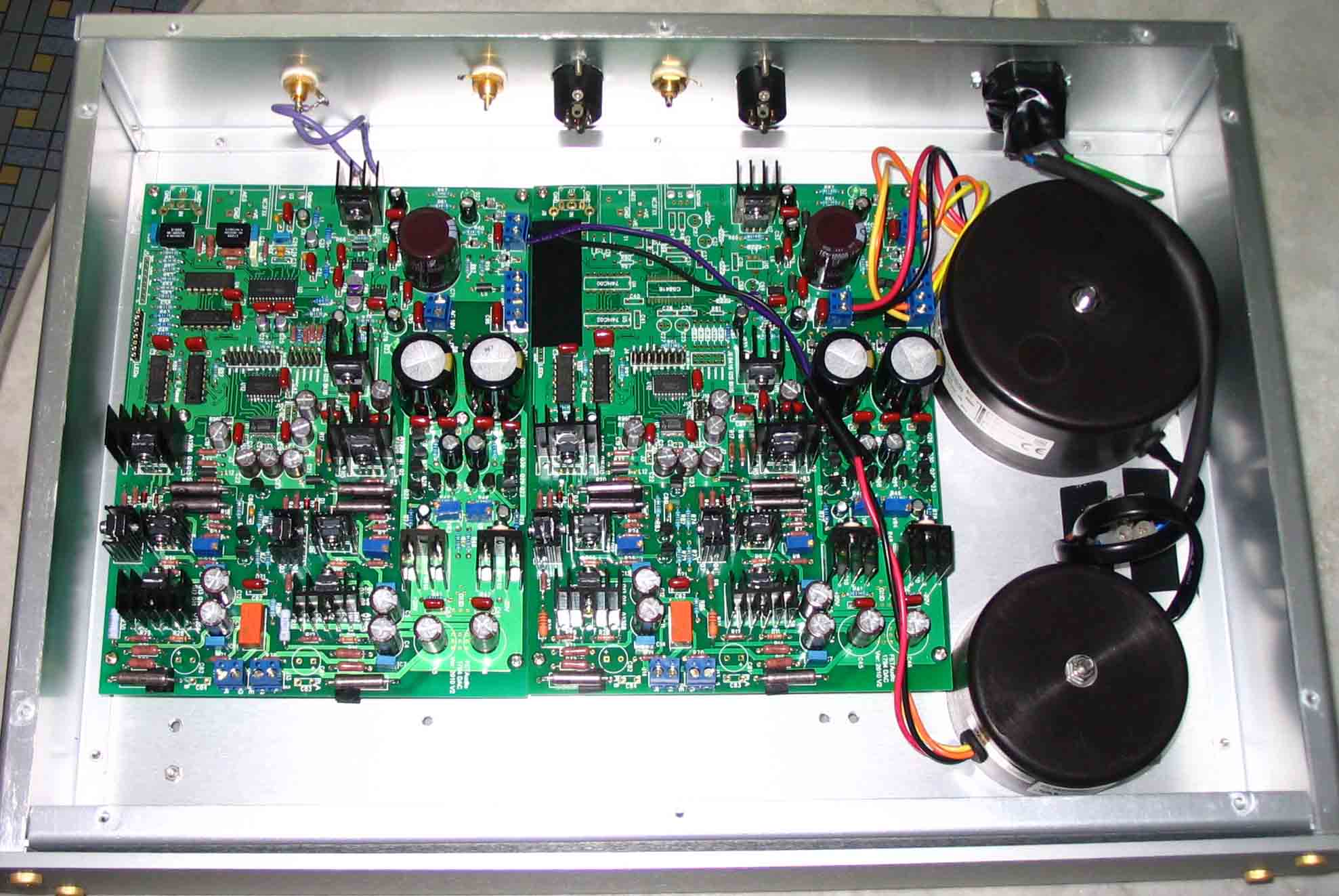

Hi All,
I also got a Balance kit from Spencer. The kit came well packed and marked. I just finished soldering the components (except the output coupling caps) and now looking for some hookup wires. Attached is a photo of the layout, unfortunately there is not much space so the trans (maybe should look for smaller ones, but these were my spares) are very close to the PCB.
Regards
Victor
