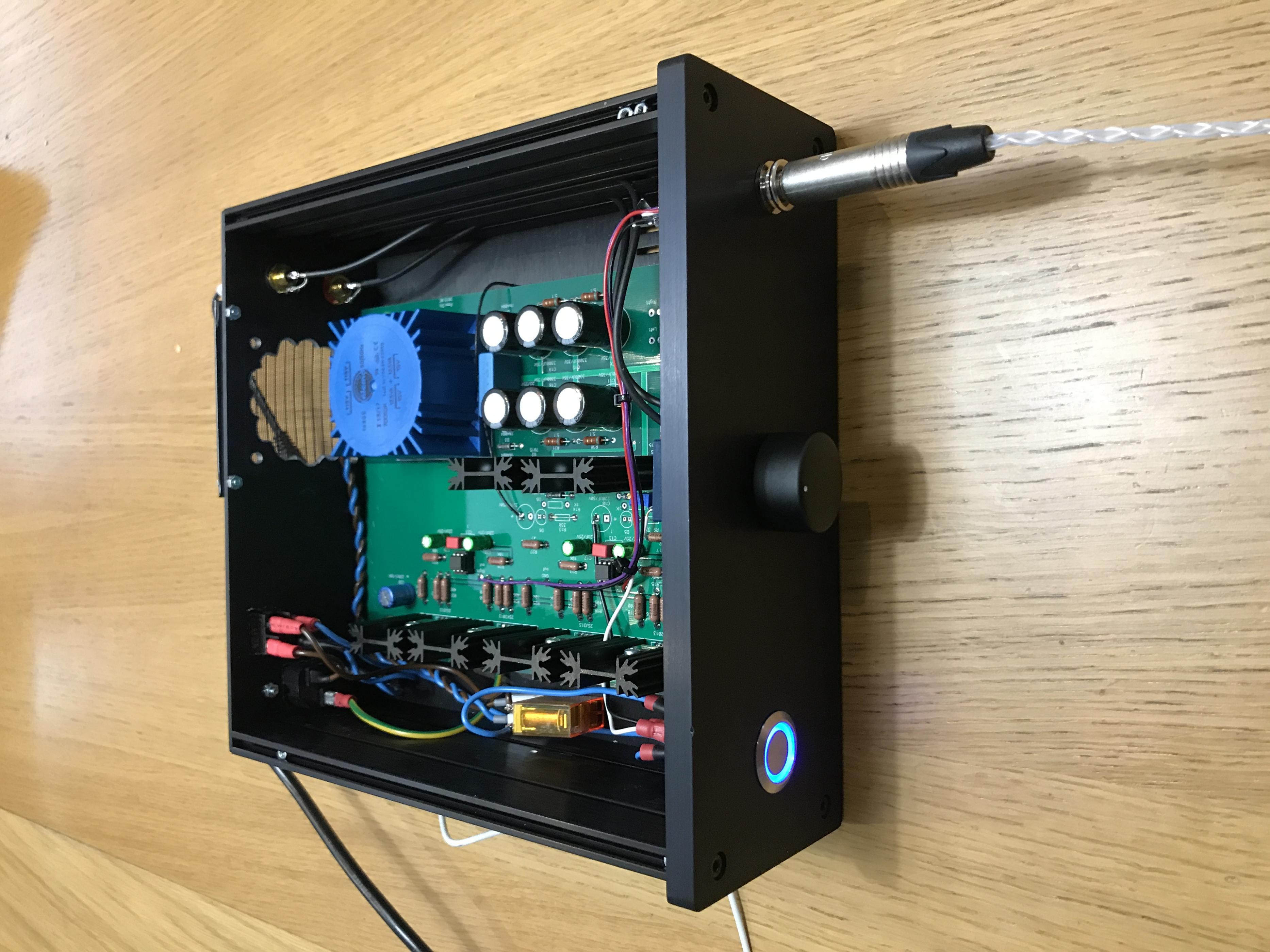

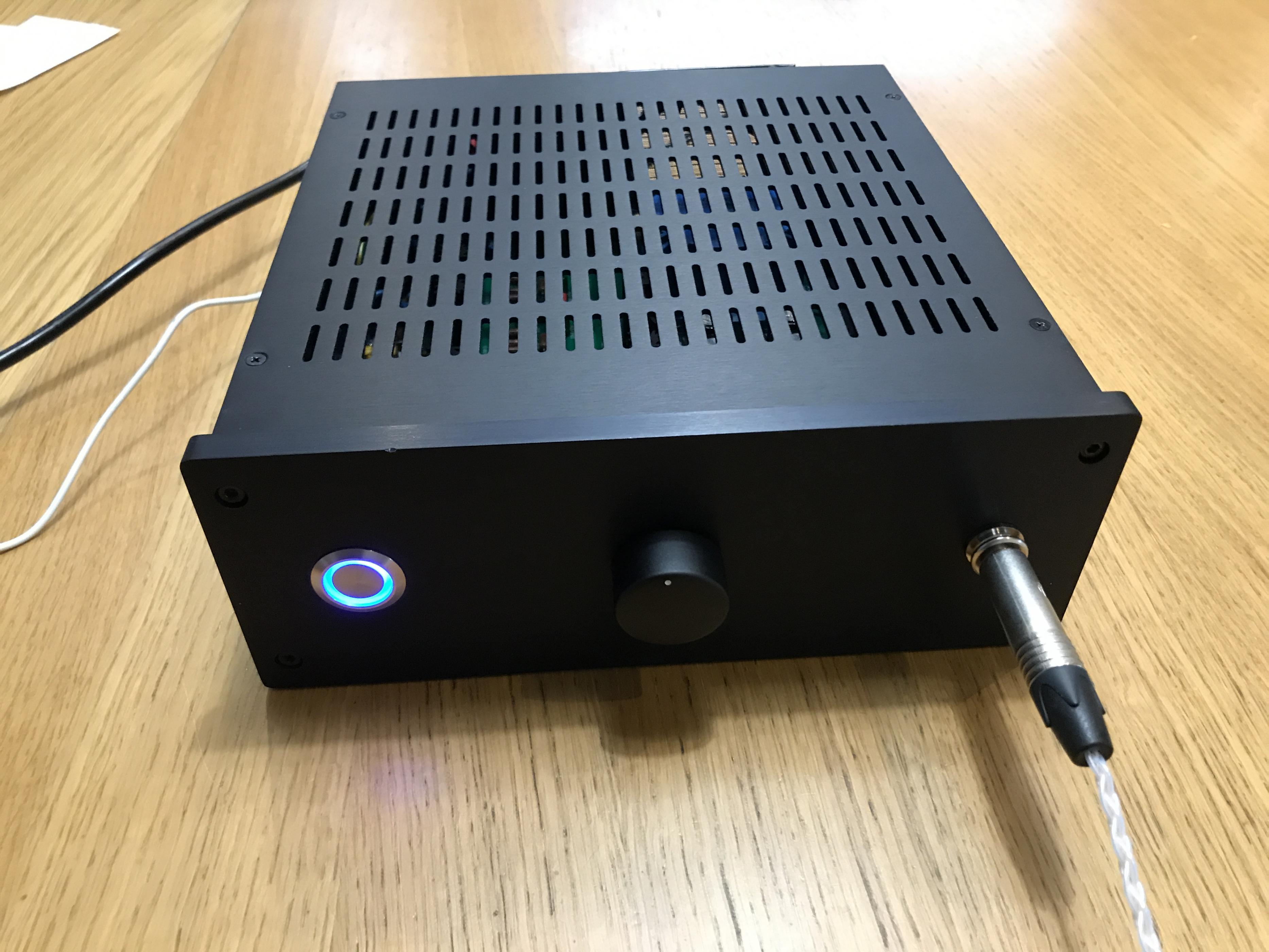

Yay, I got my Pass Diy headphone amp cased up today. Nothing fancy, just an old tube headphone amp case (modushop) being re-used. Only initial listening going on but it sure sounds promising. The build was quite straightforward without any hick-ups. Thanks a lot to Wayne for all the effort!
I'm using Toshiba FETs (liubincalvin), Nichicon/Panasonic caps and Dale RN60 resistors. The opamp is at the moment LM4562, but I have OPA627 and OPA2132 waiting to be tested. The input caps are now basic Mundorf MKPs, but propably they will get upgraded to Evo Oil versions later on.

Oscillation?
Yesterday I tested the OPA627 after trying LM4562, but I had some strange problems with it. On the right channel I could hear a hissing noise, but the left channel was dead silent. Also the left headphone warmed up a bit. When I switched the power off the led ring in my power button dimmed slowly indicating that the voltage from positive rail dropped very slowly. Also the heatsinks for 2SK2013/2SJ313 felt colder than with LM4562 opamp. I used Apple iPod standard plugs for these tests and didn't have the courage to plug in my Audeze's.
After this test I plugged in OPA2132 and everything worked normally. Could it be that I'm suffering from oscillation? My circuit is almost in stock form: I have 2.2k resistors for R4/R8 to lower the gain and I have implemented the optional C2/C7 (Kemet PFR 100pF). Should I perhaps try to remove the C2/C7 caps to make it work with OPA627? Also the input caps C1/C5 are 2.2uF when schematic cals for 1uF, but I suppose this shouldn't matter in this case.
Anyway I think the OPA2132 was a clear improvement and the bass sounded deeper and more controlled. Would be nice to test the expensive OPA627 too. :rolleyes:
Edit: Oh, and I'm using +-15 VDC configuration from the power supply.

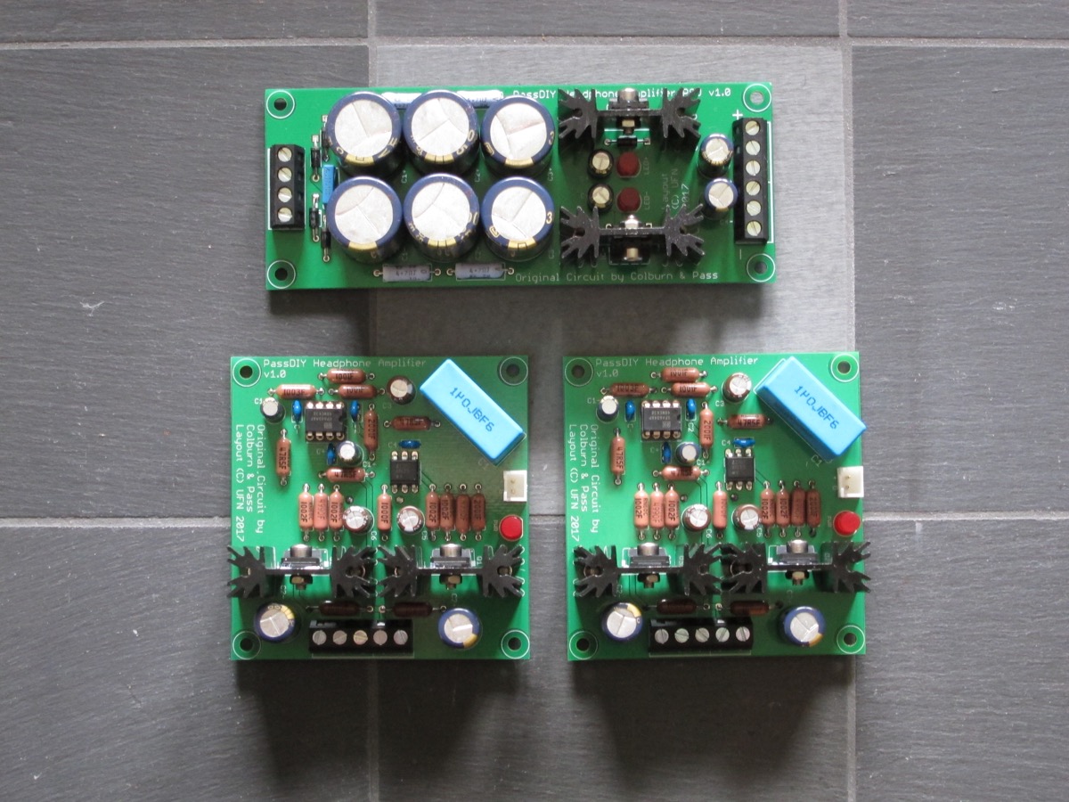

I ordered myself a couple of PCBs with the gerbers posted in #457.
I have a few boards left, if anyone is interested, drop me a PM. Since shipping costs are a major part of the overall cost, this will make the most sense for the European fellow DIYers.
@Wayne, thanks a lot for the ingenuity and effort that you put into this project, and the generosity to share it with the community. Can't wait to hear that one sing!
I considered that approach as well, but in the end I decided to roll my own boards instead:D
Thanks Wayne for the excellent design - I look forward to listening more over the next days/weeks ;)
