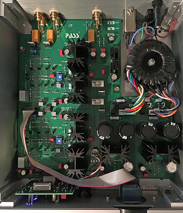

I haven't been able to snag a HP1 yet
That's the one I'm intrigued by as far as the circuit design.
If you haven't been able to get your hands on one yet, it may be a looooong time before we ever see a schematic.
