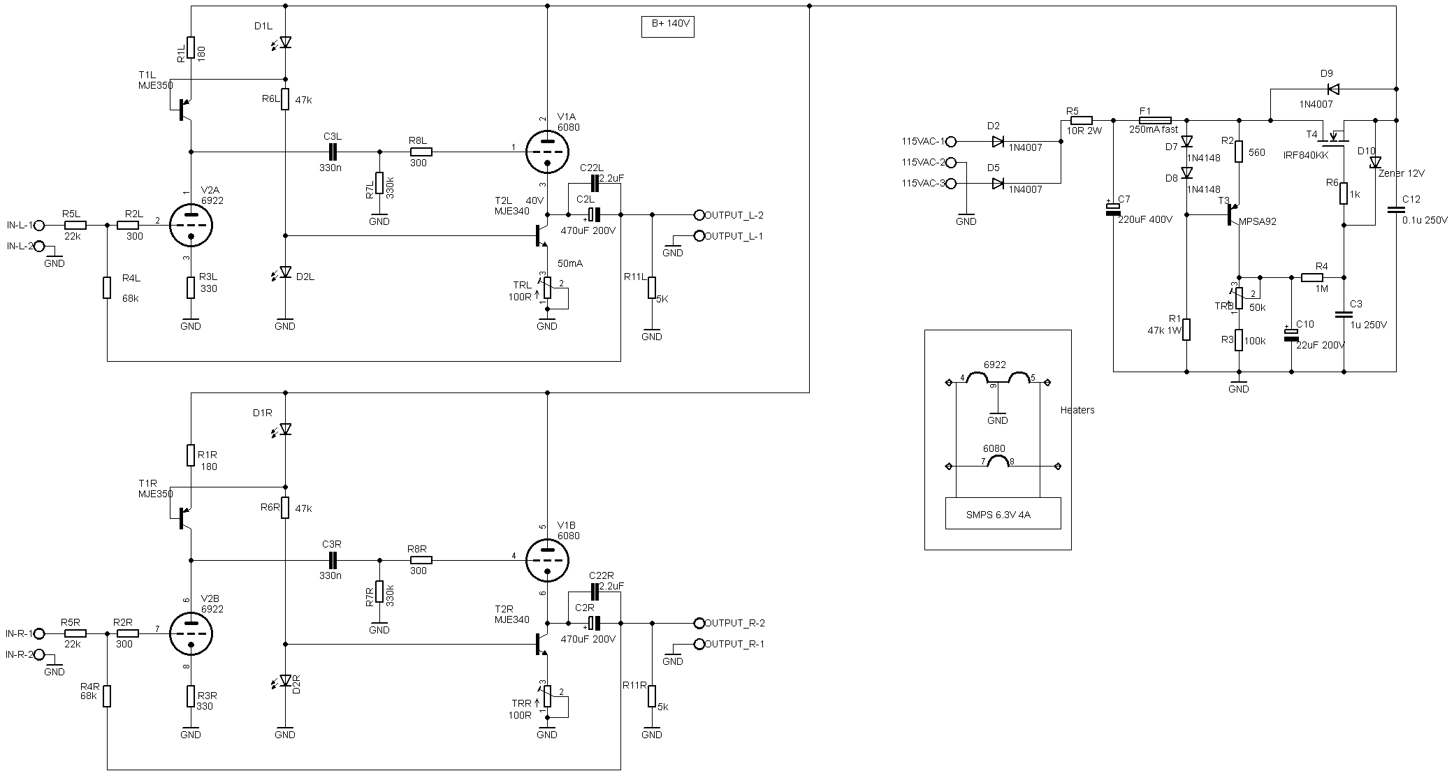

cgraf, What is the purpose of TRA?
It appears to me that it does nothing but set the current through the two diodes, and without an additional limit resistor, can be turned down low enough that you will blow the diodes D7 and D8.
It looks like T3 has it's collector and emitter swapped if it is meant to be a current source with R2 ans the current sense resistor.
You don't need a separated heater supply for V2, the 4A SMPS can do both. I have tested it, there is no difference in sound.
You should add a *good quality* bypass capacitor over C2L and C2R, at least 2µ2. (Mundorf Supreme for example)
Adjust R4 for best sound with your headphones.

Otherwise you need the grids biased above ground (half way between ground and B+).
Easy to do: leave out R7 and C3, replace R1 with 1K multiturn trimmers, and adjust to have 90v at V2 plate.

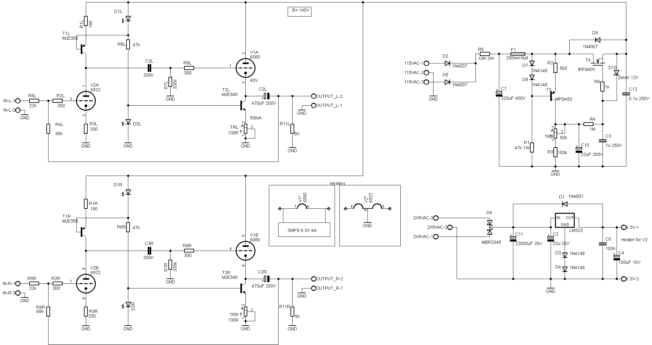

Final Version ?
Updated schematics:
As the opinions differ, I will leave some space on the PCB and will then be able to compare.

Updated schematics:

Your 6080s are biased off unless you use a negative voltage supply for the current source. Otherwise you need the grids biased above ground (half way between ground and B+).
According to datasheet's curves, with 100V across the 6080 and 50ma current draw, Vg is -40V and the CCS has thus 40V to operate with the 6080 input referred to ground, which is way more than enough for the voltage swings into headphones.
You can of course bias the tube at 90V but then watch out for dissipation on the ccs (it goes up by 2.5x).

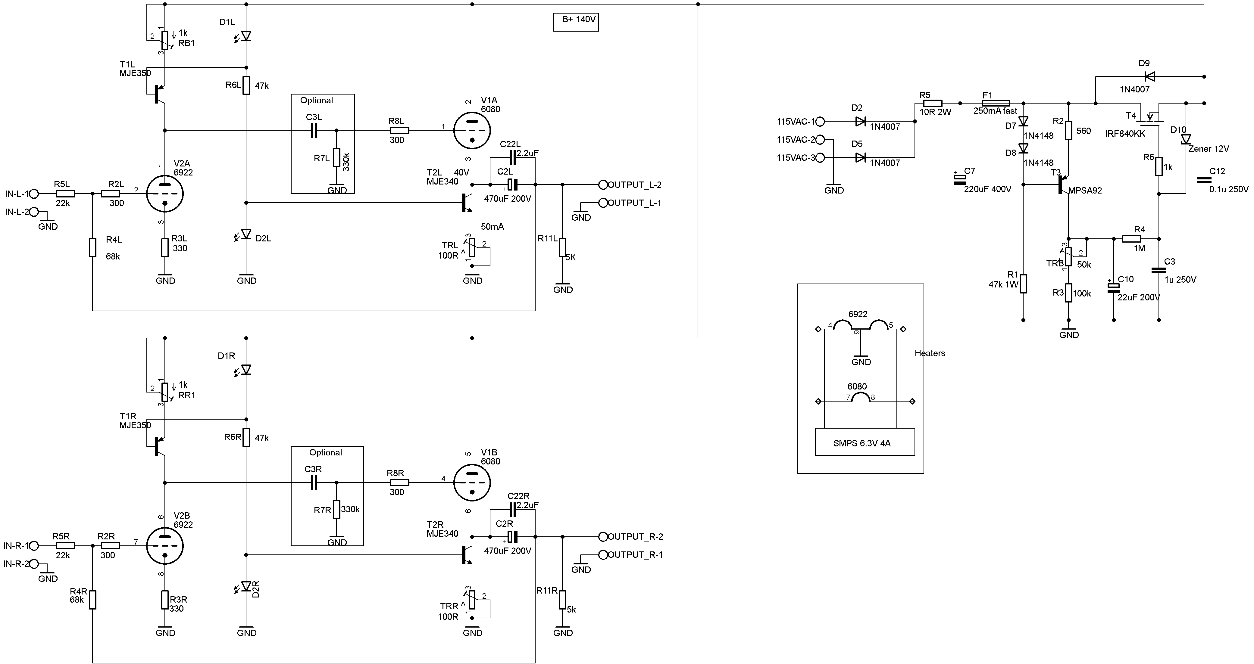

This circuit whilst adding another 6AS7 should do a much better job at driving cans, any can really.
SRPP input stage followed by a WCF output. Z out should be well below 8 ohm.
You can even do away with the bypass cap of the bottom half of the WCF it's only degrading the sound.
Can you explain why we need SRPP to drive the output follower? Why WCF can't be driven by simple common cathode stage?
We can use simple common cathode stage, no need for SRPP. There is no low impedance load which requires SRPP's push pull action. The input stage as shown is not even an SRPP.
