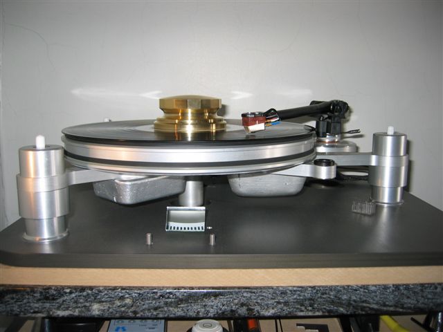

I did modify mine, and you can see the picture in Oracle's Gallery: http://www.oracle-audio.com/show_pi...to_text=Oracle Thales Micha Huber Switzerland

I did the armboard out of brass.

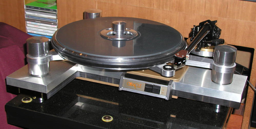

2) Oracle sells directly a new aluminum arm board - the sound is much improved with it.
I did a number of things to the Oracle turntable.
One of the most effective mod is adding diving weights to the chassis. 2x 3 pounds to the left and 1 X 5 pound to the right.
For that Oracle sent me their strongest springs - I believe 2 blue and one black... This mod adds a lot more bass and other benefits I cannot remember.
Another effective and inexpensive mod is adding a marble or granite piece under the original base. This made a HUGE difference. Mind you, I have an aluminum custom made base, then a piece of MDF and then the granite.
Changing the 3 aluminum post to Oracle delrin towers also made a big difference.
The new Oracle platter matt is absolutely phenomenal in the sound improovement department...
