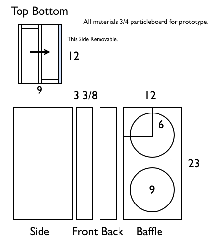

I hope to start construction of the bass boxes this weekend. Here is my current plan for the LF boxes.

Yes, fullrange is not ideal because it will use those frequency portions above the dipole peak. But so are all typical dome tweeter implementation. Not ideal at all, and the resulting polar response is fondly known as the "klingon bird of prey" sonogram.
That's why JohnK developed NaoNote and SL with his recent LX521 and their peculiar looks. Also those dipole nudies in this forum.
Is it audible though? I don't feel they're too much of a problem. The original Orion had been around for more than a decade and no one were complaining. The best way for you I guess is to build one and see/hear.
... Then let us know :)

Do my physical measurements look OK to you? I ended up picking up 3/4" birch ply for the main pieces and 1/2" birch ply for the top and bottom.

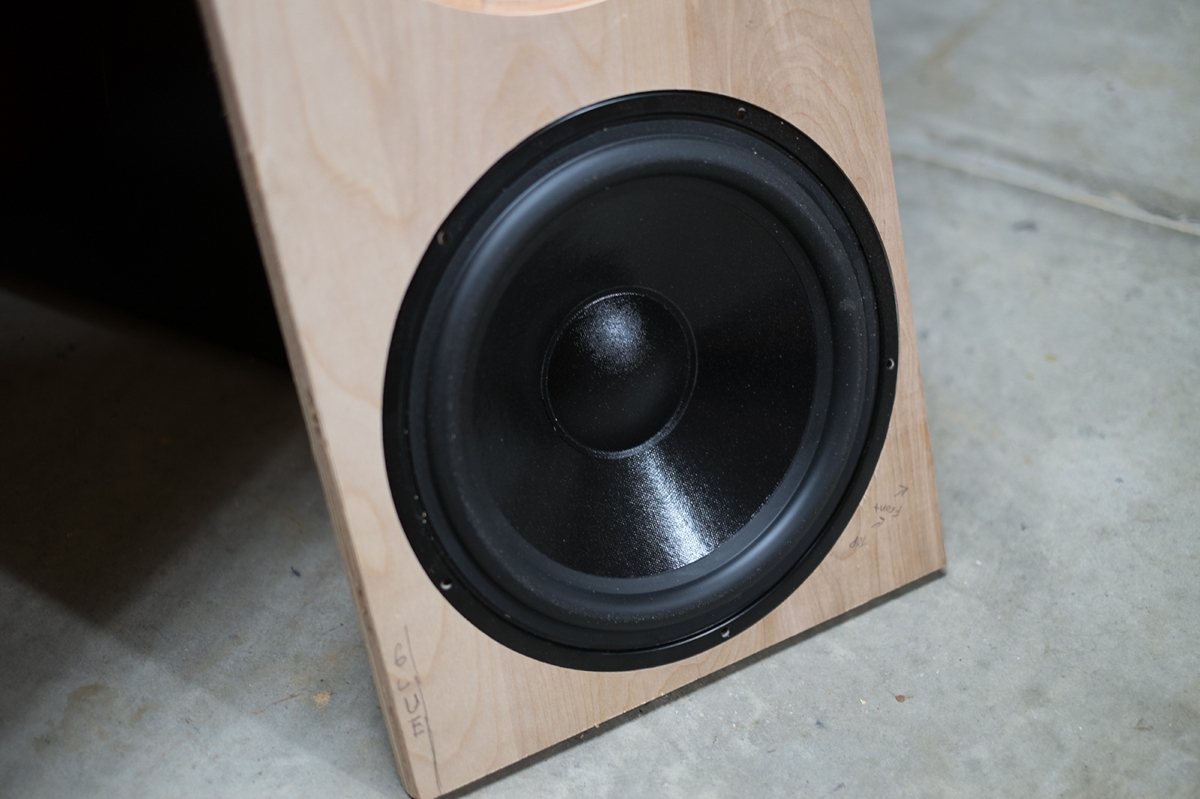

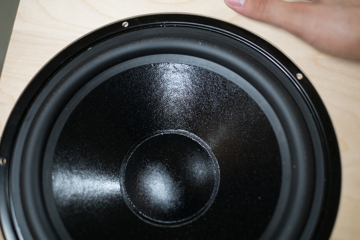

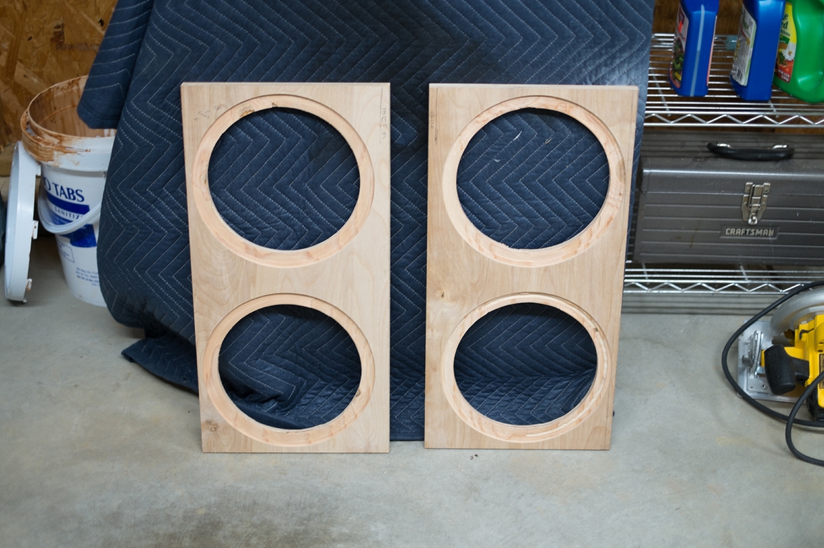

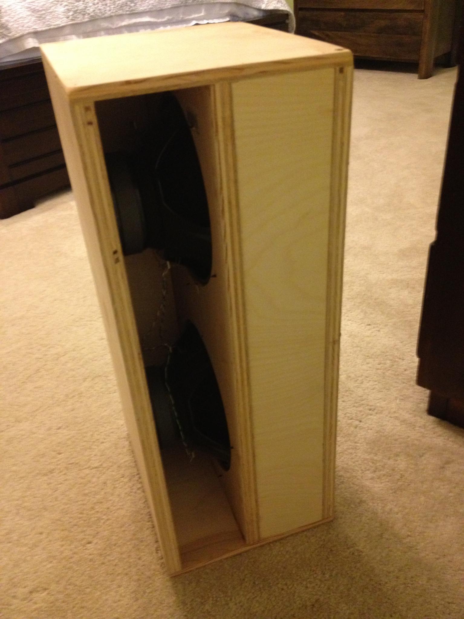

Started construction

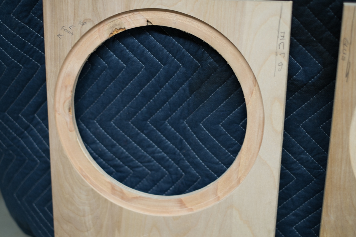

Started construction tonight, had a few hours to work on the speakers. Successfully cut the baffles out and driver holes. Decided on a recess so that the woofers will be flush with the front baffle.
I should be able to make some more good progress tomorrow. Plan is to cut out the rest of the pieces and glue up the front, back, sides and hopefully top and bottom. If all goes well, I should have the unfinished cabs ready by the weekend to wire up and measure.
As you can see the drivers fit nicely. Those Dayton drivers have a really really fat outer baffle dimension to cutout. As you can see I had to cut the circles slightly off center, in order to be able to glue the 1/2" plywood to the backs without clipping the drivers. Because my 2x2 board was actually 23 31/32 and I lose 1/8" with my circular saw blade, I ended up going with 11.75" deep for the baffles. I still plan on being 9" wide in order to keep with the S20z design. The bass boxes will be 24" tall, which is the height of the wood I was able to get at Lowe's (trying to limit the circular saw cuts).
The routing took forever but I think it was worth it to have the flush-mount drivers.

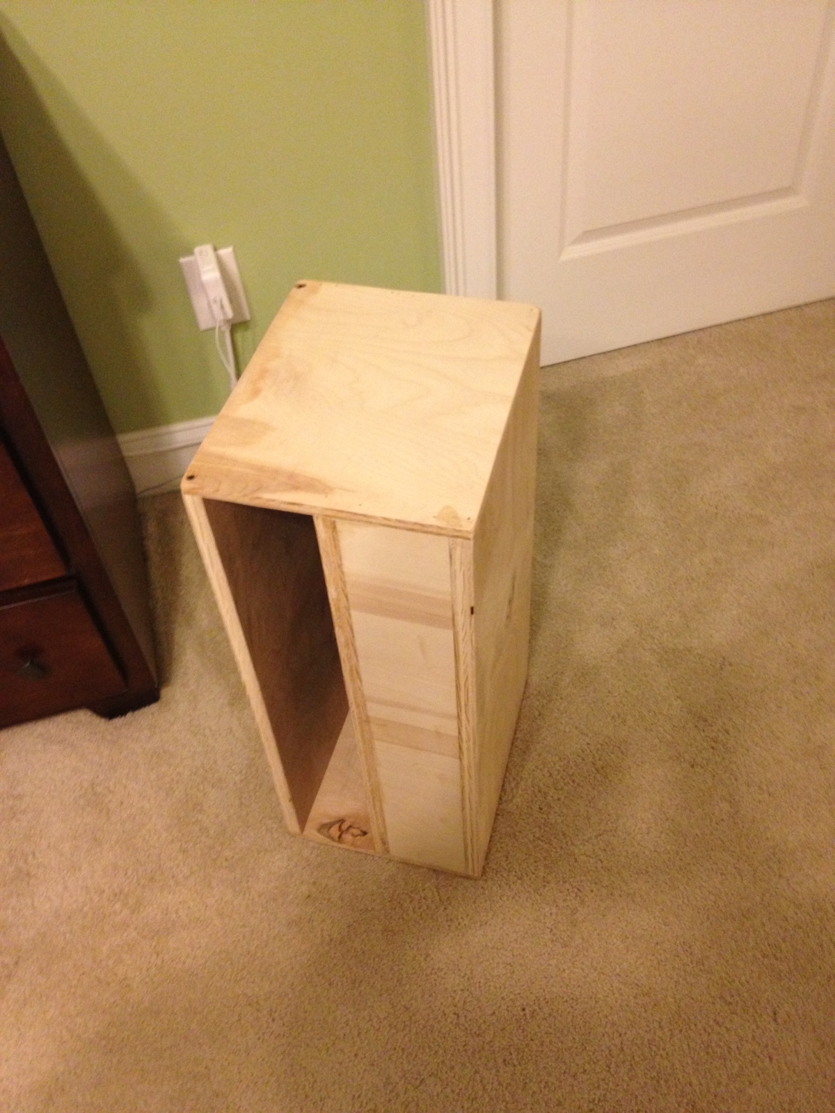

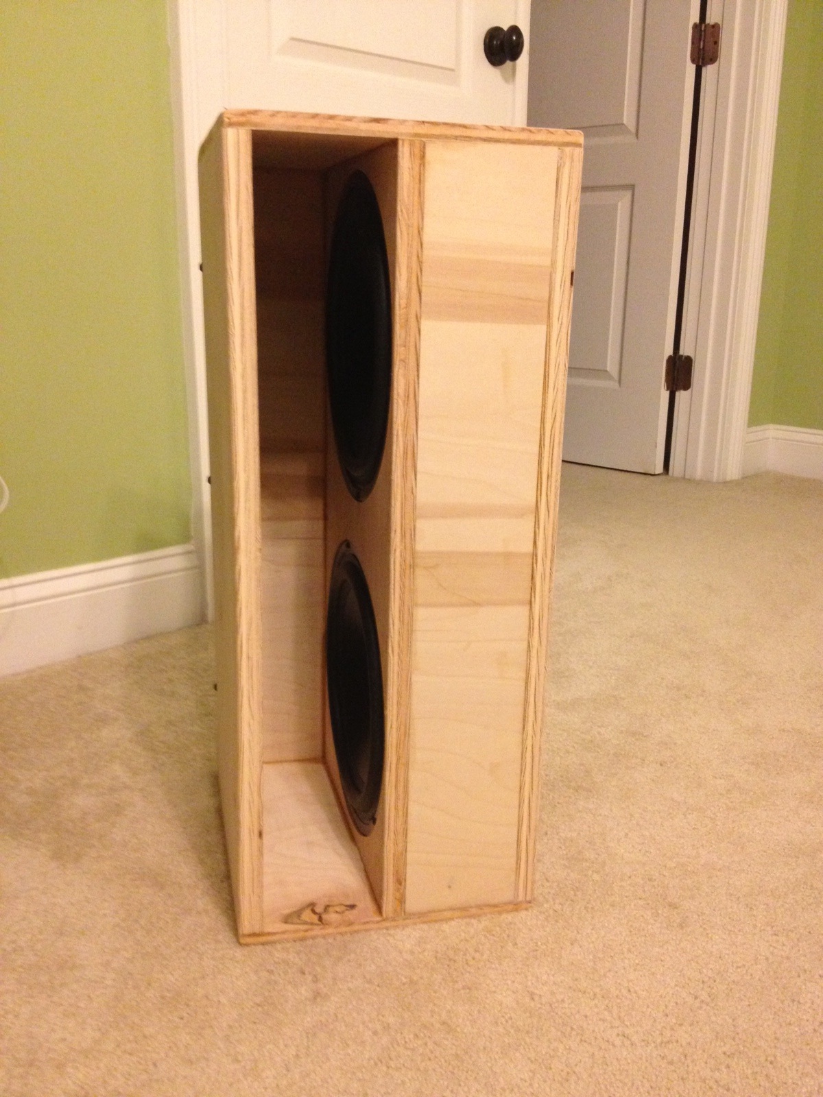

Progress...

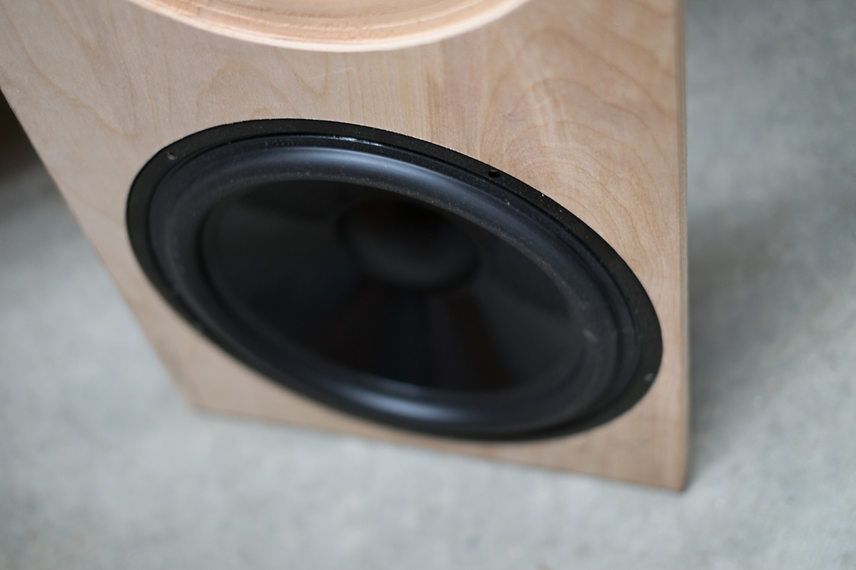

Made a bunch of progress this evening. Slower than I thought, though, but that is OK.
I got one completely assembled. Came out pretty good. Ended up making the cabinet a bitter wider than planned -- about 9.75" vs. 9" to accommodate the bumped back plate of the dayton woofers and my recess.
Too late to measure tonight, but I'll prob. finish building the second enclosure tomorrow and do some basic measurements.

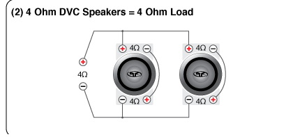

This is my wiring diagram -- daytons are 8 Ohm/coil, but the wiring should be the same. Going to use Cat5 for hooking up the woofers.

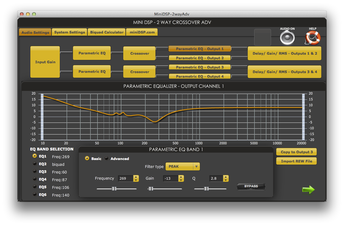

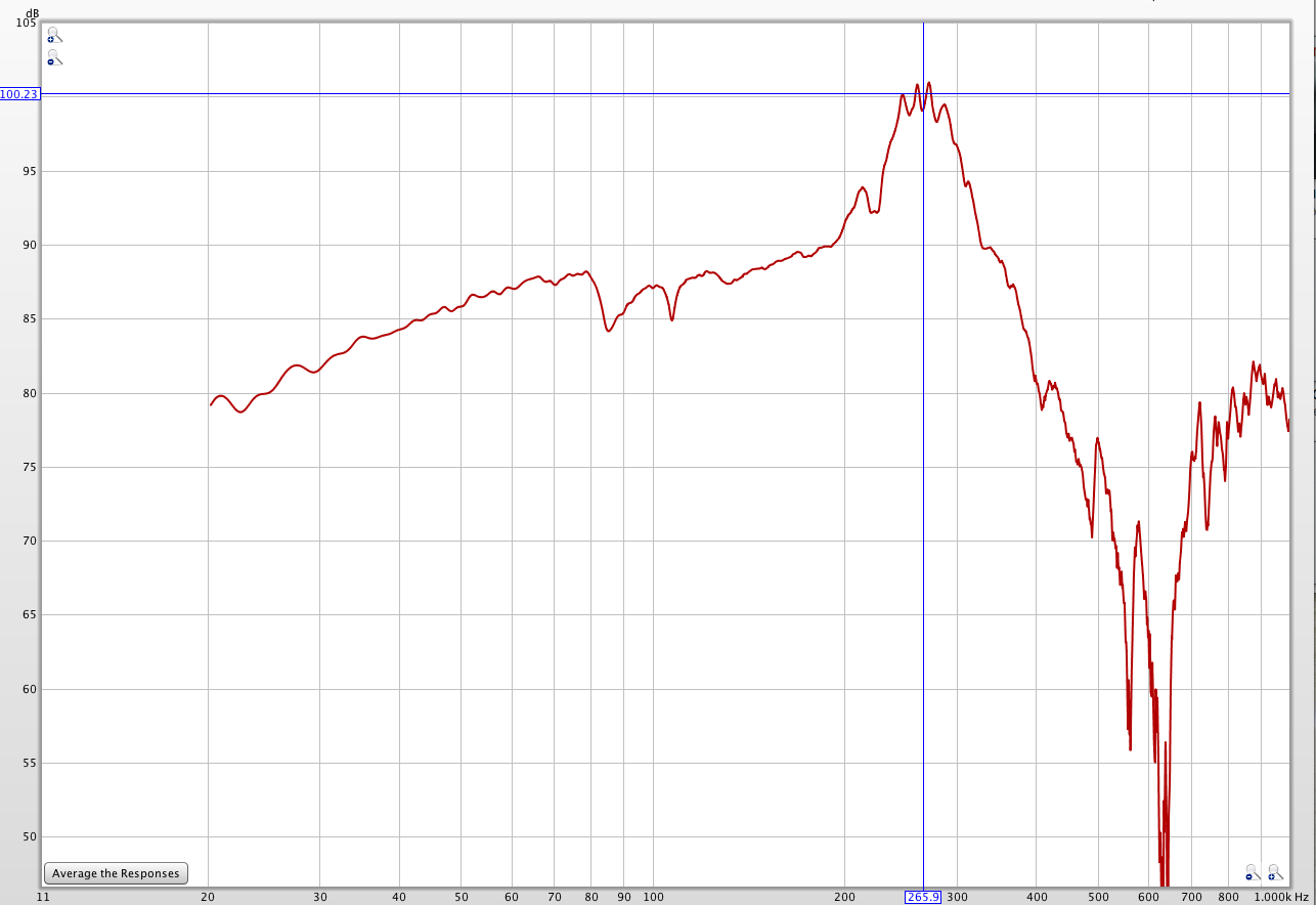

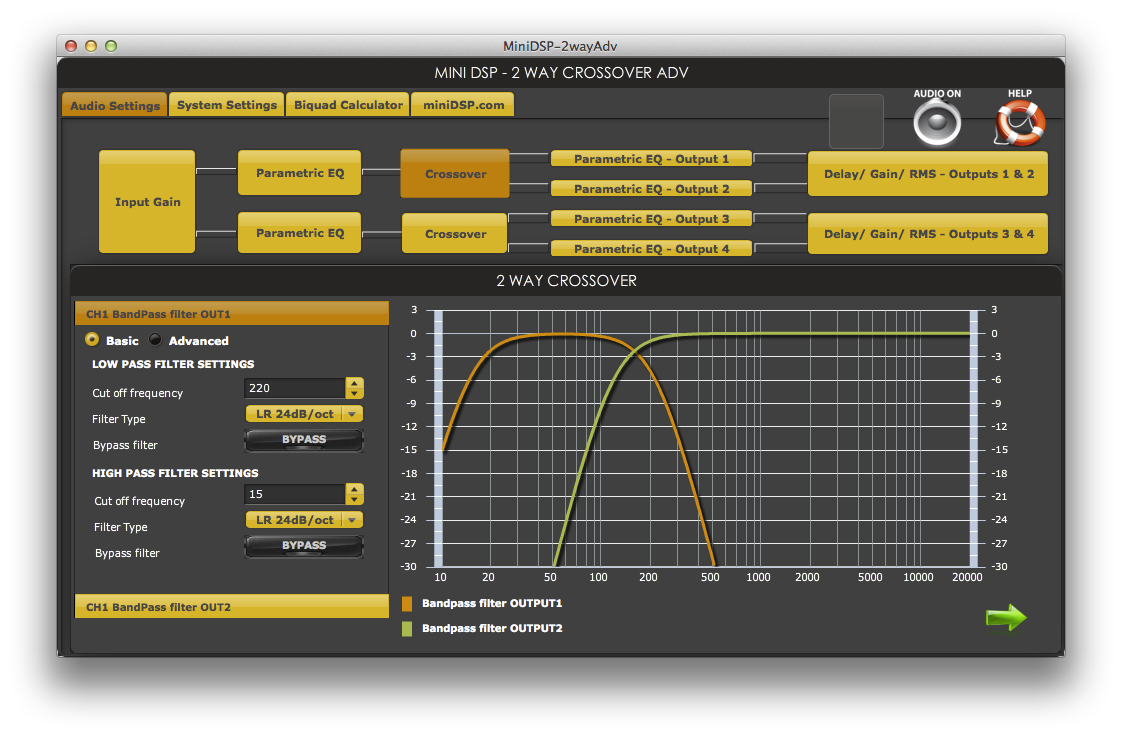

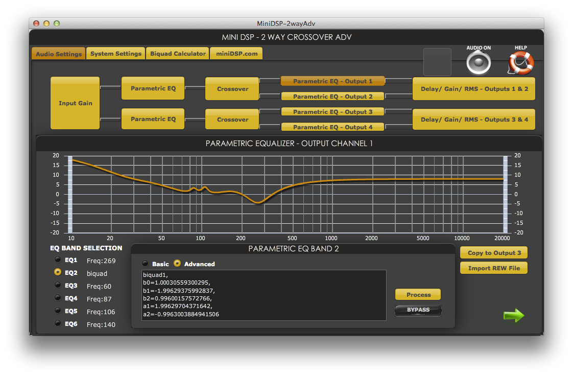

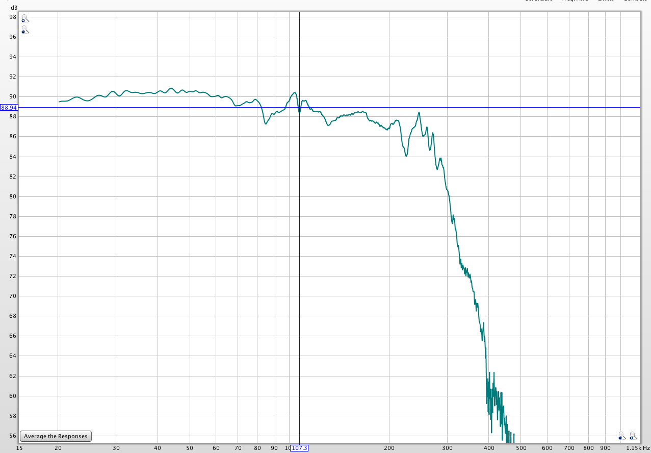

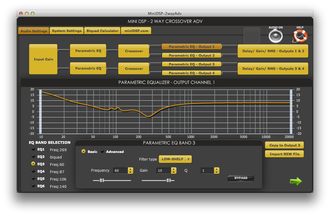

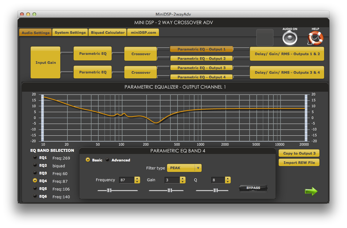

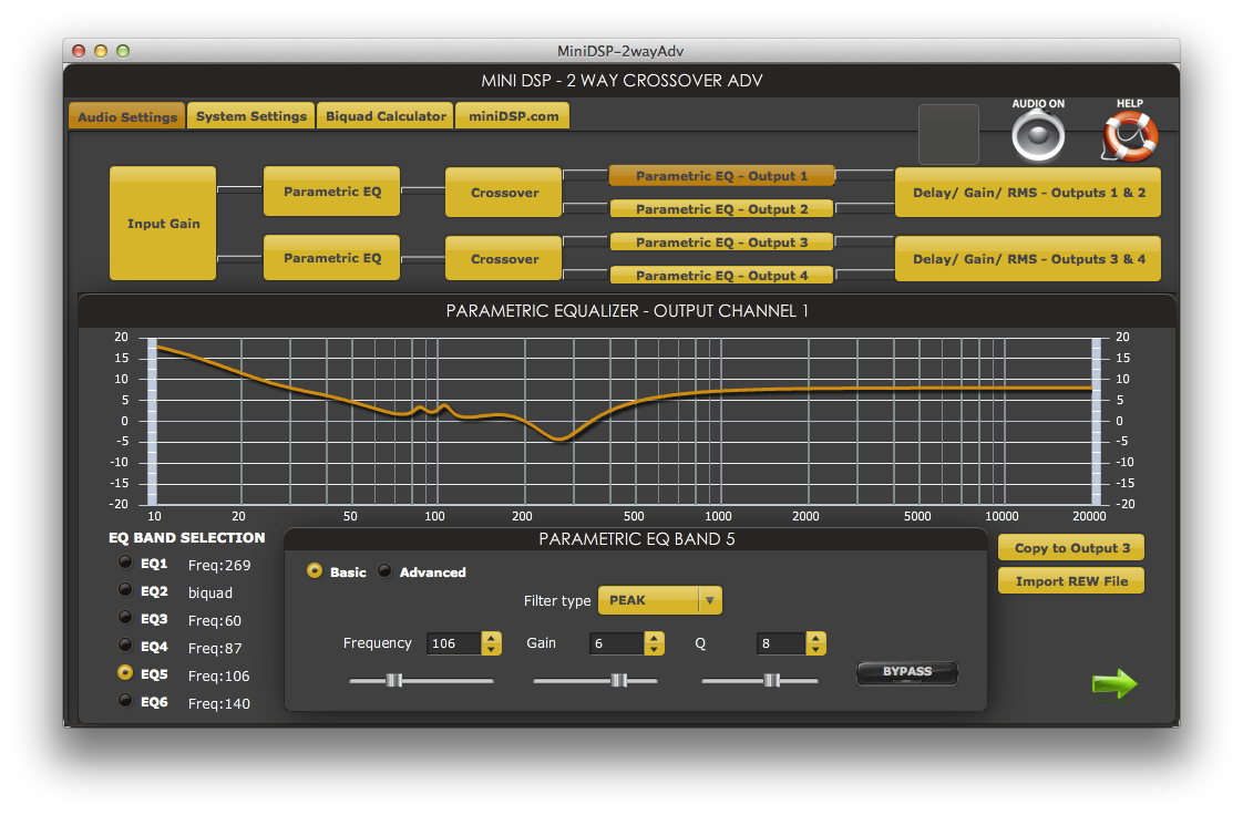

I finished the second bass box today. My Zaph kit comes tuesday, so I am done until then. I did manage to do some measurements and quickie-calibration.
My quart waver resonance was a bit lower than what @Gainphile measured -- I get about about 265 Hz -- so I may need to cross-over a bit lower than 220 Hz to avoid that. Also had a couple of nulls and roll-off that wasn't measured by @Gainphile. It's def a work in progress, but I have a quick crossover and EQ setting. We will see how everything works tuesday when the rest of the speakers come.
Here is my measurements and MiniDSP settings.

Great progress there! Seems like dimension is critical as I got 300hz peak, Sven 350hz and you 265hz!
Yes, It does seem so. My boxes are a bit wider than your ~ 9.75" so it makes sense my notch is a bit lower in frequency.
I did also measure secondary peak and dips which seems to be an artifact of slot loading. I do not EQ them though.

You seem to be eq'ing a lot below 50Hz. Are these measurements nearfield (few cm) or is floor gain already making it's boost? +20sB boost in PEQ of minidsp is a lot, distortion/digital clipping might occur easily or it makes driver bottoming at rather low levels???!
Hi --
Yes I made the measurements nearfield a few cm from the lower driver. I had elevated the box of the floor as well. I am a bit concerned about adding that much gain as well, for the reasons you've stated. I'll make a floor plane measurement this morning from ~1m and see where I'm at -- I suspect I most likely have too much boost.
Thanks for your insight.
You need that kind of EQ to get flat response down to 20Hz. I had a similar amount on mine (22dB) and speakers like SL's Orions and LX521 that use drivers with a low QTS need even more.
On the other hand, whether it is wise to run a dipole down to 20Hz is a different story.
IMHO it isn't.
I crossed my dipoles at 40Hz to monopole subs so the actual boost the MiniDSP sees was a lot less.
