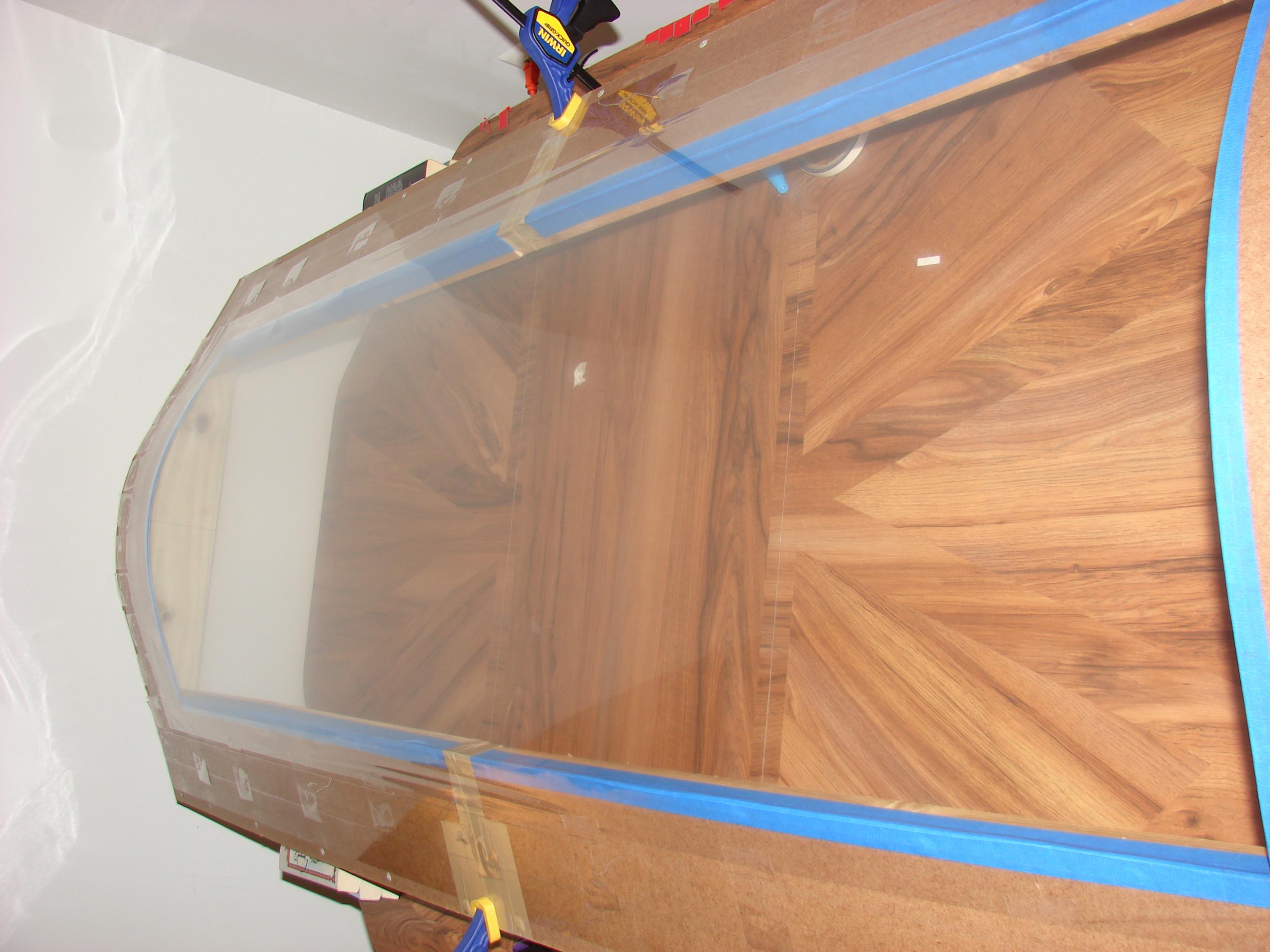

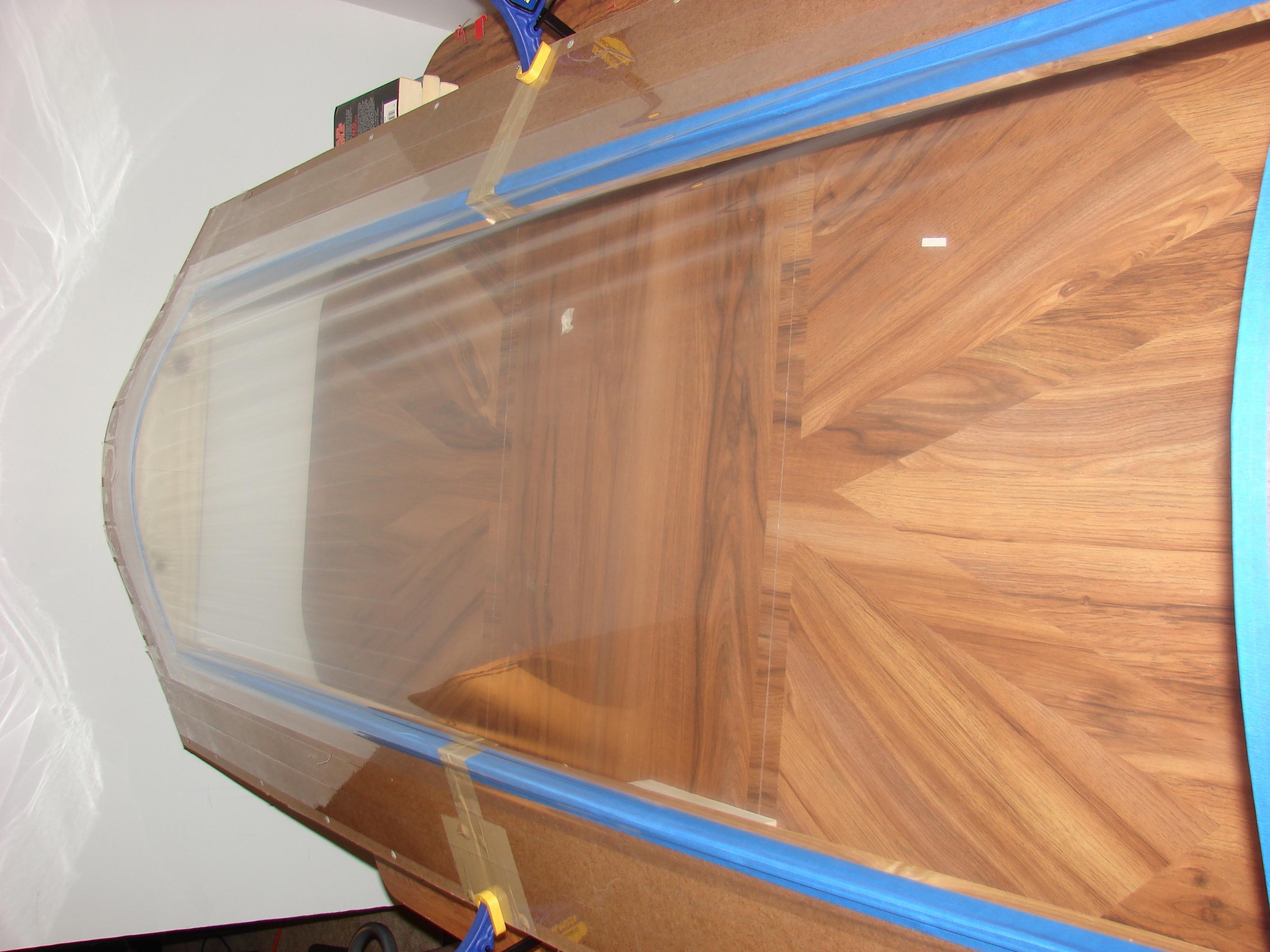

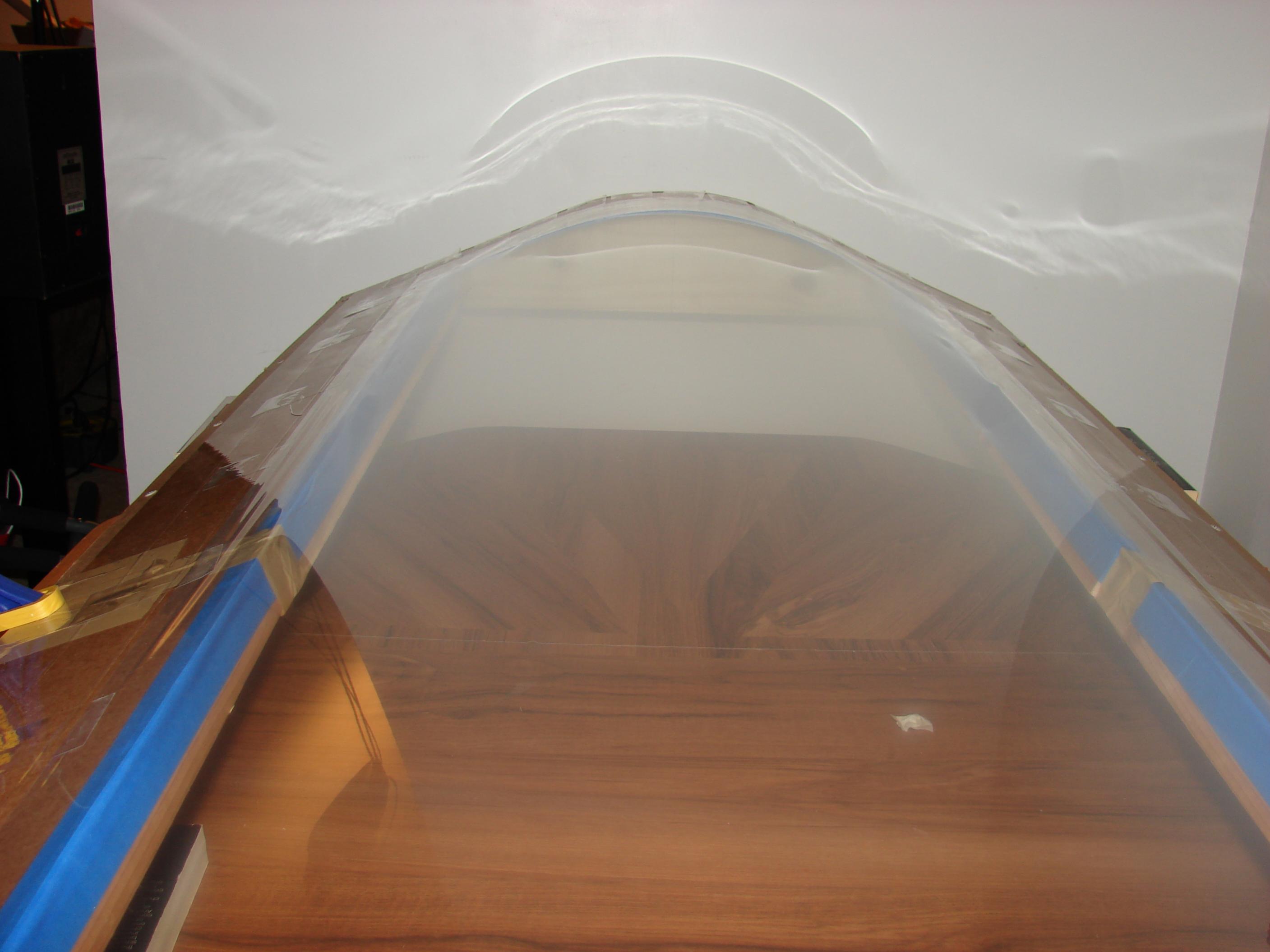

Mounting the mylar -
1. Make sure the mylar is squared to the jig. This makes tensioning MUCH easier.
2. Tape one end down, making sure there are no wrinkles along the taping edge. Start in the middle, working down one way, then the other. I used clear packing tape again, and I used 11 or twelve pieces per end.
3. Move to the other end. Start in the middle again, using spring-loaded tensioning gauge to stretch the mylar to 4kgs. Work down one way, then the other. Assuming the mylar was put on the jig correctly, this should take out nearly all the wrinkles and waves.
4. Start in the middle of the side. Tape down the side, and every 6" or so put down another piece of tape. Move to the other side and do the same, pulling very slightly to get remaining wrinkle and waves out.
5. In this case I turned the jig with the mylar upside down, then put the stator down on the mylar. (Take the remaining backing off the tape first.) I put weights onto the stator, then made sure there were no wrinkles in the mylar. I smoothed the mylar down onto the tape, then cut the mylar around the stator with about 2" to spare, then put the stator on the table to do close trimming.
6. I put 1/4" copper tape on both sides of the stator (available from McMaster-Carr) then masked off the edges before I applied the conducting spray. This is important, since we don't want the very edges of the mylar to be conductive. (This can cause arcing)
7. I sprayed (Licron Crystal) and let it dry for 24 hours.
