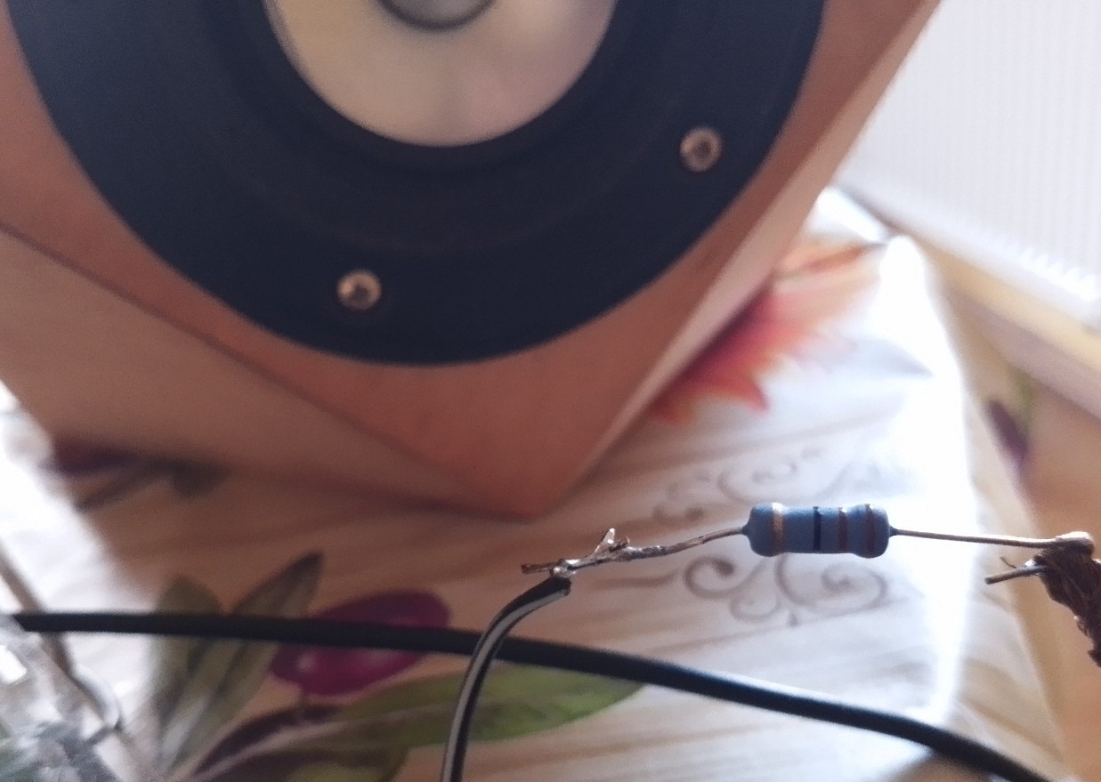

One of these (22 ohm) in series with each...They sound really nice again with most music, and only dreadful when you play loud or complex bass heavy, electro etc.
...cleaned up the sound on mine. The smiley-face EQ is a mixed bag as the top end becomes a little hot, but the overall result is smooth.
The 100W little class-d amp now gets dialed up a lot higher because of the resistor, but it's also a lot more tempting to crank them.
(It's a big 2W unit, btw. A couple times bigger than the ubiquitous 1/4 watters.)

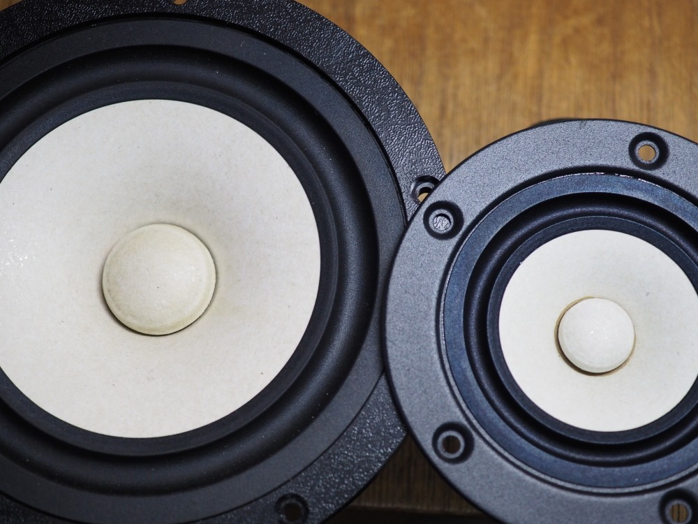

Do you know where i can get those chn50p on a usa/north america site?..as they will be ship to colombia...i dont see the alpair 5.3 neither on stock at madisound... thanksI just changed to CHN50P which is paper cone version of CHN50.
Comparing with the OM-MF519 I listened before, the 50P seems a bit more natural and organic especially on vocal playback, mid-bass also more texturized.

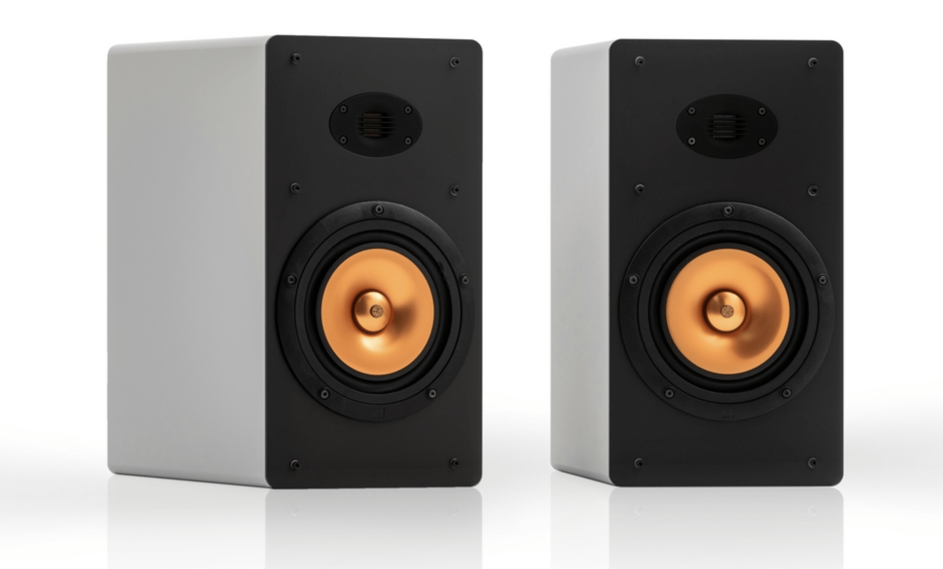

These sure look like MA drivers. Nice to see them around commercially.
"Unlike conventional loudspeakers, the Move is a point source built with a full-range transducer. The entire spectrum of the music signal is reproduced by only one voice coil. Completely lossless and without crossover. The amplifier output is directly connected to the transducer. A super tweeter extends the high-frequency range up to 36 kHz and provides a rarely heard transparency for recordings with high sampling rates."
https://lindemann-audio.de/products/move/?lang=en#Features
The dimple on the dustcap of those looks like they have stuck something into it. Felt might help attenuate the top. Pluvia 7HD. 9-10 litre reflex. The 40 Hz bass extention wil be F10.
A tweeter added up so high will be a bit of a mess but will add some HF “air”

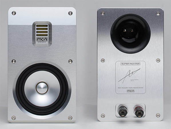

This here is a similar approach. Markaudio drivers (I believe CHR series) for commercial use. Also with a helper tweeter (or maybe super tweeter) on top.
https://monacoustic.us/product/the-supermon-mini-2/?v=f24485ae434a

I think the drivers used are the Alpair 7MS.
I have read on one of the reviews of it online, quoting:
"This 5-inch marvel, crafted from an ultra-stiff magnesium alloy, transcends the limitations of traditional speaker design, ushering in a new era of dynamic, full-bodied sound reproduction...."
"The Move’s full-range speaker achieves this independence through a sophisticated mono suspension of four synthetic materials..."
Upon close zoom, there actually isn't a dimple on the dustcap, but they did put a cork-like material on top of it.
I'm guessing they added the "super tweeter" to add more treble detail? (Alpair 7 MS has been said to have more attenuated highs or a smoother top-end compared to its predecessors, right?)
