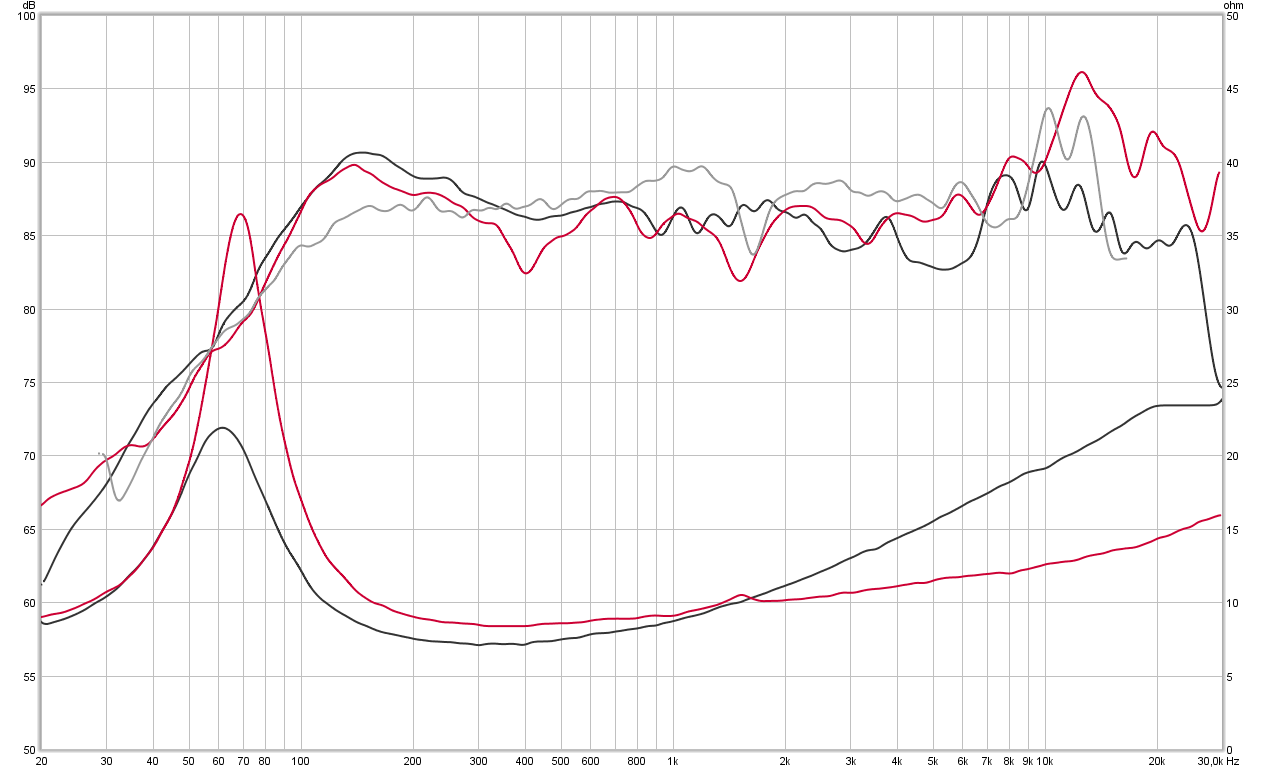

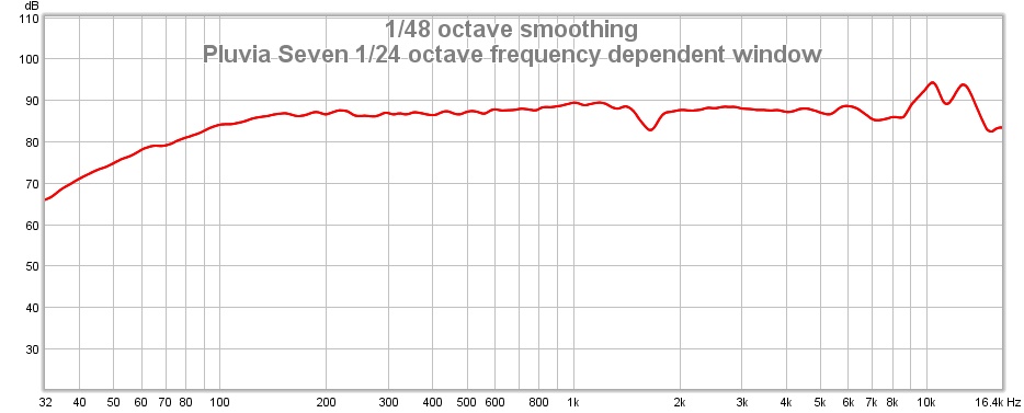

I ran a quick measurement of the speaker. I'm showing with and without 6 bands of parametric eq and with a 1/12 oct. frequency dependent window. Unfortunately, there is a pretty severe breakup at 20.5khz that makes the impulse response look ugly. I don't think it's an audible issue. I did some listening (just one speaker) with the eq as shown along with a Linkwitz transform and some linear phase baffle step compensation. It sounds really good.

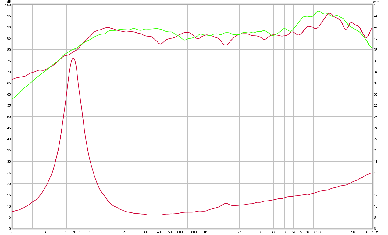

Is there any way you can increase the resolution of the graph by reducing the db range?
And perhaps keep the smoothing to 1/24 oct?
Thanks!
Thanks!
-vertical scale reduced by 30db
-frequency dependent window size increased to 1/24 octave
-mic cal applied
This was just a quick measurement I made out of curiosity. I have not checked for repeatability. I plan to do a more thorough job when the speakers are completed.
edit: I originally showed the response to 30khz, but decided to remove it since my mic is not calibrated in that range.

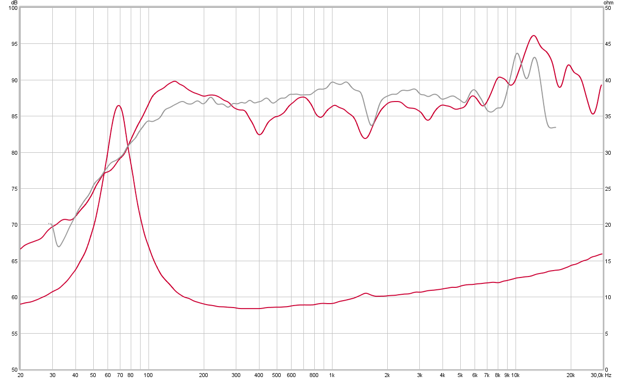

Bigun, think remember you did a A10m gen3 build for a friend that you liked some, and if we compare manufacture data on same graph think Pluvia Seven is high value driver and it actual also have a very beautiful look seen with my eyes. First visual below is usual 100dB range or more as MA normal publish where second one is a 50dB range, green is A10m gen3 and red is Pluvia Seven.

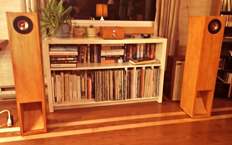

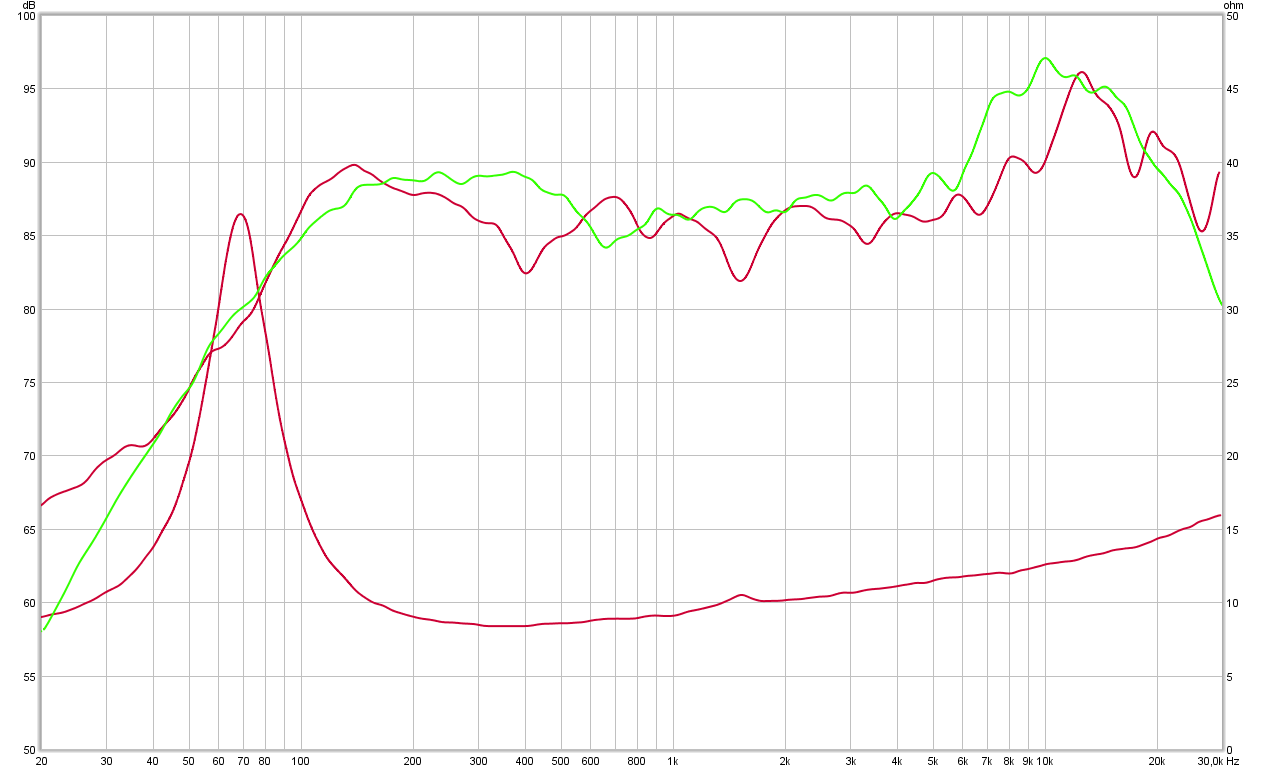

Third visual is gmad's beautiful enclosures http://www.diyaudio.com/forums/full-range/265053-hypercube-loudspeakers-52.html#post4811515 smoother performance verse manufacture's IEC baffle, and fourth one is same but intended info for gmad where FR135EX manufacture data is mixed into. Amplitude dip and impedance blib just below 2kHz is probably because of under hung surround and un-repairable, it falls at a unfortunate frq point seen with eyes what they discuss and try to improve at this thread http://www.diyaudio.com/forums/multi-way/277519-fixing-stereo-phantom-center-61.html#post4745331

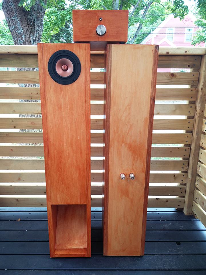

Thanks, BYRTT. One thing I should have mentioned is that the second graph I showed is derived from the minimum phase extracted version of the sweep; I had lost the full measurement which I think is what I used for the first graph. They were, of course, very similar, but I remember thinking that the broad peak around 1khz may have been slightly more pronounced in the min phase version. Sorry for the sloppiness . I meant to do a more accurate and thorough job by now but I wanted to wait until the speakers were done. It's taking a lot longer than I anticipated since I decided to redo the finish (I'm still not sure whether I want to spray or brush...).
edit: About the dip that shows up in the impedance sweep: I had assumed this was due to the driver behaving a bit like a BMR. Could this possibly be the case?

Just a quick follow-up to my previous post to clear up any confusion (since I now remembered what I actually did). Both frequency response graphs I posted were derived from the minimum phase portion of the measurement. I intended it to be this way for the first graph since I was showing the response with eq. As I remember it, the second graph would have showed slightly flatter response through the midrange had I used the the full measurement (not just the min phase portion), but I had lost the original measurement. We're not talking about a big difference here, but I wanted to be as clear as possible since BYRTT took the time to make those graphs.
