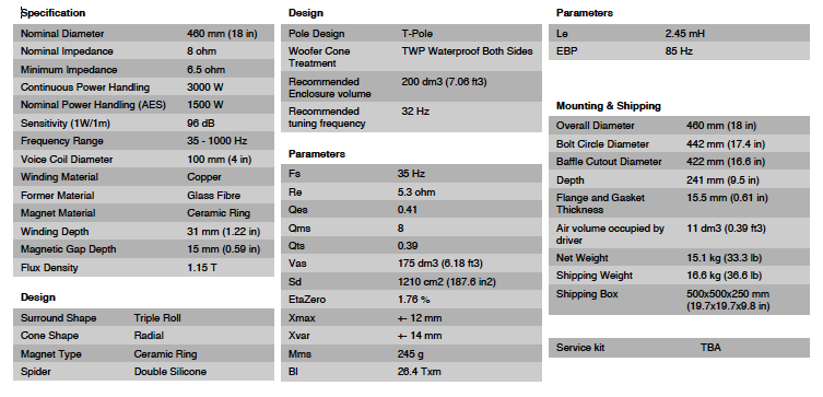

the BC 21SW152 models well in the Keystone design
Art
Art, would the BC 21SW152 physically fit into the current Keystone design?
Cheers
Martin
no ,the driver is to deep .Art, would the BC 21SW152 physically fit into the current Keystone design?
Cheers
Martin
when you make the front compartment 1" deeper it will.
