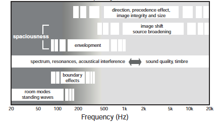

I believe your findings are exactly in line with my personal experience and what Toole found (fig. 5.2):
Image shift and source broadening is nothing you repair at 6 kHz plus.
My dipole tweeters come in at 2 kHz though.
Rudolf
