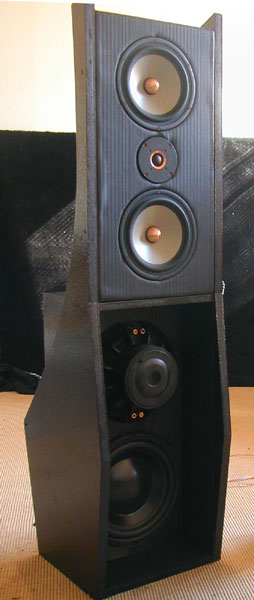

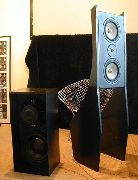

I'm glad to hear others validate this decoupling concept. I did it in my open baffle speakers, but never did any valid comparison tests to see how much it helps.In my own experiments, stopping the speaker carcase vibrating, or damping that excess energy that has to go somewhere when speaker drivers are working hard, pushing back and forth on the baffle, has made a very significant difference, creating a better sense of space.
Frank
http://www.spiritone.com/~rob_369/audio/AuriumWaveguide2010.htm
It made sense to me theoretically, so I did it. I do have spell binding imaging and sense of space with these babies.
