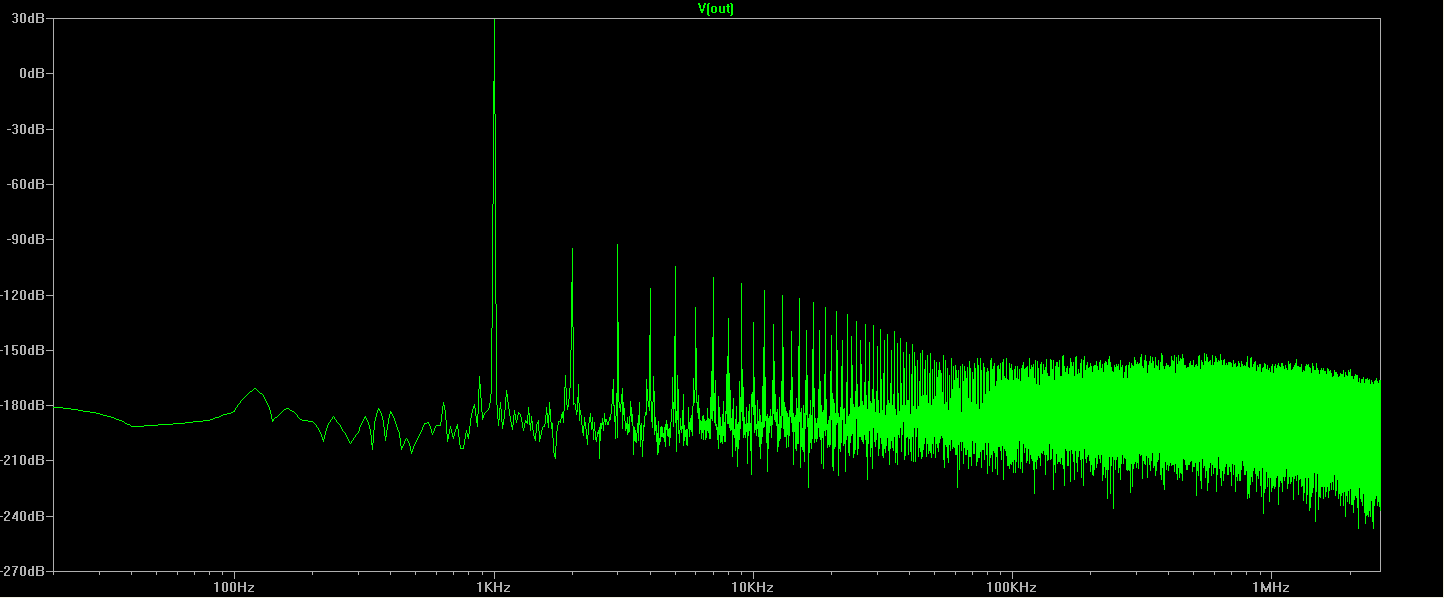

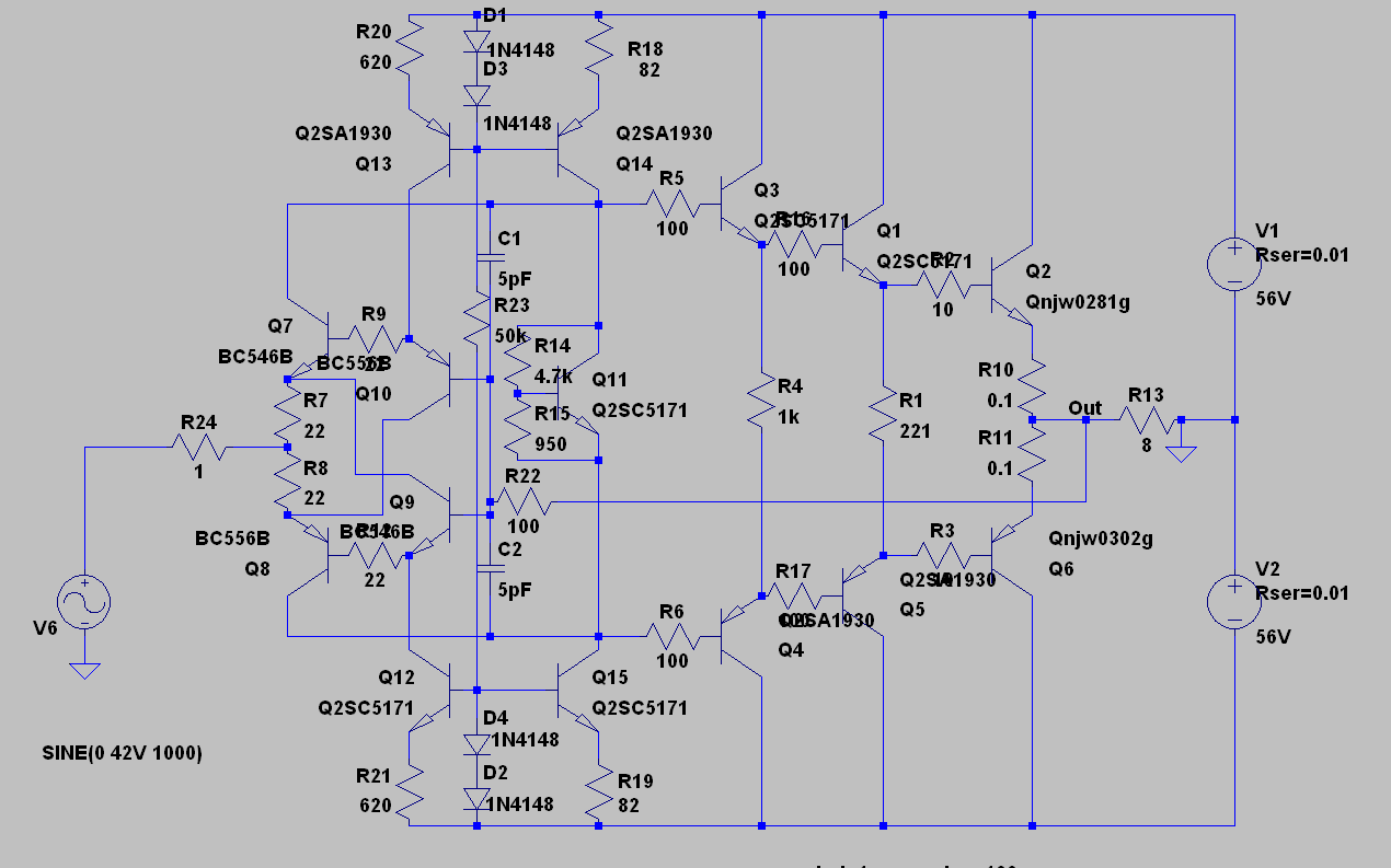

I made some simulation, with some other semiconductors, and with lower current ccs. It looks promising. Schematic attached.
Distortion:0.00009%, 1kHz, with 110W output, and 8ohm load. Input impedance ~10MOhm.
Sajti
Another issue, that there is only one pair of output devices used. Doubling the number of them results much lower 5th harmonic (-138dB comparing the output level), and much less higher.
The only issue I found, that this follower needs low impedance driving. Increasing the driver impedance to 1kohm makes the distortion 10times more...
Sajti
