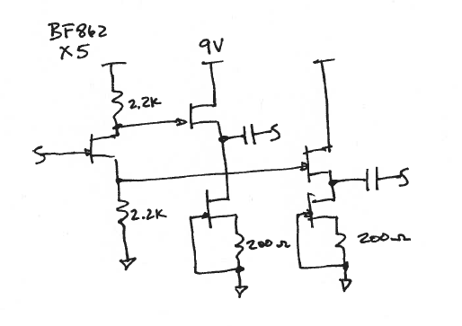

Had wondered yesterday, if any of Burkhard's circuitry could be used to lower the output impedance of Scott's part one microphone amplifier.
Actually, wonder if this modification shown below would work with Scott's phase splitter.
(Just anxious now that I have parts and needing to wait for the next issue.)

This is better. I may play with the values and try.
Look forward to volume three.
That looks better. Watch out for the very different DC bias points top and bottom it will limit the output swing a lot. AC coupling can be used, remember the input bias R for the FET's can be huge like 22Meg so good film caps are not as expensive.
