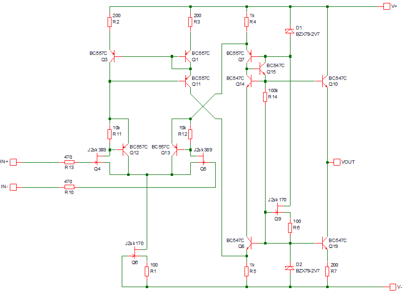

First.
Even if it maybe is not obvious from schematic,
the basic topology idea is the same as for Analog Devices AD797 opamp.
1. All gain is in first stage 2 transistors differential
2. Second stage is used to integrate the gain into one node
3. Third stage is a buffer

Hi
This looks nice.
Original schematic misses 47pF comp cap.
In my opinion if you go discrete and symetric supply it is better to connect compensation cap to ground than to -V because of PSRR.
IC op-amps of course can't do this, because they do not have 'ground' input.
regards
Adam

I have elaborated a little with this basic schematic.
Raised rails to 50 V inserted jfet cascodes and changed transistors to MPSA 42/92 for the output stages.
Then I have added a lateral mosfet output stage, biased with a resistor in the current output stage.
This forms a very capable power amplifier. With some nice distortion figures.
Schematic added
Michael

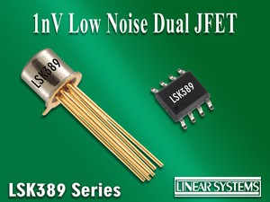

LSK389 Ultra Low Noise Dual JFET

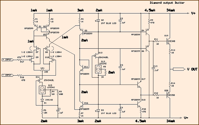

mtlin12 said:
Hi lineup & KJ42 ,
I've followed your designs and made some changes from my
ULTIMA-PRE headphone-amp, using diamond output buffer.
See attachment:

was from your webpages
I first found out about Linear Systems Dual Monolithic ultra low noise JFET lines
1 nV and 3nV ... etc. etc.
you know, such like ... LSK389, LSK170, LS840, LS843
( they also have Hyper Modern SMT: DMOS small MOSFETs - with Great Data )
Most LS new dual JFET has got <20mV match by Vgs ;)
They provide EXCELLENT :cool: Download Support of Spice Models in ZIP files
... and these Models work perfectly in My MultiSim. Those JFETs are only to add to my Library.
I use MultiSim -- Tools -> Component Wizard -- to add any new Spice Model
Image shows LSK389 dual jfet

mtlin12 said:
Hi lineup & KJ42,
See attachment:
If this work, then I'll add my new thermaltrack Power DB
http://www.diyaudio.com/forums/showthread.php?s=&threadid=96662
to become a 50W non-global NFB power amp.
Very nice, mtlin12 :)
Yes, this was my idea with my original more Principal Simplified Diagram.
To be some thing to start with.
And so we can adjust and modify my idea for our own circuits.
Most Diy amplifiers have one special purpose:
To take some special input source and to output the amplified signal into some specific existing Load Device.
So we make one custom circuit for our own specific needs.
mtlin12,
I attach your modificated, and sure Better! circuit. As an image.
(for original PDF, see mtlin12 post above)

I like the CFP in the input.
Sure is that my circuit needs more gain. So, it will be less distortion.
Also there is the question of how to compensate ...
