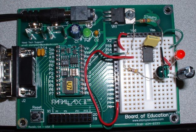

I'm starting to work on my new IR remote control for preamp.
I red a lot of posts on this site but was never satisfy with the different approach. I knew the Basic Stamp and like the way I can easily change and experiment with it.
My first protype of IR receiver/decoder is working. :cool:
The IR receiver and decoder is based on the work of Michael Owings. See is excellent work at: http://www.swampgas.com/robotics/irremote/
The receiver is using an PIC12C508 MCU and a Sharp IS1U621L IR receiver. All parts can be obtained easily from Digikey. It accepts any Sony remote.
The control will be done using a BasicStamp2. The preamp display will be a BasicStamp serial compatible LCD.
A led is also included that flash with the IR received.
I'm using a BasicStamp2 kit to read the code at the moment.
This kit will be used in my next Classe Clone Preamp and my future XBOSOZ Preamp.
Schematic, Bill of material and code will follow...
Picture of the prototype:
