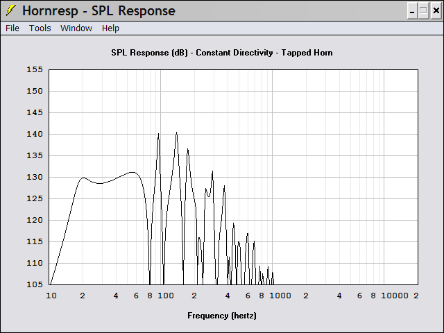

dangus said:
There are T-S parameters in the pdf spec sheet:
Greets!
If these specs are reasonably accurate a well damped Vb = Vas, Fb = Fs (or a bit lower) TWQT could be pretty good in a HT app, especially if corner loaded. This slightly larger (~246.2 L) tapped pipe (TL) might be even better, though not knowing its excursion specs this peak SPL may just be a 'pipe dream' if not corner loaded and there's not enough room gain to help it below ~32 Hz. It should still pound pretty good if not though and it doesn't have an obvious 'gas' problem to mar its performance.
GM
