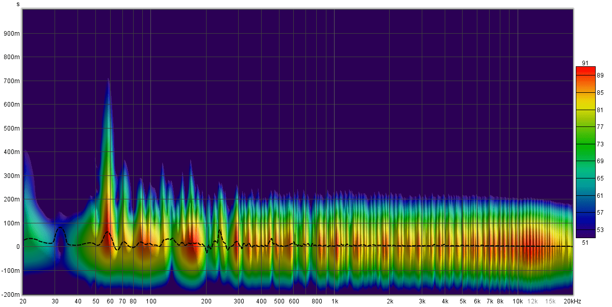

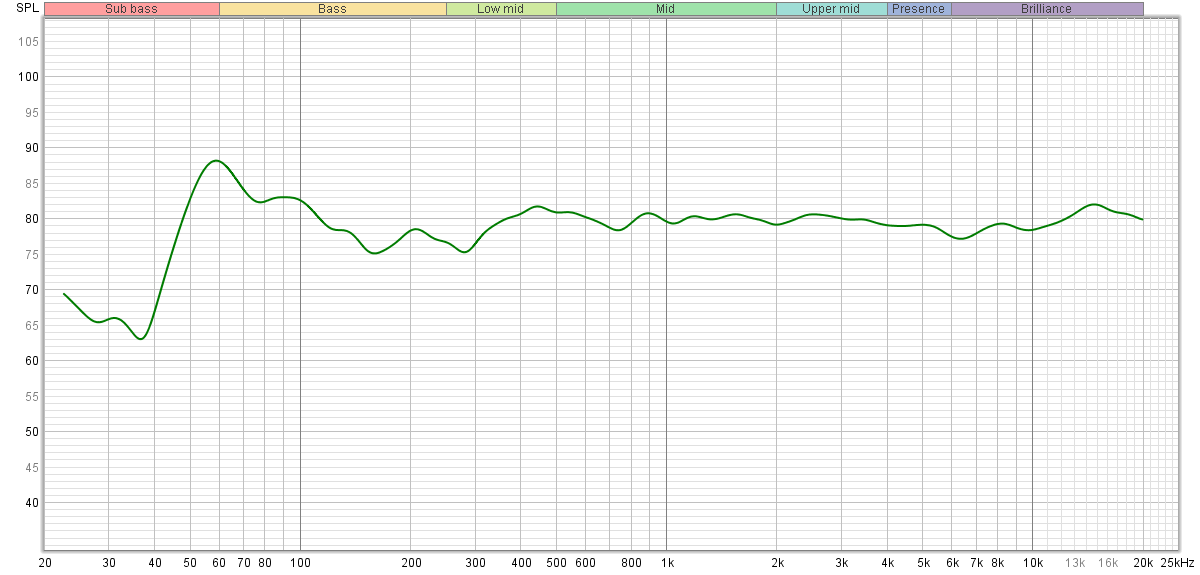

In-room one meter away head on response from the right hand speaker only. As seen placed in post #29. Handheld mic quick take from the other day I visited to briefly listen. Don't know if of serious measurement value, but anyway.

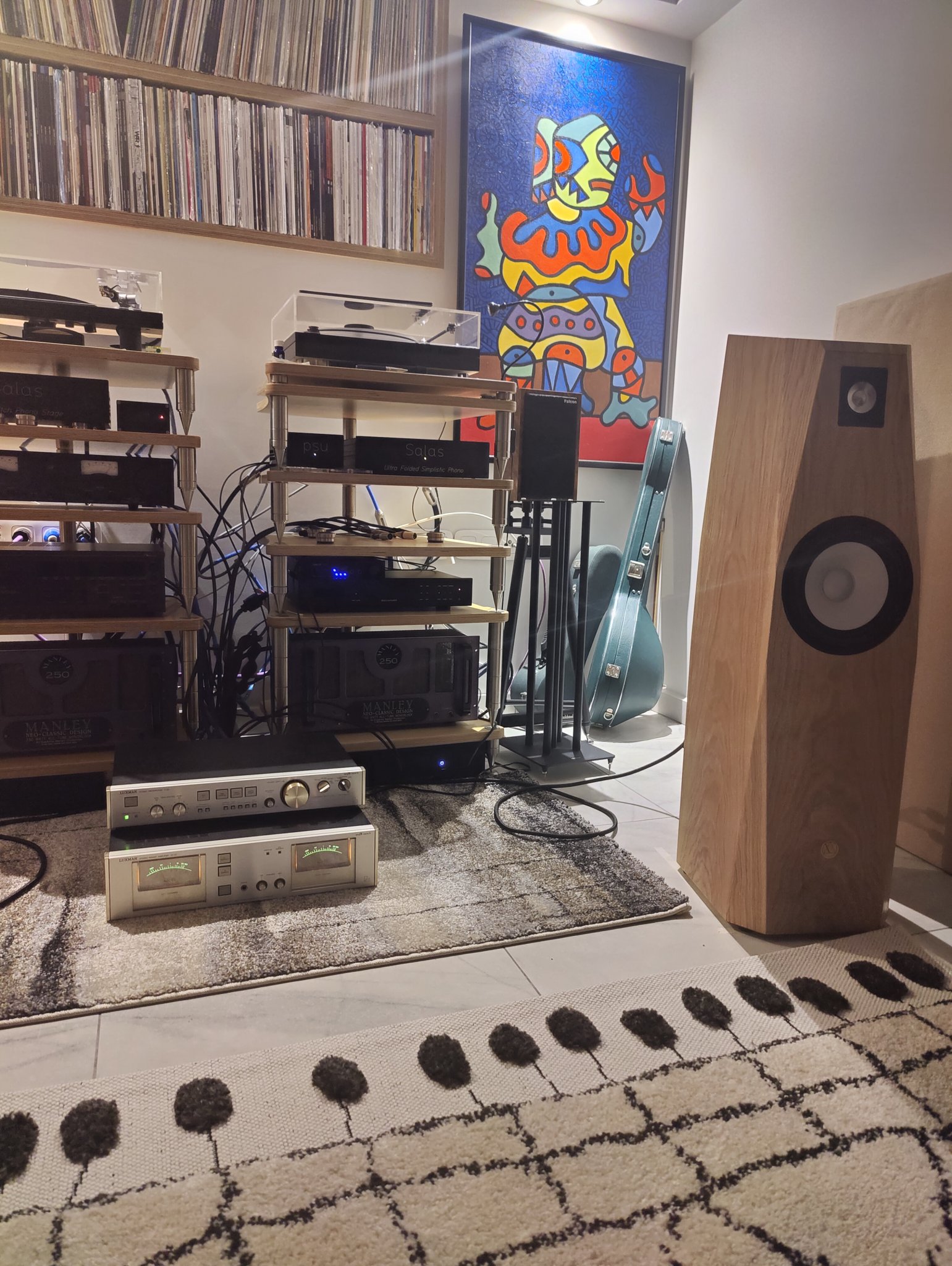

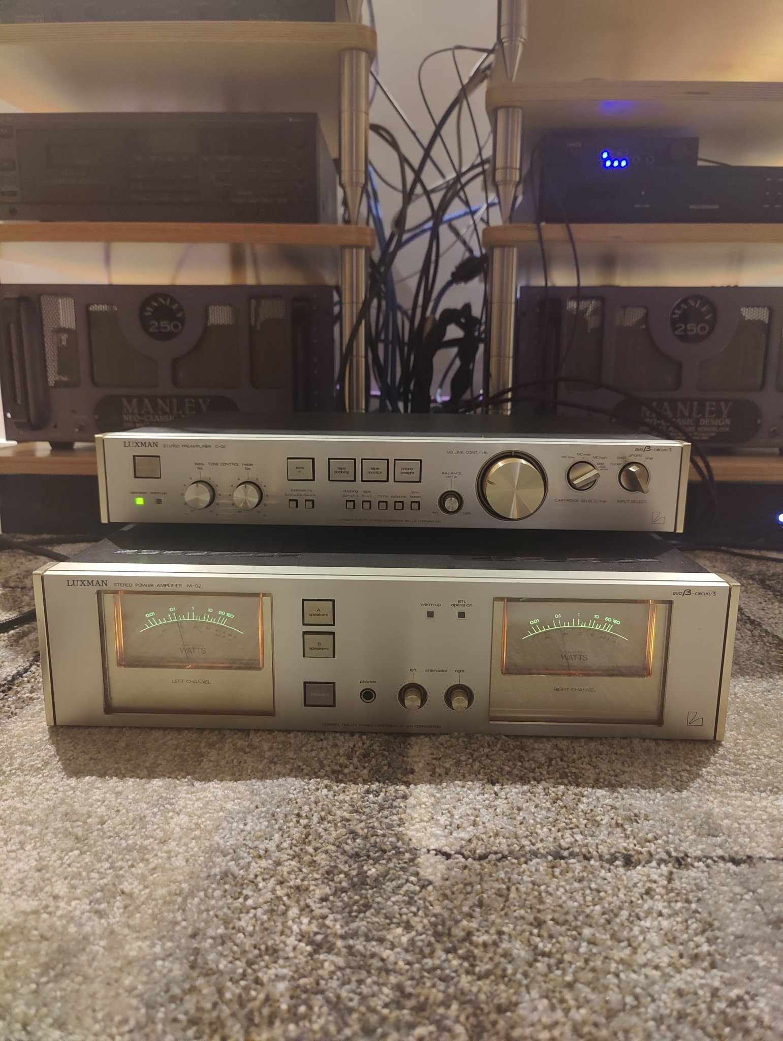

I have a pair of vintage luxman amp and preamp,c02,and m02.i connected them to the aluminum bliss.i must say I have never heard these amps so good before.very good combo!

Its easier to discern amplifiers traits with these speakers it seems. You have mostly consistent 200mS reverberation acoustics on the Bliss there I see, helping clarity. Unless around 60Hz which is obviously a room mode build up. Then a 40Hz suck out follows.

Nice build. Great system. Congrats! If I may ask a slightly off-topic question, is that a Benchmark DAC glowing there? If so, does it live up to the hype? How do you like it? I'd love to hear your take on it, especially since you are the owner of such a diverse setup.
Reactions: 1 user
Thank you!yes it is a benchmark dac3 hgc,and I have no need of another dac anytime soon.it is very good sounding, neutral, transparent, musical.i also have the benchmark dac1 in another system,and I can assure you that dac3 is in another league.more analog sounding, while being very transparent.
