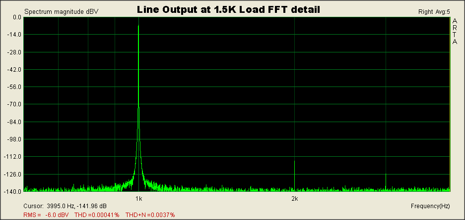

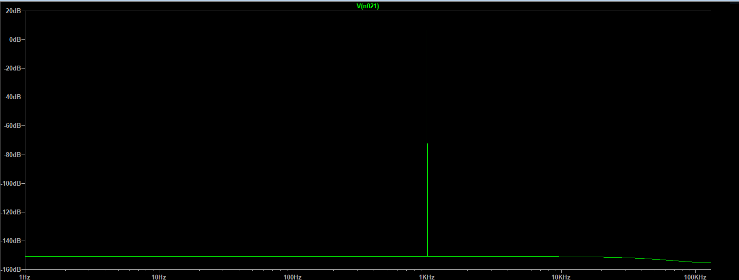

The DCG3 has a second-order dominant distortion (FFT courtesy of Salas in the DCG3 thread) and this is into a 1.5K load. My friend is using 26 Ohm Oppo planar headphones so presumably the current demand, and resulting distortion, are higher than shown on the graph.
I've decided to call this amp the HPA1 since it's a headphone amp and my initials are "HP." So, my impression of the difference between the HPA1 and the DCG3 is that it's like the stereotypical difference between tube and transistor sound. In my advancing old age, I don't have much in the way of top-octave hearing, so I may be missing some distortion that others would readily detect. Or it could be a matter of preferring a slightly more or less colored sound.

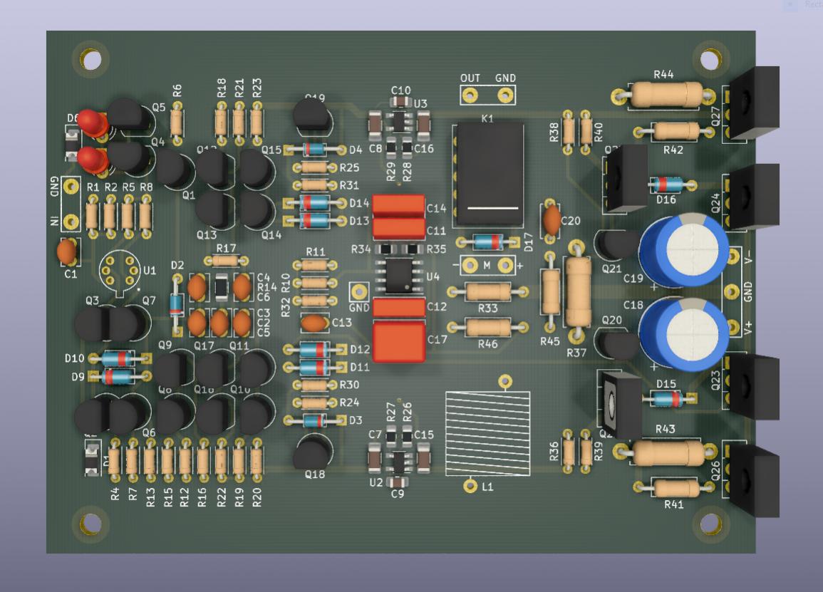

I've uploaded my KiCad project files for the amplifier board to Dropbox. Send me a PM if you would like a link.

Nice boards. I don't recall reading about this design. I'll look it up.

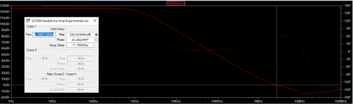

I've been playing with SPICE and learning more about advanced compensation techniques. Something I failed to appreciate during the design of the amp in this thread is how sensitive the VAS collector-to-base circuit is to tiny capacitances, on the order of 1 pF.
It looks like, from SPICE, that the Baker clamp diode I added has significantly buggered the compensation. It turns two-pole compensation into three-pole compensation, and presumably it's highly-dependent on diode junction capacitance nonlinearity since it's not swamped by a large Cdom. Consequently, I decided to toss the Baker clamp. I added a 1K base current-limiting resistor to the VAS transistor. This doesn't stop saturation, but it keeps the transistor from blowing. SPICE doesn't simulate saturation well, so I won't know how bad the clipping is until I try it in real life.
Adding back-to-back diodes across the LTP cascodes further reduces the amount of VAS base current during overload. This should speed up recovery. The cost is a small increase in distortion.
I also learned this week about putting a Zobel from the input of the diamond buffer to ground to compensate for the diamond's natural RF peaking. I selected 10 Ohms and 390 pF for this.
I was able to retune the TPC with smaller capacitors which reduces the load on the VAS output. The overall effect is a, well, a significant decrease in simulated distortion, more gain margin, higher open-loop GBW, and no loss of phase margin.
My amp is still out for evaluation. The assessment is overall very good, but with a complaint about tonal balance. I have to wonder if all this has anything to do with the subjective performance. I don't have a function generator to do square wave testing, but I plan to get one shortly. When I get the amp back, I will do some more testing, then take it apart and modify it to make these changes. If I'm pleased with the results, I will update the design.

The low-distortion-at-all-costs crowd strongly condemn Baker clamps across the VAS and SPICE confirms the negative effect. I don't have a sense whether 0.000004% of added distortion is a problem in real life.
One other issue I've noticed is a weird phase inversion (see attached) on negative peaks that happens when I drive the amplifier strongly at RF frequencies. It should be possible to protect the amplifier from slewing or overload at any frequency when the input amplitude is limited to normal levels. I may have just overloaded the input with my generator. This misbehavior should not be a problem in real-world use, but I need to investigate more. SPICE does not show this effect.

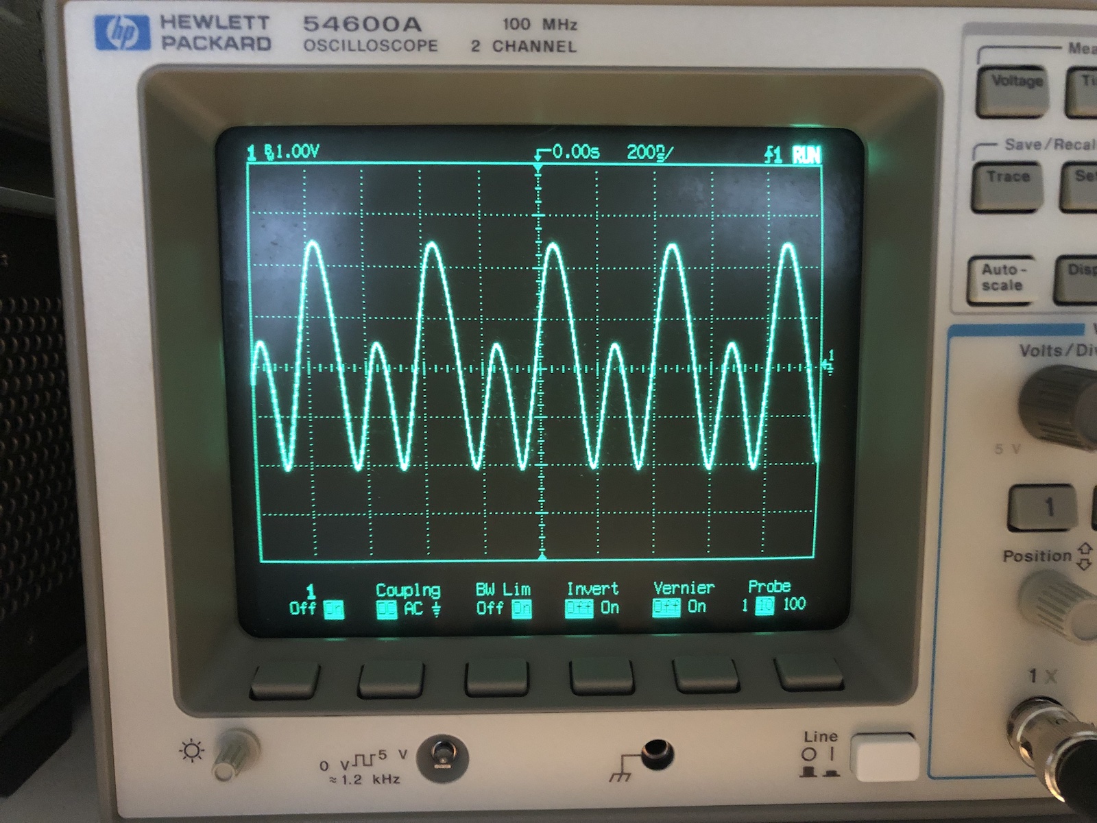

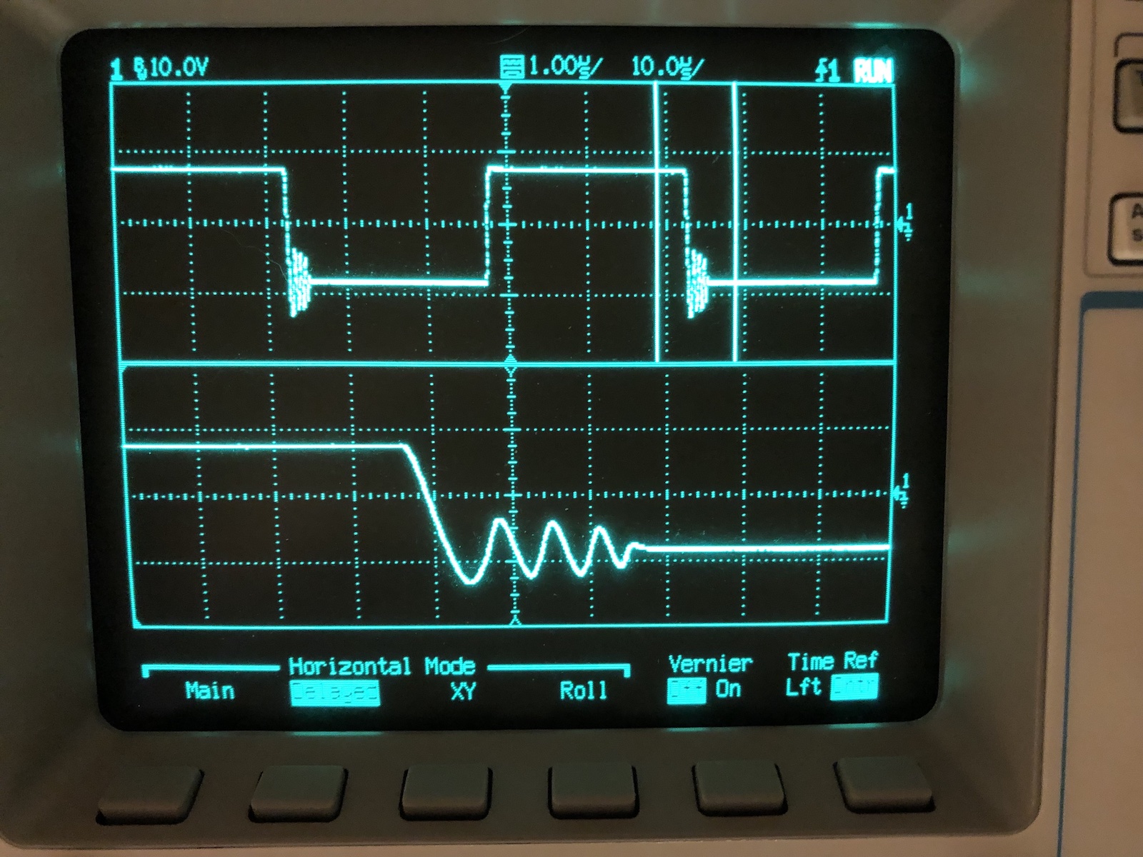

Very nice!
Thanks.
I forgot to mention, the frequency in the photo above is 5 MHz.
Also, the output inductors are 14 turns of magnet wire wound on a 3/8" drill bit. After heat shrinking the coils, I smeared some epoxy inside to hold things together. Unfortunately, the spools in my junk box are unlabeled, but the wire diameter looks to be about 0.7mm. The value isn't critical. I measured mine around 1.2 uH or so, IIRC.

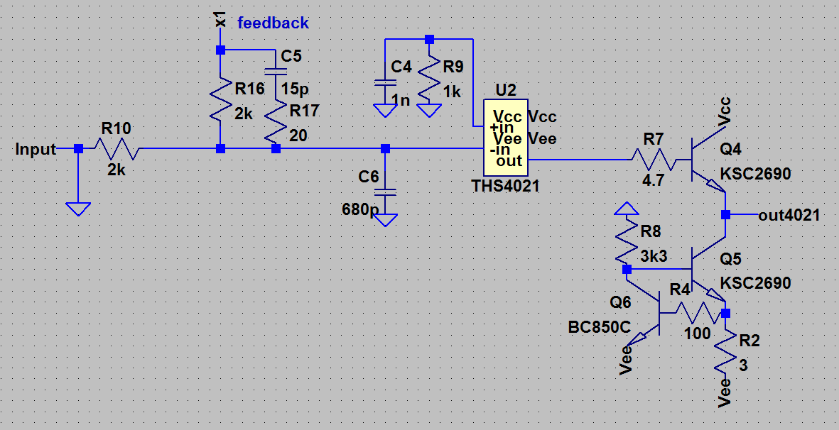

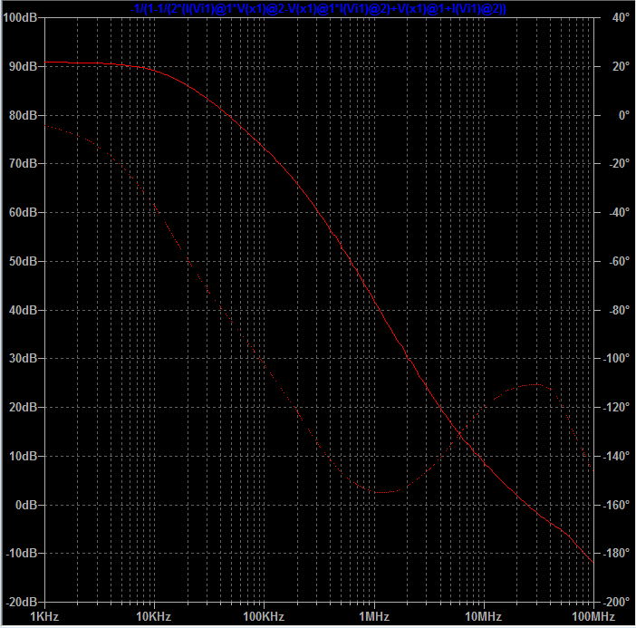

Why don't you try something like simple bruteforce?
Thanks for the links. The first TI paper is nice, and easy enough that I don't have to break my brain to read it. I will spend some time on it later.

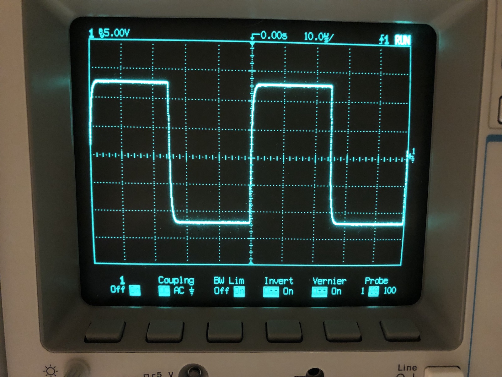

I got my amplifier back this evening and did a few quick tests. Everything looks good in general, with one issue (first picture). The input signal is a square wave at 20 kHz. Output level is about 15V pk-pk. Load resistance is 50 Ohms, and the volume control is full open. You can see there is some ringing on the falling edges. If you set the function generator level just right, the oscillation will continue for the duration of the negative part of the wave, and a little beyond.
The second picture shows the output with the volume control backed off one click. I turned up the signal generator so the amp was just below clipping, 24V pk-pk. Looks good.
The ultrasonic input filter bandwidth varies with the volume setting. Best-case bandwidth is over 1 MHz, so I can experiment with more aggressive input filtering. The amplifier will never have to contend with such severe overdrive in the real world, but it would be nice if it could handle it without overloading. I'll look into it in my copious free time.

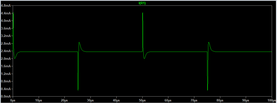

SPICE pretty accurately predicts the input stage overloading with a large enough square wave signal. It has to have a sharp edge. I didn't realize until last night that you need to specify the rise and fall times explicitly in LTspice, or it defaults to a very long/slow value.
The simulation shows that falling edges overload first as you turn up the input amplitude. It takes a little more signal level to overload on rising edges, which I also saw in my bench test. SPICE shows some overshoot, but not outright oscillation. That's not too surprising.
You can always overload the input stage if you drive it hard enough. I would like the amplifier to be protected from slewing when driven to clipping output level by a square wave, at all input volumes. It looks like increasing the input filter capacitor from 56pF to 100pF will do this.

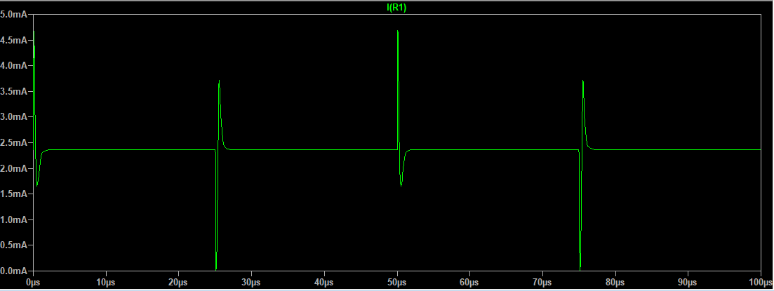

I agree. Under normal conditions, there's no overshoot, as shown in the second picture I posted earlier. I think the oscillation is due to TPC's narrow midband phase margin, and the amplifier loop gain dropping during overload. It seems to be one of the tradeoffs of TPC.

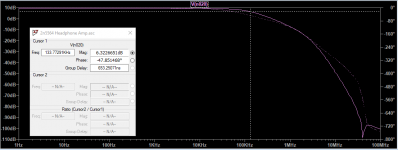

The first picture below shows the simulated current in the input transistor with the existing filter (3.3K/56pF) and a +-2.5V square wave input. You can see it's just cutting off on the falling edge. I'm impressed how closely the simulation matches the onset of instability in the real-world amplifier, though it might be a coincidence.
The second picture shows the same thing but with the capacitor increased to 120F. This is enough to keep the amplifier from overloading even if I then raise the input level to +-4V.
The third picture shows the worst-case bandwidth of 130 kHz with the 120pF capacitor and the volume control set to -6dB (effective series resistance 5K Ohms). I'm reminded of W. Marshall Leach's comment in his 1976 "Build a Low-TIM Amplifier" article:
For those who can psychologically accept an amplifier which is 3dB down at 50 kHz...

On further investigation in SPICE, it looks like the input overload margin can be improved a bit by increasing the capacitor across the 2K feedback resistor from 10pF to 33pF. The tradeoff is a little lower gain margin. The output inductor appears effective at preventing oscillation with a capacitor across the load resistor.
Edit: I think I'm going to call this design "done" and move onto other projects.
