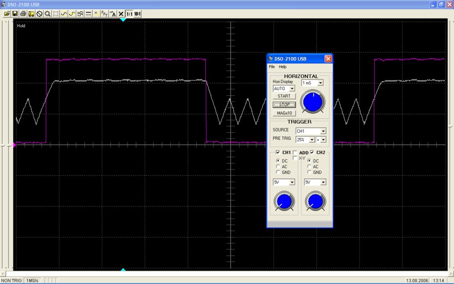

Heureca
Making sense now...
In fact was struggling with multiple flaws....
The silly one first:
...because things have been really strange, I changed the simplest
input connection with VSS conected to COM....
==> no improvement, but I found that CSD was nicely ramping triangular between both tresholds...
OK, in order to examine proper with my cheap scope, I changed the restart frequency. Means I speeded autorestart so that it is restarting within some hundred us. At the same time I applied low frequency input signals....
It became obvious that the upper MosFet was working without shut down.
White trace: Signal at CSD
Red Trace: IC output HO
Making sense now...

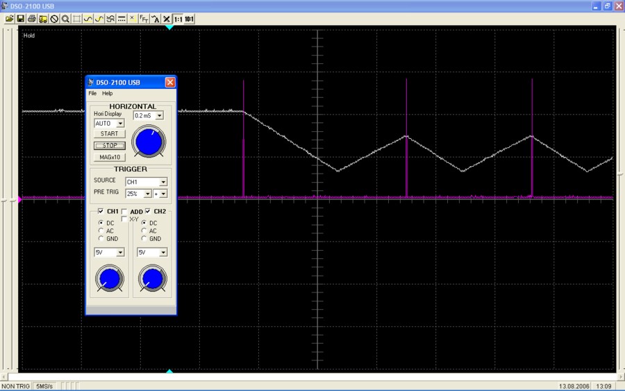

...hm, and what is LO doing?
With the resolution of the above pic: Nothing.
With slightly higher resolution: One single pulse of 1us length before every shut down.
So it is was definitely the shut down mechanism of the lower MosFet.
I rechecked the connections: fine
I measured the voltage between 8k2 and 1k2, which connected to OCSET: fine
I measured the voltage at OCSET: ...uhps!
Visually the connection was looking OK, but it had no electrical connection to the divider, but was floating close to zero. ...must have happened quite early, when I was playing around with various current limit levels...
White trace: CSD
Red trace: LO
White trace: CSD
Red trace: LO

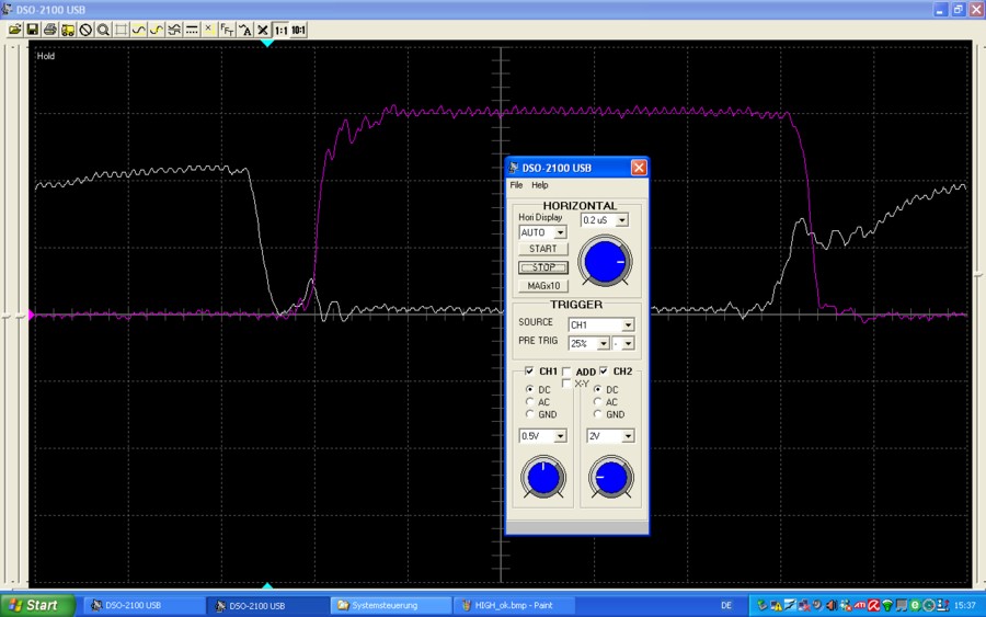

...what else was troubling me?
Thing were still OK, after reconnecting the MOSFETs, but after rewiring it to a halfbridge and applying rail voltages... Things were not so bad, but also not really good.
-Additional 100uF directly across the HB-rails: slight improvement.
-100nF directly across the IC from VSS to COM: big improvement.
...at frequencies above 150kHz the driver supllies became weak.
==> OK, offering more supply current and skipped the 12 Ohms in series of the boot strap diode...
This altogether AND the fast gate drive circuit are making things quite promising (...just neglecting the fact that the 1N4937 is to slow for this application and is getting overheated, when running at 500kHz).
Have a look to the output of the halfbridge and gate drive of the lower MosFet, when running at 500kHz. Not so bad.
White trace: Ugs of lower MOSFET, 5V/Div.
Red trace: Uds of lower MOSFET, 20/Div.

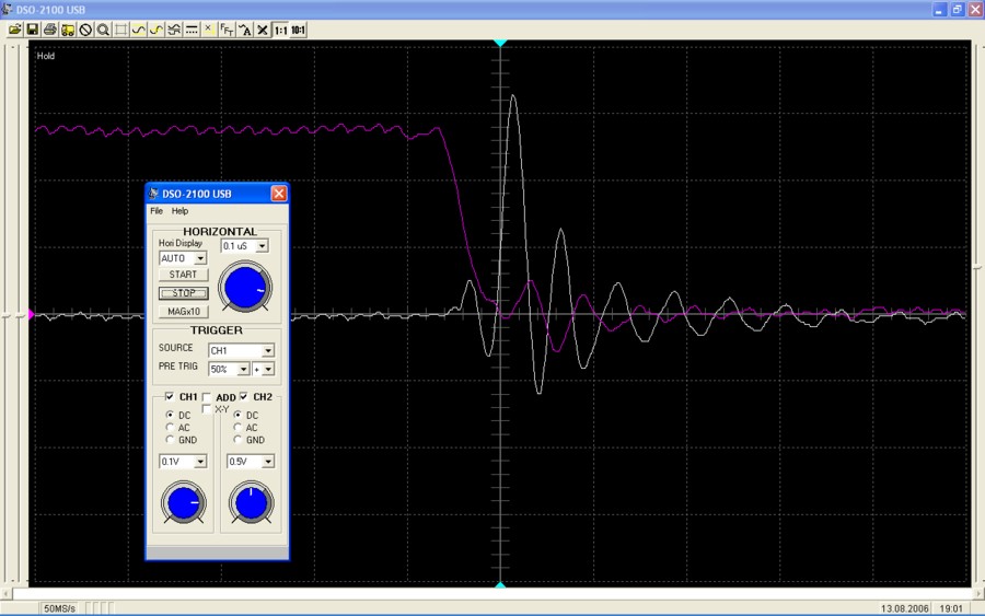

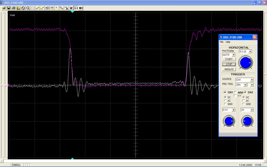

...yupp, optimzing the dead time, all suplies rails and may be the driver (hopefully not necessary to add much, but I will see...) will be my next steps.
Let's have a look to status quo. Some 2A/40ns current peaks in the wire between upper source and lower drain.
In fact this is not a proper measurement anymore, because taken with 50Ms. Means just two points for the peak. In fact the displayed magnitude is massively fluctuating, which also is indicating that my scope might miss something.... (But when I work with 100Ms, the triggering of that cheap scope is really annoying)
White trace: Current in the wire between both MosFets, 1A/grid
Red trace: Halfbridge output voltage, 20V/grid

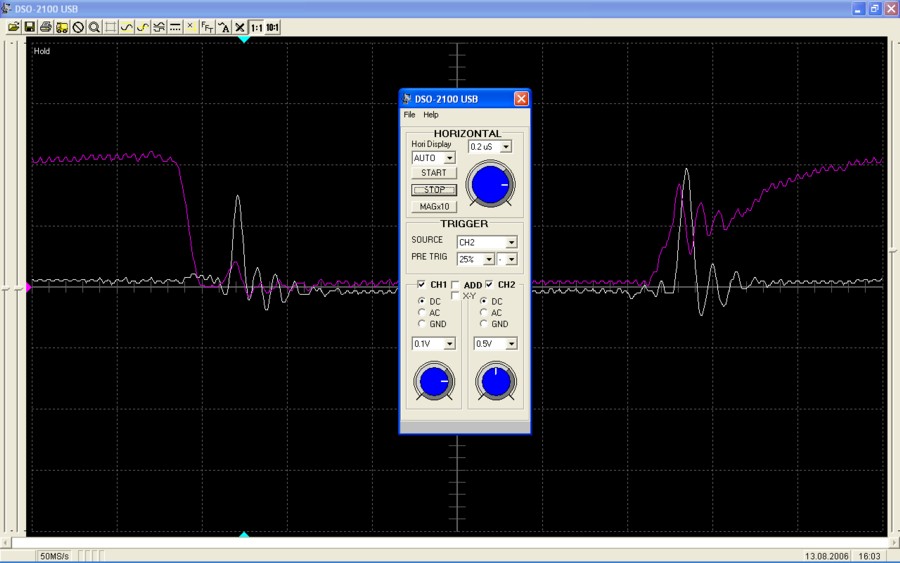

The peaks seem not to bee related to crossconduction.
There is something like 60ns real dead time, between finding the lower gate at zero and occurence of the peak.
... have to calculated/guess some Ixt area and parasitic capacitances if everything is matching together...
White trace: Current in the wire between both MosFets, 1A/Grid.
Red trace: Ugs of the lower MosFet: 5V/Grid.

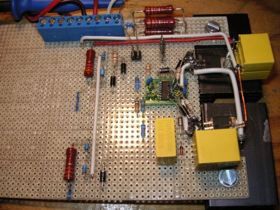

Markus, some of your solder connections look a little unwetted and blobby. That could be an indication of a cold joint and the reason why you had the bad connection. It's really tough to tell from a photo, but it looks like you could do well to leave the iron on for a few more seconds after the solder seems to melt. Also, when the surfaces to be joined are too oxidized, you may need supplemental flux either from a separate container or by applying excess solder until good wetting occurs. Of course, then you must remove (i.e., flick, wick, suck, etc.) the excess from the joint. Don't worry too much about time-related overheating with this method, because as long as new solder is being melted, phase change keeps the temperature steady.
Your photos and connections diagrams don't clearly detail how and if you separately route the output power connections from those nets common to the input circuits. You really want to avoid having high di/dts flow through shared signal lines. The power leads from the bench supplies should go only directly to the 2uF output capacitor leads with no stops in the signal/input section along the way. Connections to the small stuff should then come from these points. Actually, it's the minus supply routing that needs the most careful treatment. Ground for your board connections and measurements should ultimately come right from the plus lead of the 2uF capacitor stack by the low side MOSFET. The minus rail source for the board's layout should be the IC's COM pin.
Sorry for being pedantic, but have you verified the common mode integrity of your scope measurements? Check how much common mode noise your scope is picking up by momentarily moving the probe tip over to the supposed "ground" for the signal being measured. This is especially important for low level measurements (like current shunts). Common mode rejection can be improved by wrapping the probe cable several times through a large ferrite toroid (or clamp-on bead). Also, you may need to lose the probe ground wire/antenna and go to an on-board probe tip connector for the highest quality measurements. (By the way, how are you measuring current? If you are using some sort of current probe, does its delay differ from your voltage probes?)
You are wise to consider the reapplied dv/dt to a heavily recovering MOSFET body diode. I've seen otherwise outstandingly rated MOSFETs blow up at 10 percent of expected output power levels in a class-d application. IR devices are very conservatively specified in this regard, so, with those, you can go right up to (even a little past) the limit, IMO.
Rather than a simple gate driver diode, you might give the driver IC a break and discharge the MOSFET locally at its pins by using a Zetex style pnp BJT right on the MOSFET as an active pull down (its base-emitter is hooked up just like the diode with the "extra" collector pin soldered directly to the MOSFET source). This keeps the high discharge currents in a tight local loop.
Once you've got active discharge in place, it's easy to actively control peak dv/dt with very little impact on switching loss. For the simplest implementation, just add a series R-C in a very tight loop (minimal inductance is absolutely necessary to avoid making a multi-megahertz oscillator) right between the drain and gate pins of the MOSFET. The value of the "R" should be the same as the gate turn-on resistor and the value of the "C" should be about 2 or 3 times the MOSFET gate-drain capacitance measured at the level of the main supply voltage. The extra network is a true dv/dt limiter as it only steals enough drive to slow down dv/dt during fastest bit at the very end of the transistion.
Regards -- analogspiceman

YOU say my joints are looking blobby?!
Hey!!! They ARE blobby. But I hope they are wetted, at least for my eyes they are looking alike.

I am using the same scope set up as during my 1kW boost converter, where I measured the small signals (around 1V) across a shunt resistor. This boost converter in critical conduction mode was definitely the most crazy idea (Eva: I agree... continuos mode with magnetic snubber might be a better solution for such power). The MosFets are turning OFF 20A within less than 30ns and slope Ugs with a snubbered dv/dt of 7V/ns from zero to 500V... ugly environment for small signals. But the measurements were quite low noise. I am running my probe wires through high perm torroids from VAC. Vitroperm material. In my experiments this gave much better results than ferrite. Especially with regard to lock up effects of the USB scope....
My GND reference point for the scope was the source pin of the lower MosFet. If I connect scope GND and scope probe tip to this point, then I am getting something around 100mVp noise in the switching moment, which is acceptable for the Ugs measurement.
You are concerned about the remaining ringing of my Uds? 50% of this ringing is happening on the wire between upper source and lower drain. My postings show measurements at the lower drain. At the upper source is much less ringing, which is not surprising me. This wire is dealing with high di/dt. This di/dt will also run through the film caps and that wire inbetween, together probably making the other 50%...
For current measurement I am using a partially defect Tektronix P6021 (passive AC type, without delaying amp) .... Unfortunately I do not have any better test set up to check the timing relation between voltage and current than my half bridge.
