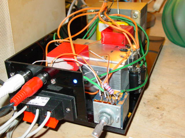

I have just completed a gainclone prototype using the LM1875 yesterday. This little baby working in inverting mode and the first impression to me is clean and tight bass, sweet highs but the mids is a bit cool (may be for me only ;) ).

this is my new little gainclone prototype
the LM1875 was mounted on a heatsink for Pentium 4. :)
The resistors in the signal path are all Holco. The one you see with color rings is for the LED and is removed already.
Coz I just got the Holco on hand and the feedback is 200K instead of 220K but the gain drop is no harm.
Since this is a prototype, all components are just from my toolbox. I have prepared the LM3875, Riken, Blackgate and ...... :D
ps, is there a big difference between different input coupling caps? like wima, kimber cap and the blackgate
cheers

mdlover, good one, and a good first prototype.
But let me give you a suggestion: put the PSU caps closer to the chip, it has long pins, you can cut them.
P-P is definitely not for me, I do smaller and tighter with breadboard.
Try the LM3875, you'll have a surprize.
