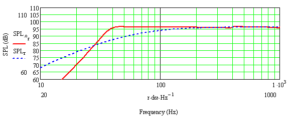

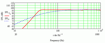

re:future versions - could Qes lowered without upsetting the mid-treble balance? - that could reduce some enclosure's bulk - my pc is so messed up that won't run WinISD - here's what AJ thinks of BetsyK in 84 liters - not sure of AJ is good for BR (it does BIB sims alright)

I'm not sure what might be good for BetsyK - a 1 CF sealed box converted to 3rd order with 350uF cap might work in some instances
Clark: Thanks for you well wishes. A few months ago I discovered your driver mounting screw/bolt torque advice. Prior to that, I cranked 'em down pretty tight. I'm not sure why barely-to-slightly snug sounds so much better, but I really appreciate the difference.
Freddi: BetsyK is a tough driver to fit with an enclosure. There is a reason I have more Betsys in stock! I think the simplest is a couple cu ft. sealed enclosure with a big, wide baffle placed close to room boundaries. BetsyK is really suited for bigger stuff. I haven't tried a Metronome, but it would be a cool option with a small footprint. Of course, BSC would be mandatory for most folks.
