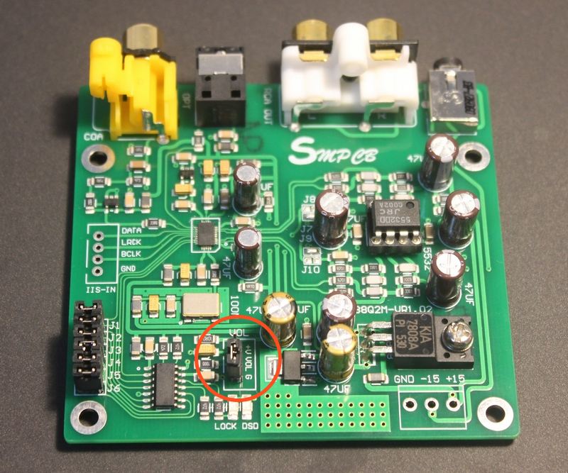

How do you handle digitial volume control:
- encoder
- buttons
or
analog 10k pot dividing voltage between 3.3V and GND, then your controller by sensing this divided voltage sends I2C command to DAC?
I personally prefer the last mentioned solution because it gives you analog feeling of volume control while being digital in background, moreover I always know what volume level I have when turning on the DAC.

Esssabre does the volume control by manipulating the data in 32 bit. Its the only digital volume control thats almost as good as analog.
Yes I do understand that. To increase/decrease volume the I2C command will be send to es9038q2m.
My question however was how me as a user I will control that? Encoder, regular pot or volume control in Volumio?
Perhaps a regular pot as it is on this ES9038Q2M board (instead of a jumper, a pot is placed)
Yeap. I got this dac. Out of the box is so so, but with improved powering and passive summing with LL1684 transformers it really sounds great!!!
In my setup It is connected to hifiberry digi+ pro directelly through I2S.
And yes you connect 10k analog pot to control digital volume. I am using this board like that and it is great! It gives you analog feeling with volume control, the pot does not have to be of high quality, just regular pot. One could also use motorized pot to control it remotely.
I hope allo comes with same solution in regard of volume control.
