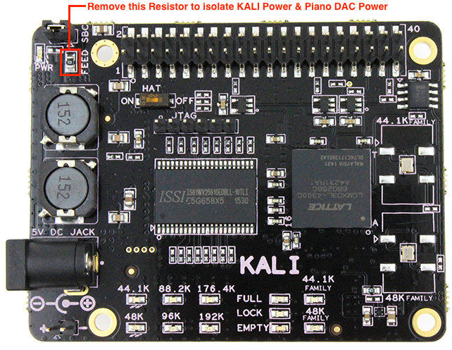

I've had a trawl through this thread and looked at the Allo data sheet, but I can't see an easy way of getting an external power supply into the Piano. I'm guessing J19 for the Volt could be used to take isolated 5v in. Has anyone found a neat solution to block 5V through the 40 pin connector from the Pi or Kali below so isolated power can be used?
Simon,
Sorry, I just saw your post. I checked with Allo on this awhile back and they didn't give me an easy way (not to say there isn't one) to separate the the Piano's power from the feeding board. BUT since I was using it on a Kali, they did suggest that I remove a 0R resistor there and the Kali would not be feeding the 5V to the Piano.
I did that and then fed the Piano via the GPIO 5V/Grnd pins.
If you are interested, I can dig that information up.
BTW, that was a significant improvement, though it still sounds very good being fed power from the Kali. I haven't recently tried it direct on an RPi, I was not too impressed with it that way. BUT on a Kali and especially with one of the isolators, it is very good!
Greg in Mississippi

@Greg
Do you have a pic showing the location of said 0R resistor on Kali please?
John
Attached is the diagram I got from Allo.
Once you remove that resistor on the Kali, it does not pass 5V up to the next board.

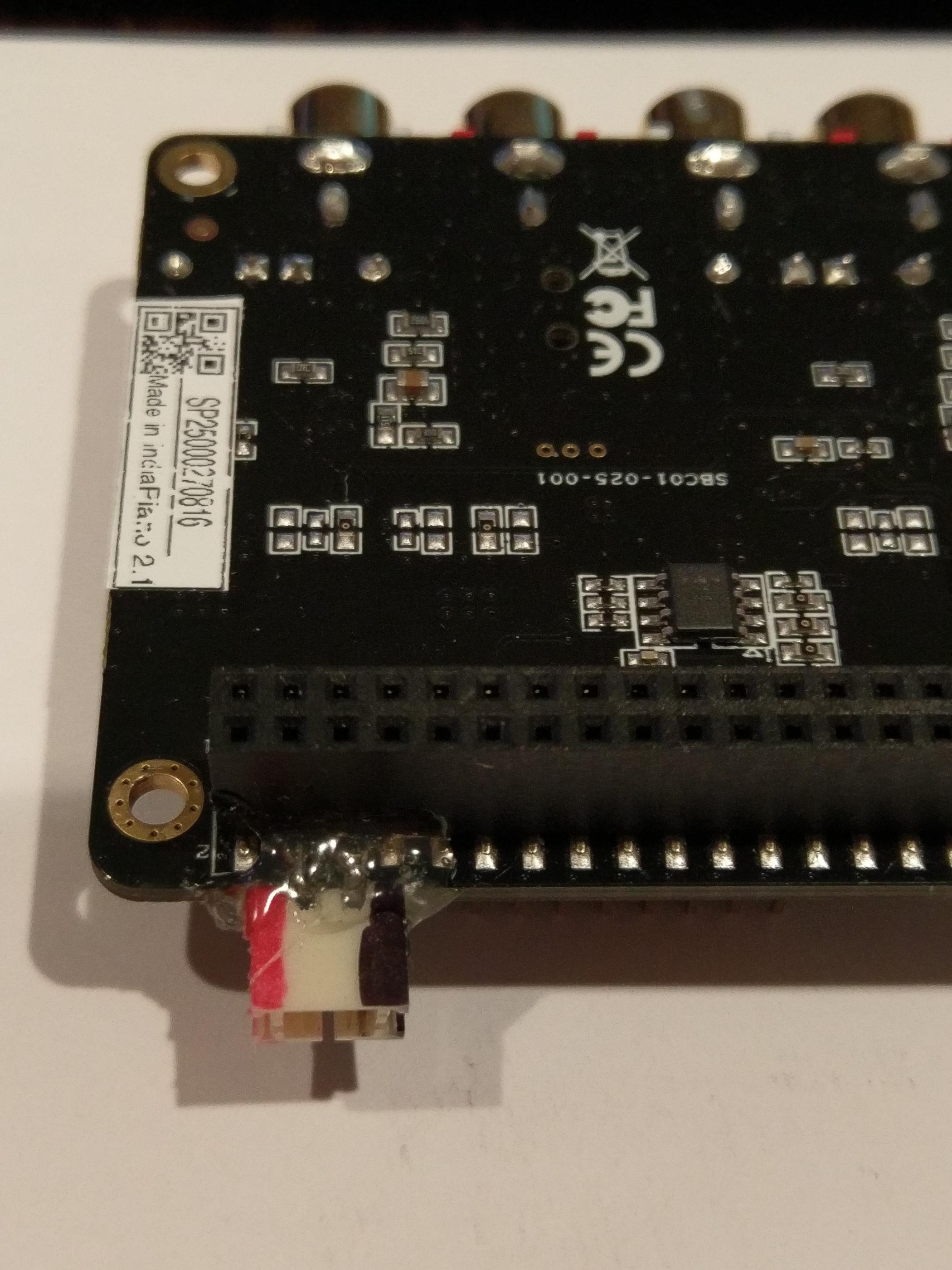

For the Piano 2.1, you can most easily use the 5V & Ground header pins.
I used the 5V & Ground pins on the expansion header down to the Kali (2nd picture).
I hope this helps!
Greg in Mississippi
P.S. I have found the people at Allo to be amazingly helpful and accommodating. I'm not saying this to dis anyone, but just to acknowledge them!
I hope this helps!
Greg in Mississippi
Thank you Greg! ....and Allo
