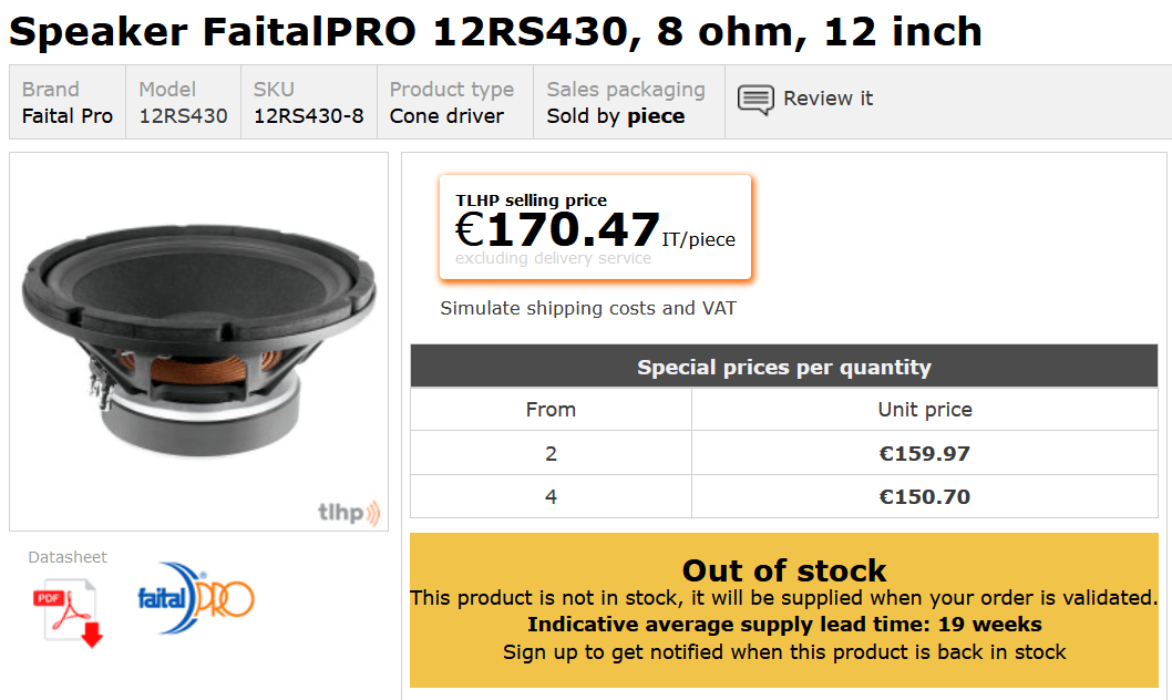

This driver is still very new, I also haven't found a store where it is available yet. I hope Faital Pro does not overdo it with the price....😬Are there mentions of price out there? Checked USSpeaker and TLHP from France but not yet listed.

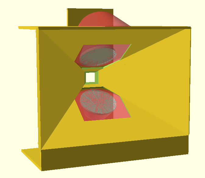

Multiple Entry Horn, like Unity or Synergy. I am just building a large one with 8" for mids and 18" for bass. Two of these (or maybe even one for lower levels) should be able to replace the 18" I am using. https://www.diyaudio.com/community/...h-1-4-cd-3d-print-and-cnc.383396/post-7205135
It would be a part of the horn - it is ca 92 x 75 x 40 cm and roughly 150 l (IIRC) of volume available for the bass drivers - but instead of being mounted from the bottom (as the 18" in the picture), they could be mounted on the sides instead. The red cone is to show the size of the 18", the grey one is 8" - for clarity shown without the exchangeable plates for testing various entry port arrangements.

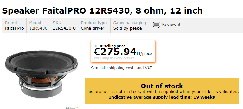

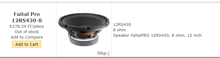

Strange....:More expensive after I logged in:
