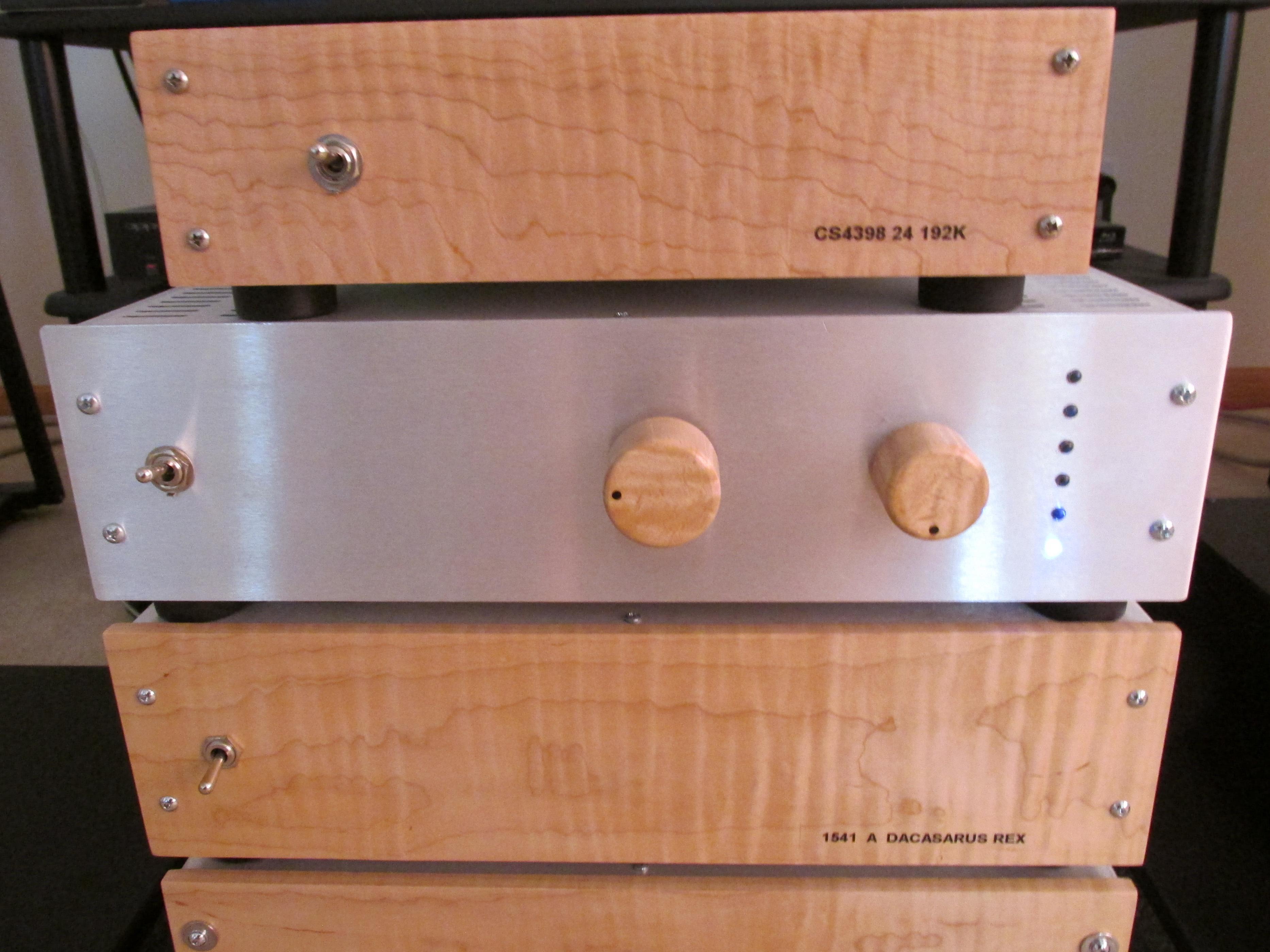

Just sharing my latest build. It is a Nelson Pass BA-3 (Burning Amp 3). Features 6 stereo inputs. Goldpoint 24 position attenuator. Jung Didden Super regulators for each channel. :D Face plates and knobs subject to change. It is an improvement over my BA-3 (ASM) Audio Society of Minnesota build 2 years ago.

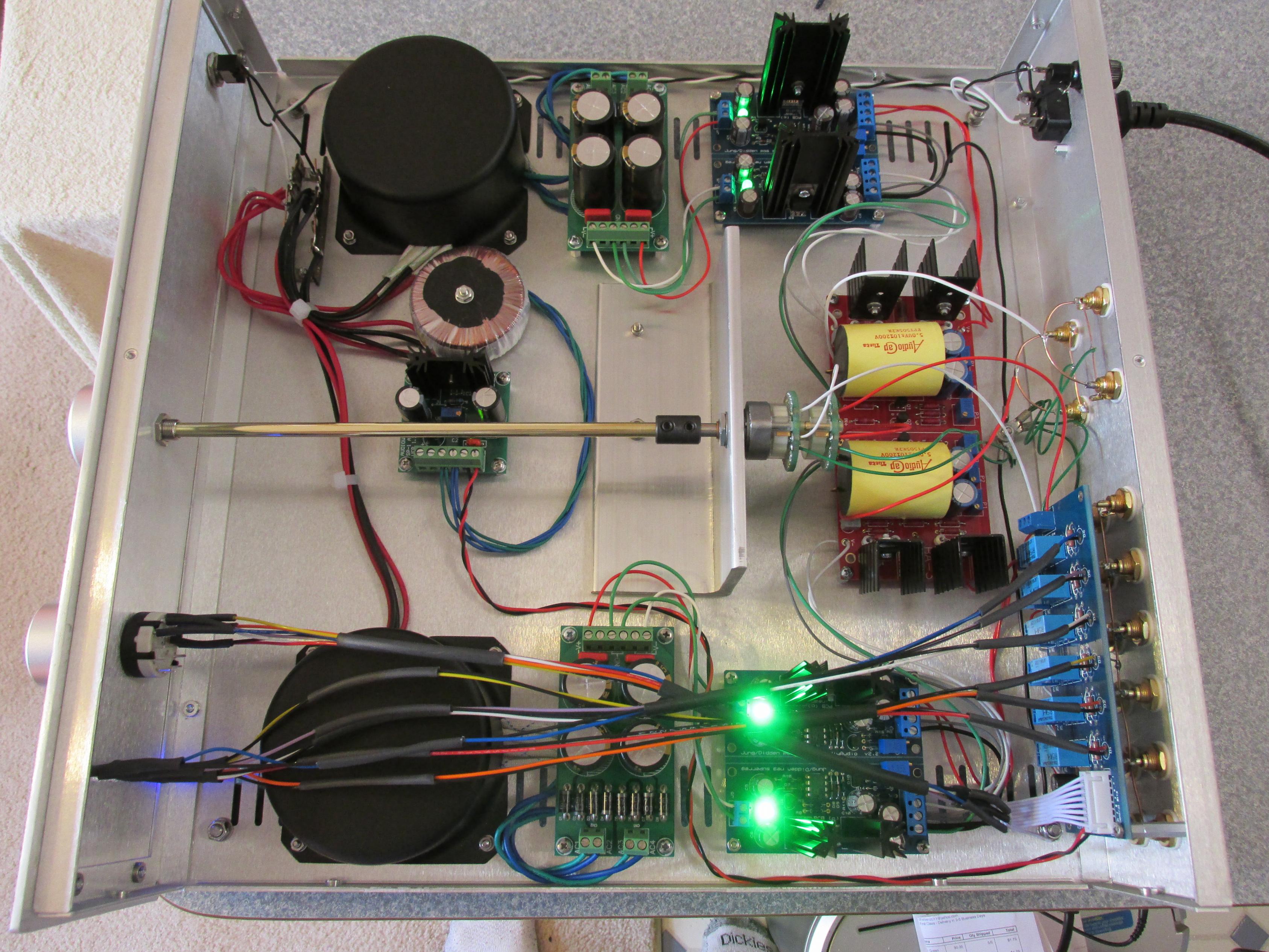

Clarify what I mean by dual mono
So each channel has it's own power supply independent of the other. No shared power transformer, regulator or raw supply. The channels share just a common star ground. The stereo input relay board has it's own power supply to operate the relays. I am using it in "stereo mode" as I am feeding it left and right signals. Should have excellent performance as far as cross talk goes. :devily:

Might be worth investigating using separated audio grounds for the two channels, with a pair of separate Disconnecting Networks to connect each channel to the Chassis.
This would overcome the common problem of introducing a ground loop when feeding a stereo (or dual mono) power amplifier.

Thanks for the comment. Actually that is a really great idea. I'll have to investigate what sort of network to use. So far it is dead quiet. I really enjoy the clarity and imaging on good recordings. The Goldpoint attenuator is superb. :)

Hi Marra, This Nelson Pass BA-3 is built per his schematic. So I think that is 25 db gain. The devices "JFET's" are a matched quad and matched to 0.1 mA. They were also within Nelson's current specification for the design around 7 mA. If you can "get" well matched JFET's. I found no need for a balance control. I do have gain adjustments on the Class D amplifier, so I am covered just in case. You should get awesome results with the Salas regulators. The Antek power transformers I used are very cost effective so I decided to use separate transformers. Separate winding will be just as good. My regulated rails are at + and - 22.5 VDC. This design benefits from a good volume control. I find the Goldpoint to be very transparent. No real coloration. I have ordered a set of Curly Maple knobs and plan to leave the brushed Aluminum front plate. Please share your build and any thoughts on it I'd love to see it. ;)

Do I understand the first picture correctly in that you are using parallel outputs from the BA-3? Are you able to drive two amps simultaneously without issue?

Hi Ryan, I do have a double pair of RCA connectors for the output. I plan to use the second set for a subwoofer amplifier. On my ASM build this worked fine although it depends largely on the input impedance and cable length. At one time I had dedicated left and right subs. My Maggie MG2.5R's are just a little to tough to match. At least with cheap ported subs. Just to slow. Thinking about a Rythmic F15HP sealed sub next time around. So yes if the input impedance is at least 50 K Ohms on both amps it should work OK. I detected no loss of fidelity or loading effects. Thanks for the question, Dave

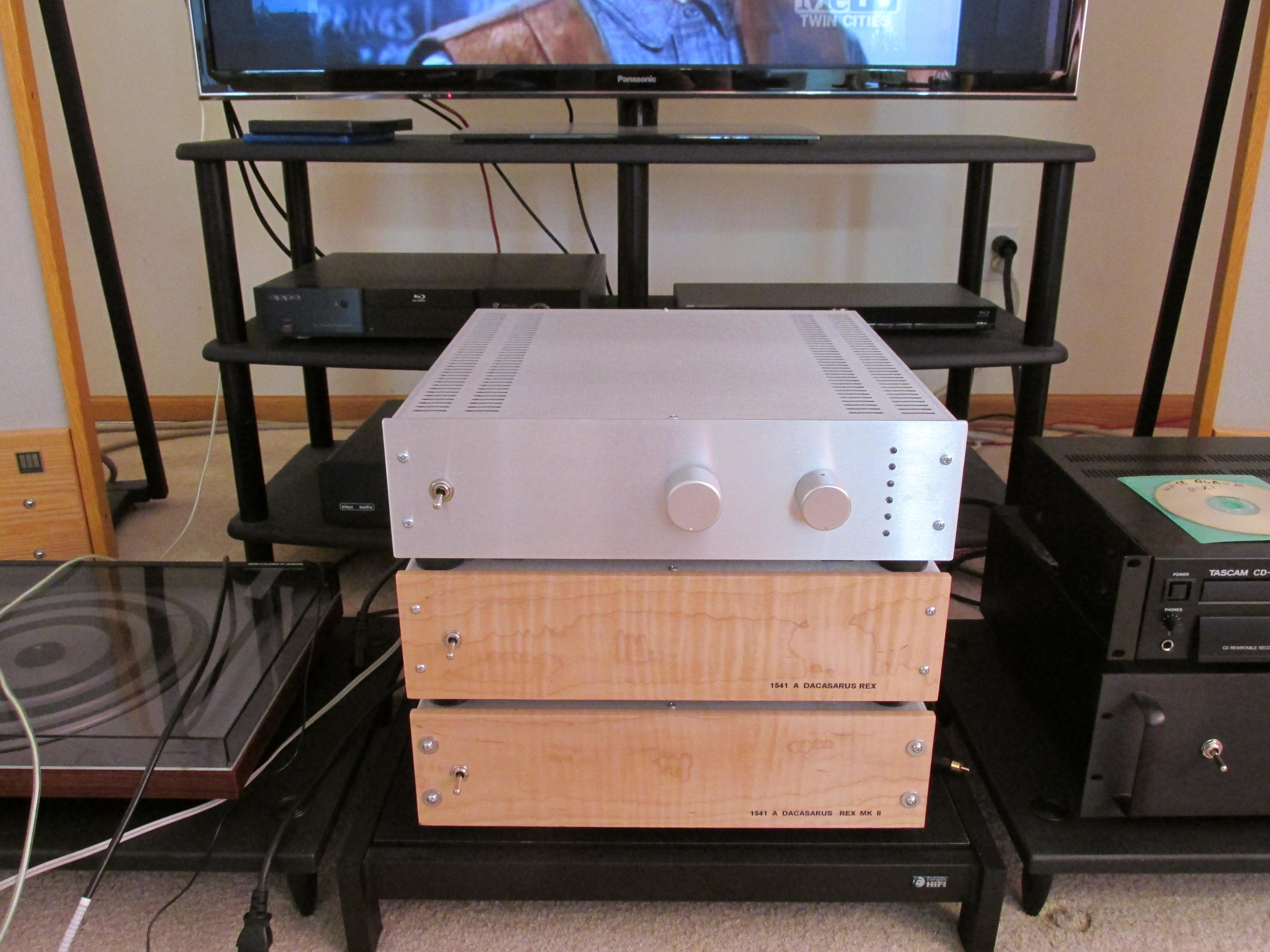

Hi Torchwood; my BA3 pre is up and running all be it with a single transformer at the moment. I went with 220R for R13 as I don't think that I need 30db of gain.Sounding good so far but only a few hours of listening.

Hi Marra, Enjoyed the pictures. A very nice build. I have around 200-300 Hours now on mine. Just love it. P3 is centered. No plan to adjust this one. Love the pin point imaging on good recordings. :D

Hi Jean, I used this one. Hope the link works.... Input Selector 6CH Kit (6-to-1 Way Stereo)_Input Selector_Accessories Kit_Analog Metric - DIY Audio Kit Got mine from them via the big auction site. You can also buy direct. It comes with a 5 VDC regulator on board. Needs +8 VDC. The circuit was perfect, I added 2 small Polypropylene capacitors at the electrolytic's. It comes with all the parts ready to assemble. My LED's are mounted at the front panel and I made a cable assembly. 4 inputs wasn't enough for me, 6 is perfect. ;)
