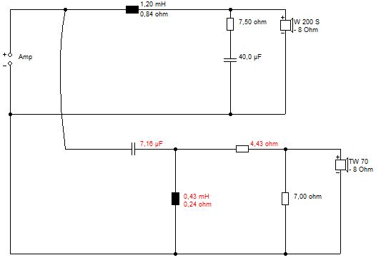

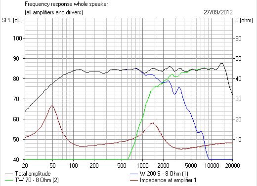

With the bass Zobel it is a 6.8uF/0.4mH/4.7R treble crossover. Without the bass Zobel, it is 3.3uF/0.4mH/4.7R. 30-60 litres as explained at Visaton for the W200S/8ohm. You can model it in Visaton's free Boxsim program download, even change the tweeter for a 94 or 104mm type.

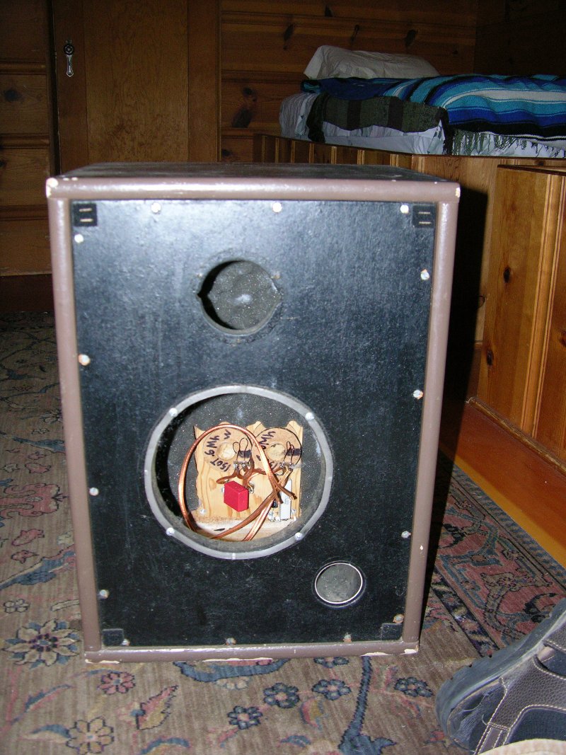

I took a picture of my enclosures... not the best pic, but I was in a hurry) The front plate is removable (mounts to "cleats" inside the box) so I could make another one if needed, but I'd rather keep them "as is". I do understand that it's nice to cross a 2-way at lower freq (like 1000 hz) but should I use first order (6db/oct) or second order (12db/oct)? Didn't have time to study "la scala" crossover... will study it later. Hey, can someone tell me metric equivalent to 1.5 cu ft?

Dissi, thank you for the suggestion (and crossover)

I've been looking at tweeters (mostly dome) and several have smaller mounting size, so I will have to add an "adapter plate" to my 3 inch cutout. Should I put this on front or behind cutout? If behind, should I flair the cutout? I like the idea of the tweeter being recessed a bit. What about cutting the end off a flaired port and adding this as a sort of horn to front of tweeter (would also look nice, but that's not my main goal) I'm not after perfection... but want to avoid any major issues. Maybe just choose a horn loaded dome that fits my cutout?

Nobody answered my question about mounting tweeter in front or behind front baffle. The homemade "horn" idea was only concerning mounting the tweeter behind baffle (5/8 inch thick) At the very least, I would flare/round the existing cutout (3 inch dia) to avoid issues. Should I just choose a tweeter that fits the original cutout, or choose one according to what works best with the woofer and crossover, even if it has smaller mounting size (and requires adapter plate)?
