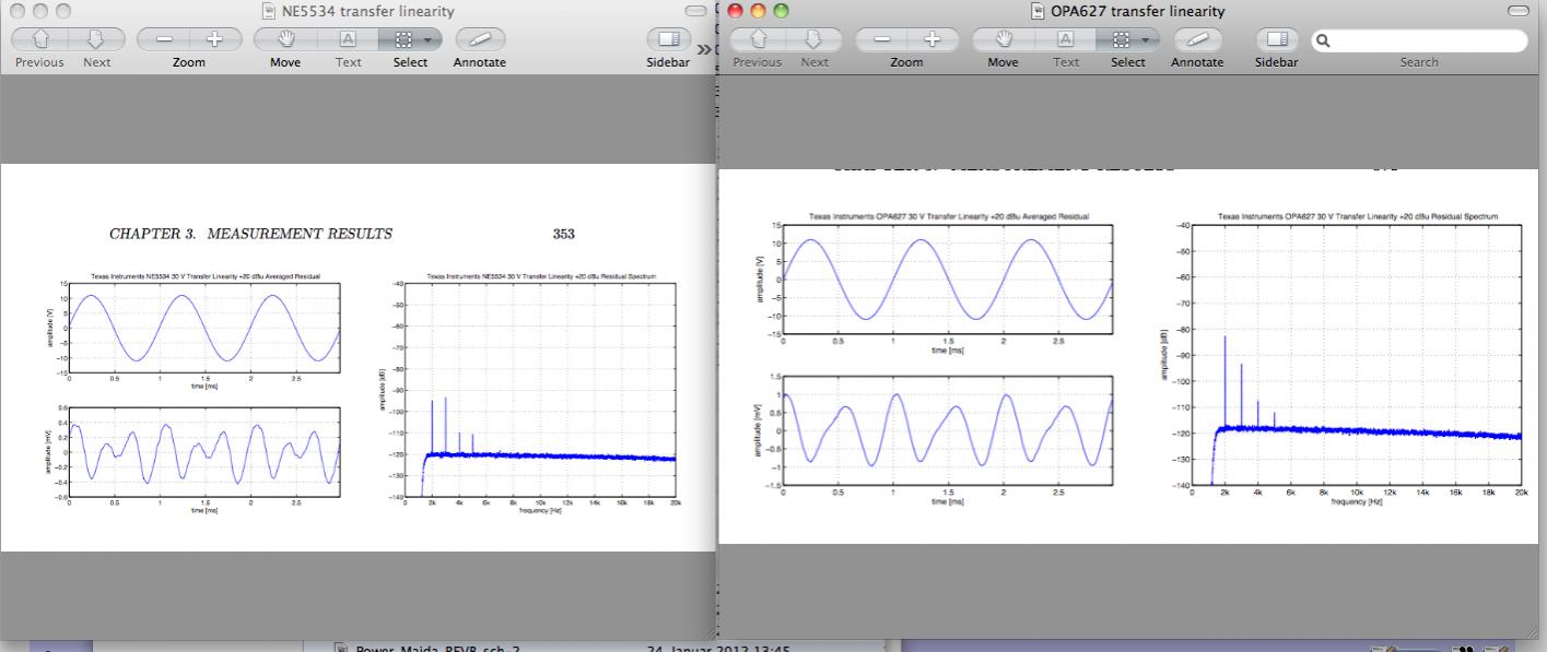

The OPA627 has no valuable spice model , at least the ones at my disposal,
and does not produce realistic figures since in the sames conditions
it yield zero HD , wich is a joke , since many use this very model
to make spice sims that will indeed produce great but completely
false results.
You should be aware that it s in inverting mode and in such a configuration,
dont expect a OPA627 to beat the ancestor.
This graph was posted by there by Gerhard :
