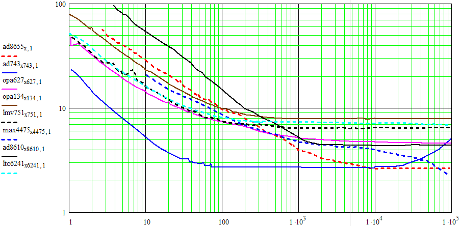

recent monolithic fet op amp noise still isn't definitively ahead of OPA627 or AD743
but if you can deal with surface mount parts there are substantial improvements in most other parameters available in the last decade's newer op amps
there are a handful of devices aimed at OPA627 replacement
and a fairly low noise, not as costly OP164x series
for some audio applications A weighting makes low frequency noise performance less important
then there are also some CMOS possibilities
probably needs updating but I tried plotting a few fet and cmos op amp noise together:
http://www.diyaudio.com/forums/solid-state/68793-new-interesting-cmos-op-amps-2.html#post843381
Jcx,
Graphs, I love those..... The AD743 looks to be the clear winner on that graph. I know about those on the sonic side, to easy to fudge a frequency response plot by just changing the pen plotter paper feed rate or the pen response. I am not saying you did that, just saying I have seen that many times on response plots that look so nice and smooth and then you do that yourself and see all the information come out that was just rounded out. Nothing like a good waterfall plot on a driver with a good laboratory response microphone. I'll take a look at that AD chip.
