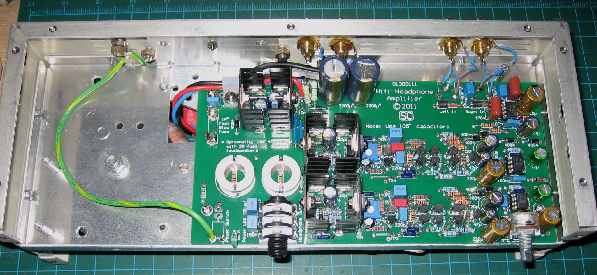

I was thinking Bob Cordell's concern over low Z would not be as much concern in this design as it uses 10k pots, but perhaps it holds for this design too without the paralleled opamps.
Interesting you didn't use the Baxandall gain control - perhaps that's what I'm hearing...
I used high quality sockets as it's a DSPT board and I thought I might try different 5532 brands out of curiosity and maybe others like the '4562. Do you think they're bad news?

Hi owdeo,
I am not familiar with this earlier version of the pre, but even without the paralled op amps it might be a relatively low-impedance design. If so, you may be hearing the 5532s struggling to drive a relatively low-impedance load and being called upon to deliver substantial current to the load. Such a situation drives the quasi-complementary 5532 output stage deeply into class B operation. Also, such operation may cause significant output stage power dissipation and consequent junction temperature variations with signal. In some cases this may lead to some form of memory distortion. There will also be some overall die temperature variations in such a situation. I admit, this is speculation on my part, especially given that I don't know the impedances involved.
The 5532/4 does seem to have a reputation of measuring better than it sounds. I do not use them in the signal path.
The Baxandall volumen control is an incredibly clever circuit that does a lot for you and solves or mitigates some classical volume control problems. Who knows, however, there may be some things about it that we do not fully understand that influence how it sounds.
Finally, be mindful that your prior preamp may be affecting the sound in a non-perfectly-neutral way that you have gotten used to or just happen to like.

Thanks for your helpfull advice Bob. The '96 design uses the same output stage configuration as the 2012 preamp but without the paralleled opamps - there is just one set (eg IC5A and IC5B) and the pot value is 10k instead of 1k. The maximum-gain-setting resistors are 680R (R21) and 4k7 (R53) as the gain structure is designed for lower-level inputs than the current design.
I would have thought this should be less of a concern given the pot is 10 times the value even though the opamp drive capability is 1/4 in relation to the current design. If I understand your previous post correctly this potential problem should be at its worst when the gain is set near minimum? As the CD input has a 16dB resistive attenuator I can check this easily by plugging the CD player into one of the other line level inputs and comparing the result. With the CD input the gain will be set quite high but with any other input it will need to be quite low. I will have to try and measure the pot positions that give exactly the same output level though.... I'll try this and report back.
True and I did consider this, but as I have several other preamps of very different design and the aspect of SQ I'm unhappy about applies when compared to any of them, I don't think this is the case. I attend plenty of acoustic concerts and also play an instrument so I think I at least try to give my subjective judgements a reference to the real thing as much as possible!
To exaggerate it's as though the music is being strangled and is somehow constrained, the sense of music flowing freely is somehow reduced.

Hold on guys - I've just replaced the 6 Fairchild 5532s in the main signal path with On Semi NE5532ANs. MUCH better, I just cannot believe how different it sounds. The mid and treble is completely cleaned up and instruments have air around them and sound tonally correct. And luckily the bass still kicks you-know-what too.
The sound is still slightly "tight" or "overdamped" or something, but on many recordings this works just fine. Most of what was bugging me about the sound has now gone.
I know this is crazy but it seems 5532s are not 5532s and the brand is very important. I originally bought Farichilds as Elektor published some test results showing that these had the lowest THD overall. But I since came across this site:
