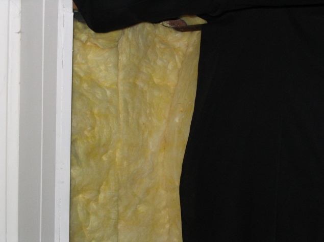

It doesn't have to be expensive- I think that a roll of fiberglass batting would work fine. You could tack up strips of it, and cover it in cloth. I think you can get a roll for around $15, and that might be enough for the closet. I haven't purchased it before, so I don't know how much is on a roll. Anyway, it's very fire resistant compared to foams and synthetic fibers, so that's good.

i want to be sure we are talking about the same thing. I am talking about fiberglass insulation, it comes in rolls and is purchased at big box stores.
and then put fabric over that? How would that differ from putting that up and then putting up drywall?
That's the stuff, but you DON't want the paper backing facing the room. You've got to be careful about the dust, and you want to make sure you contain it so that the dust doesn't get you or your room.
The difference is that the sound is free to go *into* the fibers, whereas most of it would normally just bounce off the drywall before it got to the fiberglass.
If you search around, a lot of folks have lined their subwoofers and bass cabinets with this stuff.
I guess I should warn you to take this advice with a grain of salt. I haven't actually used this stuff for room treatment. For that matter, I haven't really been able to negotiate room treatment with my girlfriend- I was lucky to be able to get the speakers I wanted where I wanted them! Still, this stuff looks a lot cheaper per square foot than acoustic foam
Again, and I was serious- do you camp? Good sleeping bags should always be left flat or hanging (not stuffed in their compression bags) in order to maintain their fluffiness and warmth. If you already own a couple of sleeping bags, this looks like a great place to store them, and then you're only out the cost of a couple of wall hooks! It might not be the *most* effective, but when you're on a budget you sometimes need to try a few things while you're looking for serendipity.

I have seen alot of people using that, so I will put it in with the fiberglass showing, and then put some black fabric over that should I put the fabric tight? or loose? part of me thinks hanging it nice and loose with lots of folds will not only look nice, but help to trap even more sound pressure, also it will have the added benefit of a better solution to hide the exposed insulation (as that stuff isn't exactly what you want people to have to see alot of)
joe carrow said:Again, and I was serious- do you camp? Good sleeping bags should always be left flat or hanging (not stuffed in their compression bags) in order to maintain their fluffiness and warmth. If you already own a couple of sleeping bags, this looks like a great place to store them, and then you're only out the cost of a couple of wall hooks! It might not be the *most* effective, but when you're on a budget you sometimes need to try a few things while you're looking for serendipity. [/B]
yes I do camp, and yes i have sleeping bags, and it's not a terrible idea, but i don't think I have enough sleeping bags to cover up the entire area.
and finally, I think i have decided to go with the modula MT's, I am not sure if they will have the SPL's that I am looking for, however I fell that given my budget and desire for high quality sound they are the best of a sacrifice. If they end up sounding nice, but not being loud enough, I can always go ahead and upgrade to the Natalie P's or Modula MTM's and just move the MT's to surrond duty...
What you do with the cloth fabric is up to you- just so long as the fiberglass is free to be fluffy so that it can soak up the sound, it shouldn't matter if the cloth in front of it is tight or draped.

by the end of this week, I will have the closet redone, my intenion is to insulate all the walls. I am going to glue the paper side of paper backed housing insulation to the walls, to fully insulate the closet, and then over that I am going to drape black fabric to hide the insulation. Is that safe?

About the insulation- it sounds safe, just be careful with the dust from the fiberglass. Glasses, a cheap mask, and gloves could save you some irritation.

as for the safety, im not worried about me working with it, more im worried about others long term. Basically im going to have exposed fiberglass insulation that is covered with thin fabric. I wondered if that was safe.

I think that as long as you have some cloth as fine as a bedsheet tacked all the way around the border, you should be fine. The stuff isn't too volatile as long as it's not being handled, and there's nothing blowing directly on it like an air conditioner.
The old acoustic panels in my high school band room were full of this kind of fiberglass. Of course, it was built in the 60s/70s, and portions of our school were shut down in the 90s for asbestos abatement... but they never replaced those acoustic panels, so they couldn't have been that bad. They just had screens like home windows, no fancy cloth.

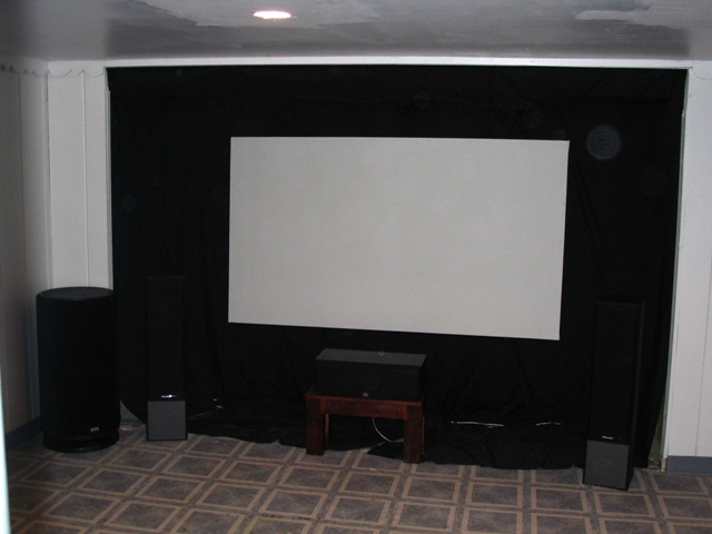

***update***
So I finished rebuilding the closet. I have not started building the speakers yet, but I did go ahead and reuse what I have. The front consists of a SVS 25-31 passive subwoofer on the left. The left and right channels are cheap Pioneer 3 ways and the center channel a JBL EC35 center channel. The sitting position is approx. 11 feet from the speakers and about 13' from the screen. The screen is a 90" diagonal and the projector is an infocus 4805 (480p) projector.
here is a picture of it completed. The walls still need to be painted, and I have some very red fabric that will create a curtain appearence and that will be installed this week.
