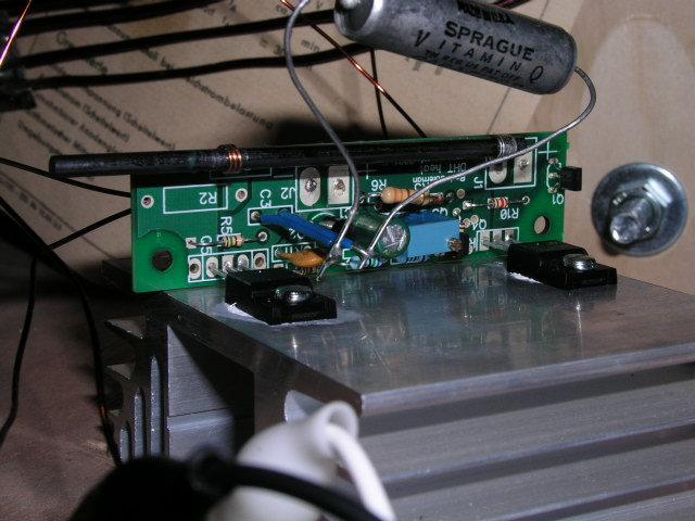

There is no need for you to re-invent the wheel. I am a coil winder and have experimented with the most insane solutions, go back several pages and just read what I've done here...
I have listened to anything you could imagine of. Rod's circuit gave me something else but not perfect. With this simple mod it surpassed all my expectations.
Do not lose your time but only if you would like to experiment different flavors. If you want to go to the end, there is no reason to lose your time.
I've already done it for you...

Firstly I’d like to praise Rod’s filament heater supplies. I’m using 300B version in a couple of SE amps, and there are unbelievably good. I went from an unregulated dc supply, then tried some dedicated CCS regs from DIY HiFi Supply- much better than the dc supply- to Rod’s circuit. There’s nothing subtle about the improvement they bring, and, if you can accommodate them you should! (You should also try his shunt cascode driver topology, which, if anything, is even more amazing- but I digress.)
Secondly, I’m quite open to the idea that changing the MOX resistor in the regulator for a carbon type. Generic carbon film resistors sound much better generic metal films IMO (unless high tolerance is a circuit requirement), despite many theoretical reasons for the reverse to be true.
But I’m a bit confused about the graphite rod business. I’ve done a bit of research, and it seems we’re dealing with two different materials. Graphite rods (for electrolysis etc) seem to be made solely from graphite, which is compressed into a rod-

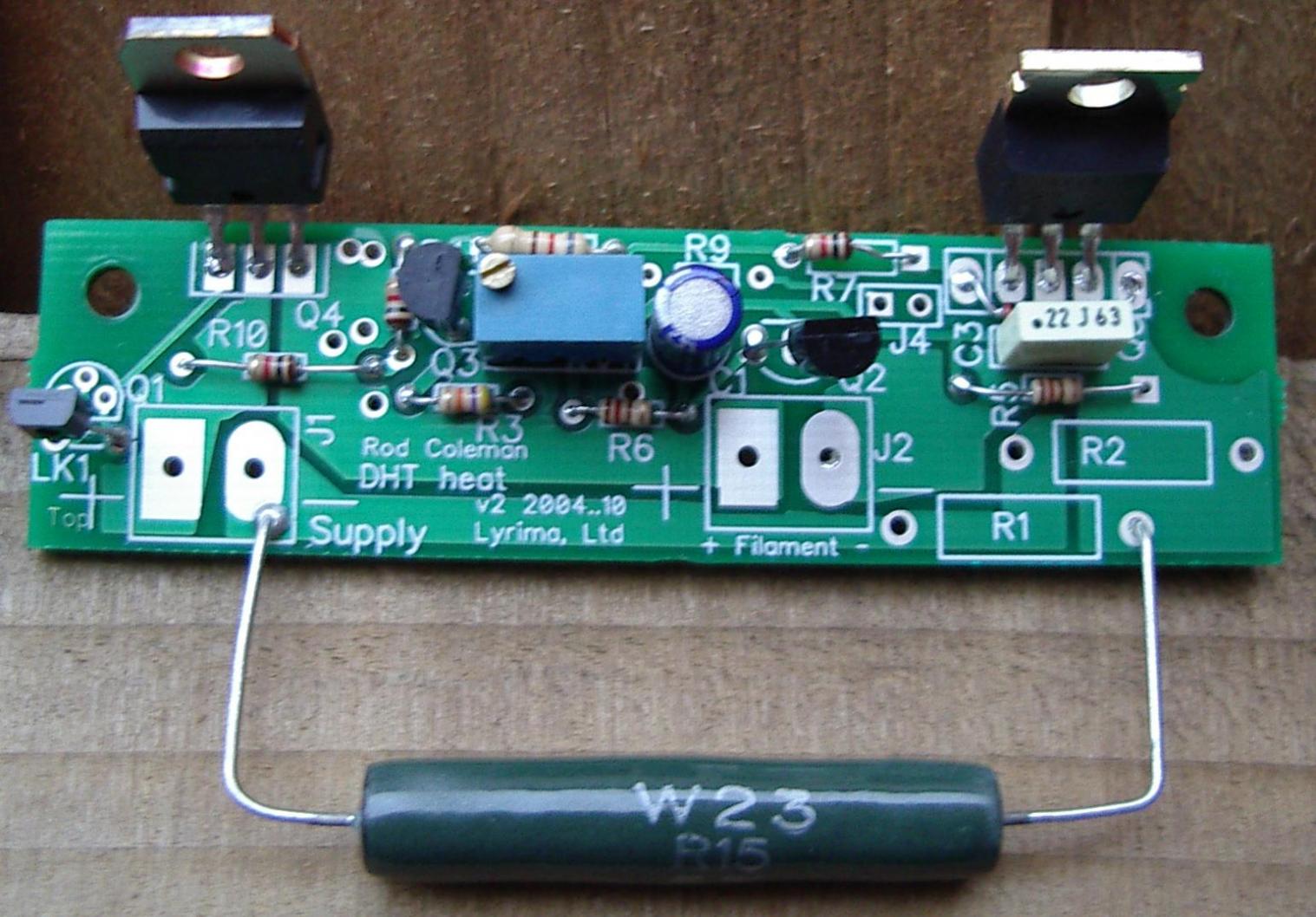

The R1 current sense resistor in the Filament Regulator Kits is a Wirewound - 0,82 for 300B. This value is not critical, since the trimmer is there to accommodate differences.
Please note that the Wirewound I supply is FLAMEPROOF, that's to say that it won't set fire to anything even if you short the whole regulator out or something similar. The action of the regulator prevents short circuits, so this is a vanishingly unlikely event, but please be warned.

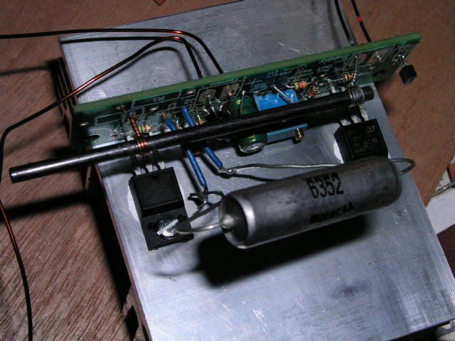

about 30 minutes ago I set up a 300B regulator with 2x 1,5-ohm carbon film 1W resistors. RS 7078558. They are notable straight away for running very cool, even at 1,3A (about 0,6W each). I'll run them steady for a while, then look at the noise, and maybe try them in my 300B-SE amp.
If you want to try Carbon comp, then the low-cost way to go is Farnell 0,5W 6,8-ohm - parallel 8 pcs. These are only about 10p (~6 cents) a copy.
I think that the challenge with Carbon/graphite rods will be the lead-attach. We need a good grip, but without shattering the rod. Preforming on an undersized rod might be one route.
For experimenters wanting to try out the Carbon Rod-type resistor, please note that the current-sense resistor R1 has alternative mounting points to accommodate LONG resistors, up to 45mm, or even more. The picture shows a 75TL regulator (6,25A) sporting the Welwyn W23 at R1.

The board is also configurable to work with indirectly heated tubes - which is useful when you are working at low levels or RIAA stages etc. Each heater can be independently adjusted - so you could experiment with fine-tuning the heater voltage in first-stage amplifiers with 6Ж32П (6J32P) or EF86 or 6BS7 etc. These can sometimes be improved in noise (and sound) with the heaters reduced to 5.0V or 5.5V.
The cathode CCS can be used for differential stages, and B+ divider resistors & capacitor positions are provided on the board - so that raising the heaters to +30 or +50V is easy.
