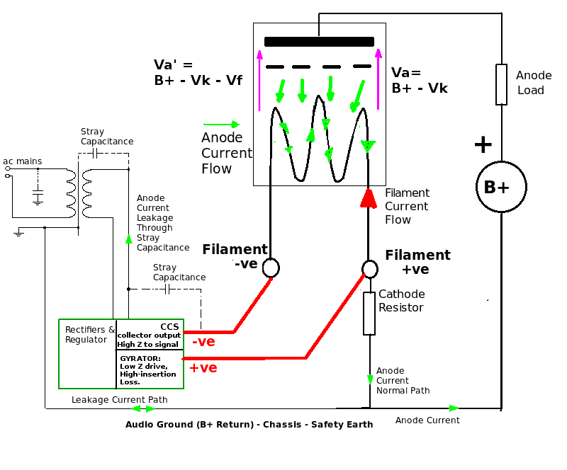

Hi Relu,
I'm probably wearing out my old diagram, but I've attached it again to show the noise paths that the regulator is trying to deal with.
Noise appearing on either side of the raw filament supply (+ or -) can creep into the circuit. Having a CCS on one side, and a gyrator on the other forms a noise-blocker for both paths. This might be mains noise, or rectifier recovery pulses.
With high frequency mains noise, it usually arrives as common-mode. BUT, if the + and - wiring follows different paths, it may not remain in common mode.
With fixed bias, one end of the filament is grounded, but the gyrator is still working hard to avoid circulating noise currents, and to block noise from getting into the CCS section, allowing the CCS to do a better job.
However, if you would like to try the regulator connected in the way you prefer, then it should still work. If you try it like this, please let us know how you like the sound in each connexion.
Probably best to test it in "normal" mode before trying that though.
Properly connected, with a decent transformer, and the raw dc prepared according to my Application Note, the Regulator should cut the noise across the filament all the way down to the microvolt level, even where you have ~200mV of incoming supply ripple.
I hope you enjoy the sound of the Regulators!

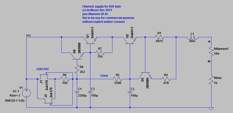

Ikoflexer:
Interesting design! Simple and with very good performance.
I am curious at your listening impressions.
Two extra listening tests I would advise you is to disconnect C3 to make Q4, Q1 a real Darlington. Measured/simulated performance will be less, but I expect it to sound better. Also you can omit R7 to raise Hfe of the darlington, ofcourse when everything remains stable. This could also enhance sonic performance.
Peter

It is rather simple:
Rectifier tubes - 1st filter cap - differential choke - 2nd filter cap - CCS - common mode choke - tube
With rectifying diodes:
Diodes - filter cap - CCS - common mode choke - tube
I will try to upload some pictures later.

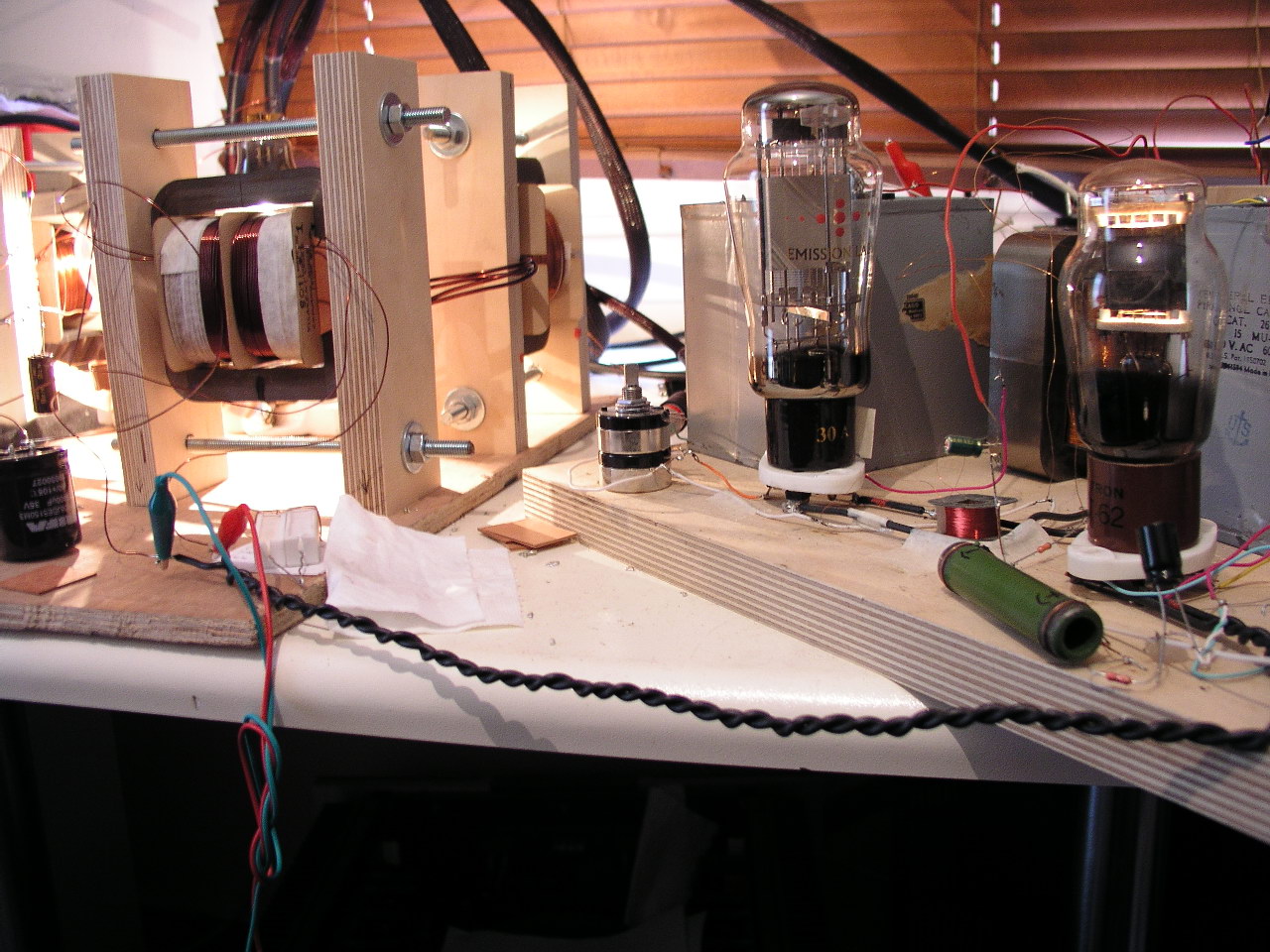

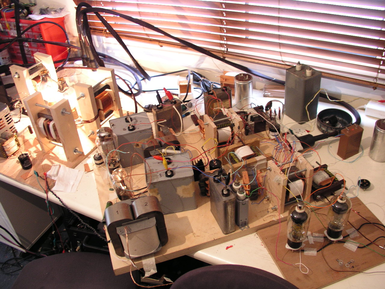

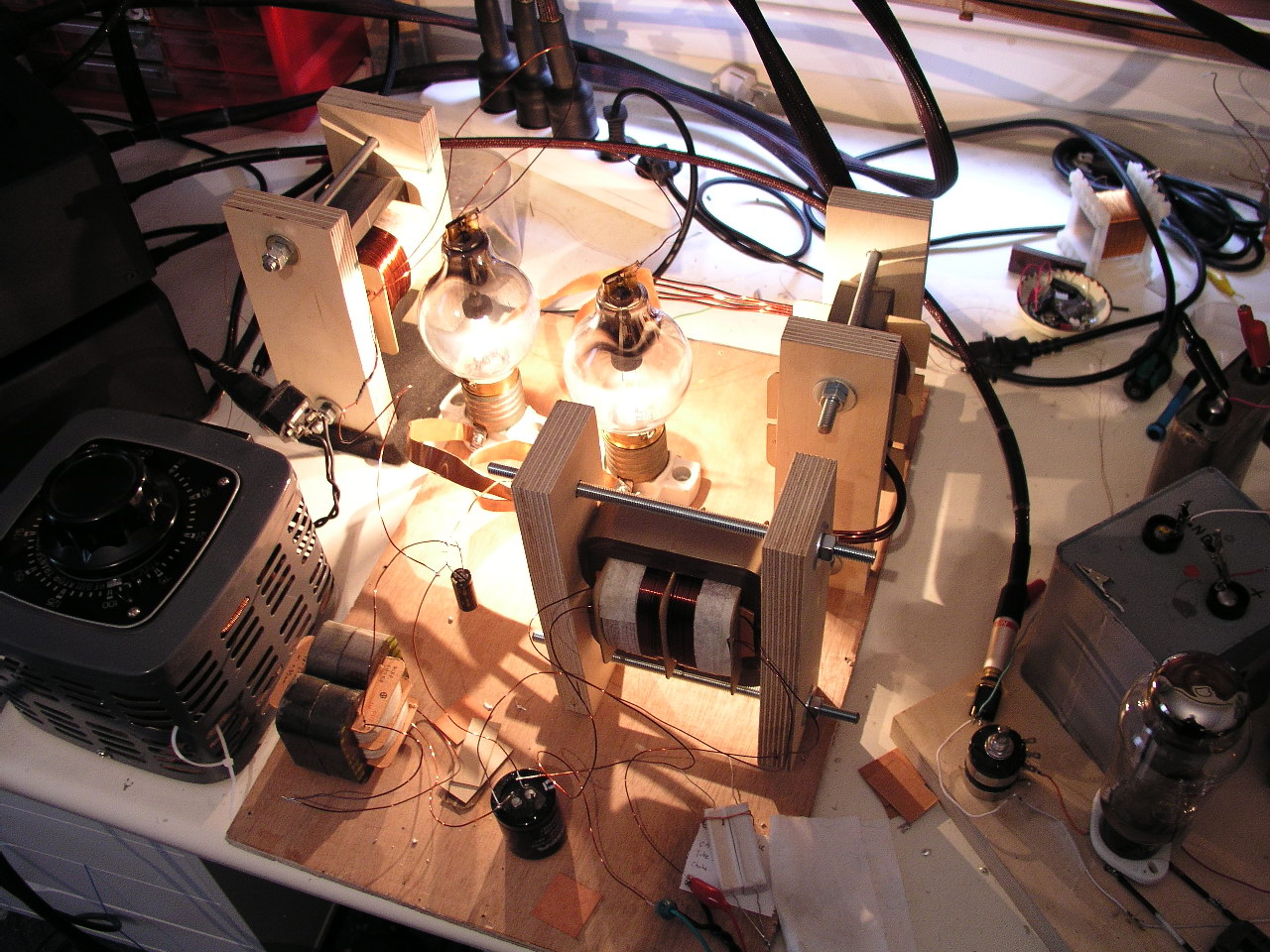

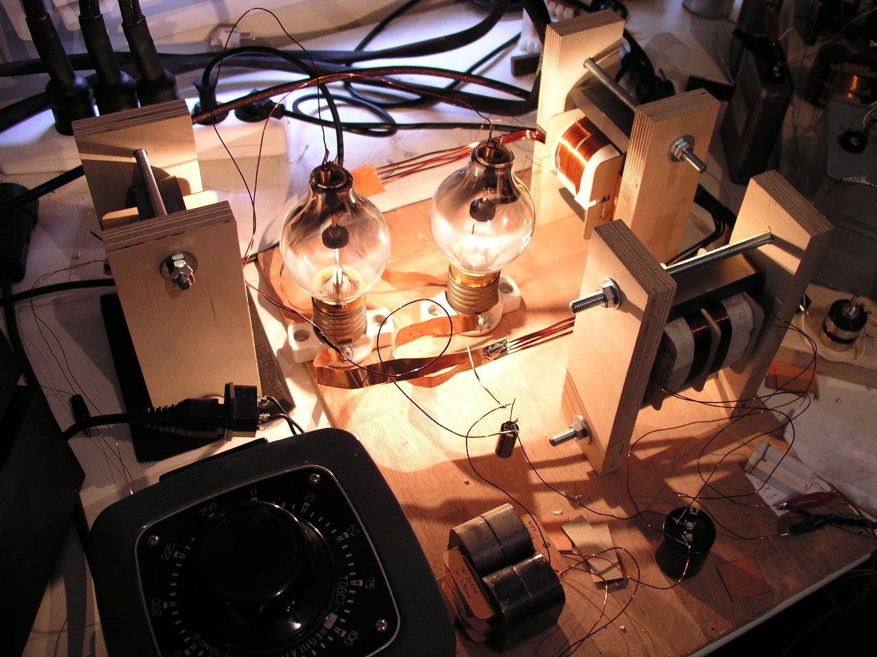

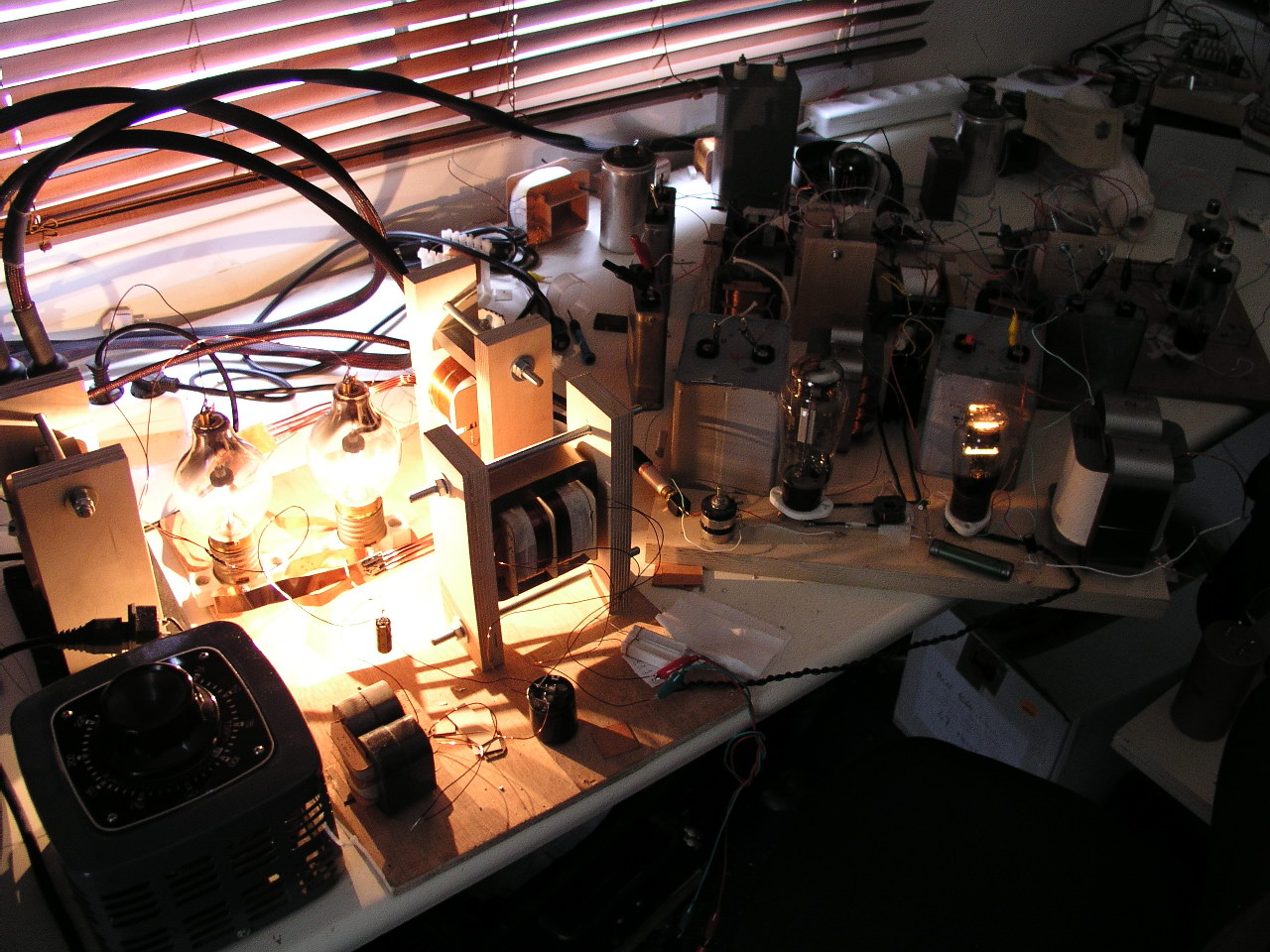

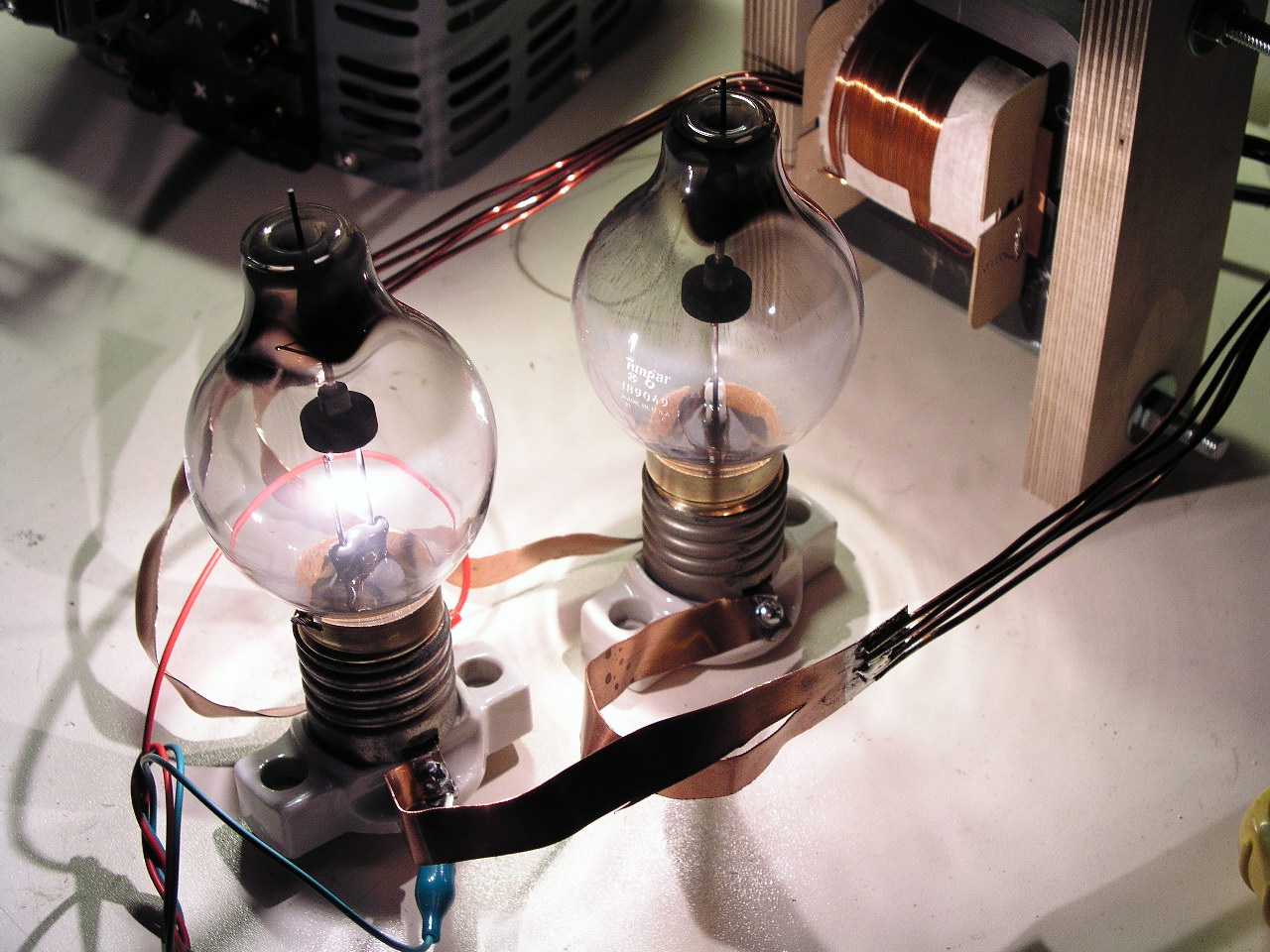

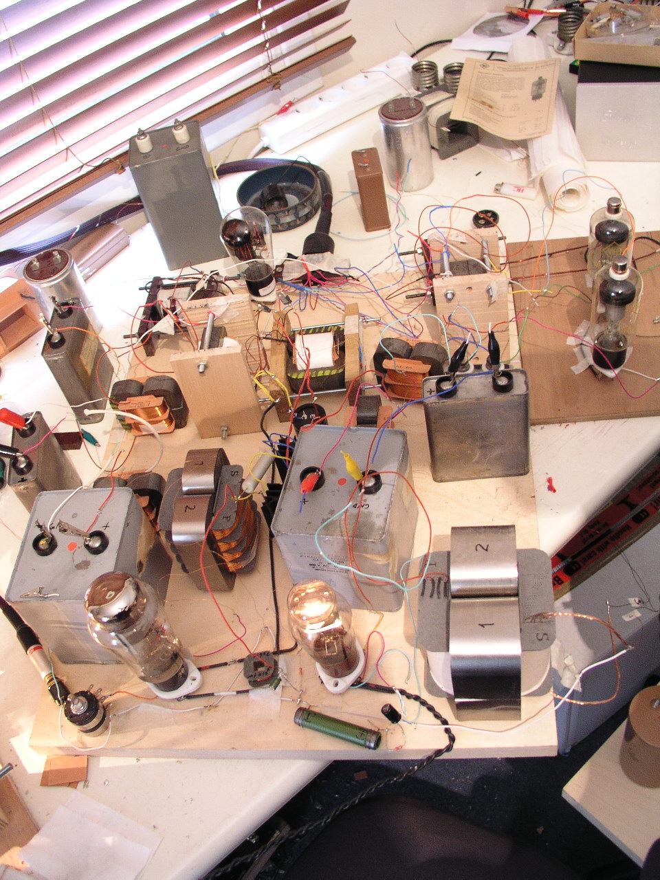

Yes,
it is enormous indeed!
Below you will find some attached pics.
This is the 801A amp I'm building for a friend. Power tube 801A is driven in A2 by Emission Labs 30A tube. Tubes rectification throughout. This is quite possibly one of the very few power amps around where both High Voltage and filaments (of both tubes) are rectified with tubes! For the time being, 2 GE tubes ignite the output tube.
All iron pieces are manufactured to my standards and wound by myself. In the end each active stage will be supported by 9 (!) iron pieces, so the stereo set will have 36 transformers and chokes. The cost is enormous, considering the 6Watts of output power.
I have listened to almost anything on filaments supply. The - hands down - best solution is to use the following sequence:
Rectifying tubes->1st filter cap->differential choke->2nd filter cap->very big common mode choke->filament.
Differential choke is a must in order to avoid startup stress on rectifying tubes. 1st filter cap is only 1000uF but up to 3300uF is allowed. I have some other rectifying tubes with mercury, where the 1st filter cap must be limited to 1000uF.
Unfortunately the filament voltage must be stabilized so a CCS is unavoidable, otherwise filament voltage fluctuates besides allowed limits. This deteriorates the sound a little bit but there is no way to escape from it.
This is the most crazy solution to filaments heating. Unfortunately, it is by a ***huuuge*** margin the best performing sonically. Nothing can come close to its performance. Why on earth the most crazy solution tends to sound the best?
Has anybody tried anything similar?
cool project
Use a DC servo around your CCS loop and it will stabilize the whole
good luck
Yes,
That is so completely over the top that I must applaud you.
Thank you very much for your comments.
Peter.
Very impressive indeed!
I'd wind my own chokes, but can't find cores. Where do you get your cores from?
This is a bit off topic, but do you wind your own output transformers as well?
Hello from Athens, Greece.
You can buy very good quality cores from Alphacore USA.
Link is C-cores Stock
All signal transformers' iron cores seen here are ordered to a factory in Hong Kong, they produce the magnetic material I want and these are custom order. It is not possible to acquire those cores as the material is proprietary. It is not CRGO, not Permalloy, not Supermalloy, not Nanocrystalline etc.
I wind all kinds of chokes and transformers by myself. Each stage of this amp is equipped with
- 1x filament rectifying tube filament transformer (2.25VAC)
- 1x filament rectifying tube high voltage transformer (~35VAC)
- 1x differential choke for filament ignition
- 1x common mode choke for filament ignition
- 1x HV rectifying tube filament transformer (2.5, 4 or 5V)
- 1x HV rectifying tube transformer (~2x700 VAC)
- 2x differential chokes for HV filtration
- 1x signal transformer (interstage or output)
Both interstage and output transformers have ultra wide bandwidth. I ended up winding whatever I want because there exists no OPT or IST that could come close to my standards both to measurements and sonic performance.
I hope all the above help a little bit.
Have a nice day!
Wow, very very cool.. I think you are the first person I have seen in modern history to use tungar bulb rectifiers.. Certainly unique, can you share some schematics with us? I have no gut sense of how to implement rectification with tungar bulbs - can they handle significant capacitance (presumably they can since they were commonly used in antique battery chargers) and I assume you have lots of low dcr choke action going on.. Very lossy voltage wise or not?
