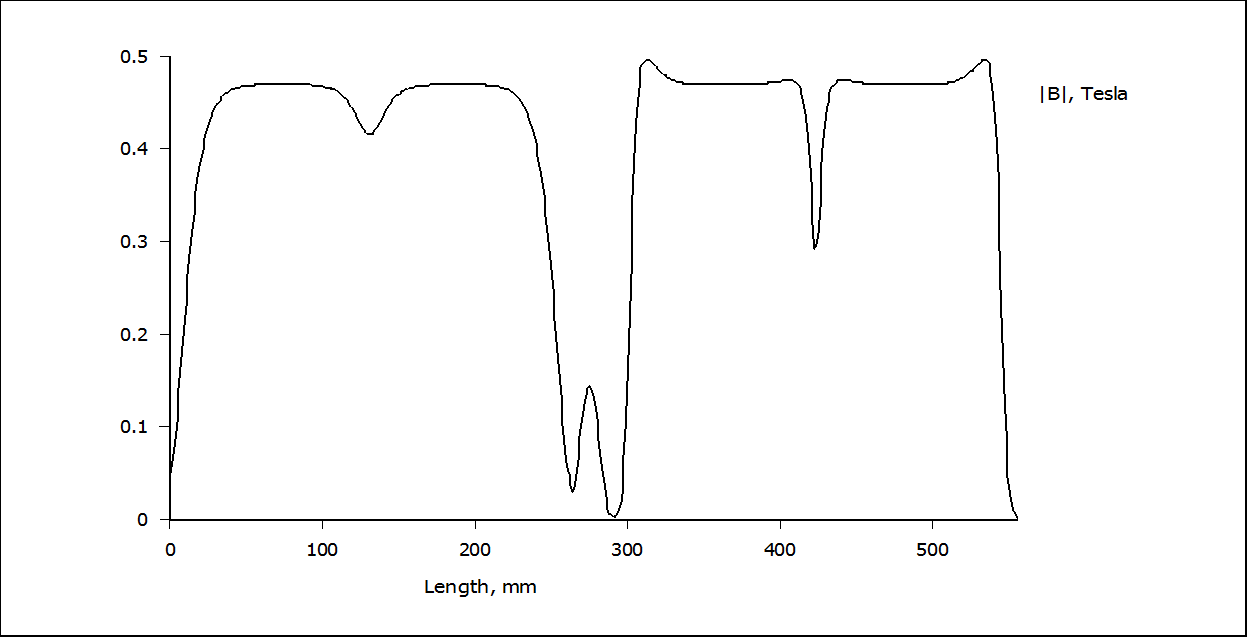

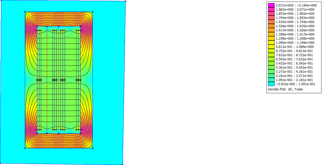

A simulation with N40-neodym-magnets and pure iron gives this result, with N42 magnets, B should be a little higher:
attachment.php
Left is the wider gap, right the smaller one, B on the plateaus is 0.47 Tesla.

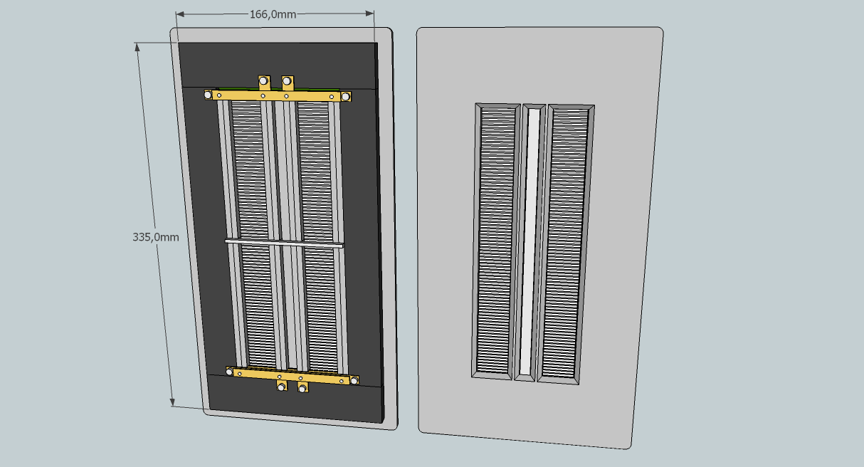

If you want to build one, I'd recommend gluing this whole thing on a suitable faceplate, without a solid mount the magnets in the middle could get loose. Heres a sketch with folded ribbons for the midrange and straight ribbon for the tweeter (straight ribbons cause less distortion, but are more critical at "large" excursions):
attachment.php
Of course you could try other lengths of the overall construction as well, but if you make the ribbon longer, you should make the outer magnets larger and if you make the outer magnets larger, you should make the iron parts wider as well. I have a simulation with twice the ribbon length, doubled magnet size and doubled iron width. B is then around 0,56 Tesla then.

Problem No.1 : Glueing the (middle) magnets on one side only is too risky when you consider long-term stability and corrosion of neodym magnets , the attracting forces between the only 10mm spaced apart magnets are quite high and there is no iron on their back to hold them in place ...
Problem No.2 : Unsymmetrical field distribution across the gap (more pronounced in the outer gaps) , this makes torsional deformation of the ribbon (rocking mode) ...
Problem No.3 : Very unsymmetrical field distribution along the depth of the outer gaps , this stresses the ribbon mechanically and can lead to long time failure ...
Problem No.4 : The current in the outer ribbons will induce eddy currents in the iron return path structure and due to the inherent asymmetrical layout of your triple ribbon structure it raises the same problem like "Problem No.2" but this time the force vectors on both sides of the ribbon are reversed , also the force difference could be much higher than "No.2" .....
Problem No.5 : Even if you solved "Problem No.2" there is still an uneven field distribution across the width of the gap , RAAL found a solution named "Equafield" , I think it contributes significantly to the high power stability performance of their designs .
Problem No.6 : Unavoidable close acoustic coupling between your triple ribbon structure leads to modulation of the center ribbon output . This is the price to pay for wider HF radiation ...
Simulating a virtual depth of 10mm does nothing in FEMM , which is still a 2D code . Optimizing the field distribution in all directions needs a true 3D code , or you have to live with a few percent of errors .

The gap was tested by "LineArray" from Dipol 08 Lautsprecher sowie neue Vollbereichs-Flchenstrahler Modelle and he said it had a pretty good effect... so, why not? I think you must remember this thread, as you gave your 1,5 cents there as well.
Problem #1: Just a mechnical problem, the right glue should do it, maybe an additional brace in the back of the tweeter should give the last bit of stability. Do neodym magnets corrode by themselves?
Problem #2: Field distribution across the gap is flat, an by "across" I mean from iron part to iron part, and by "flat" I mean a straight line... so no rocking mode here...
Problem #3: Field over depth is not flat, yet symmetrical, more like a gaussian curve. 10% decrease in B is at +/- 4mm, that should be enough.
Problem #4: Those eddy currents, if they should turn out as a problem, should be reduced by using not a solid iron, but transformer sheets.
Problem #5: Same as in #2: the B-curve is flat all across the gap.
Problem #6: Woofers near a ribbon should be even worse than a ribbon next a ribbon, plus this is no problem if you use a transconductance amplifier...
From what I read, FEMM simulations are pretty reliable. Do you have sources that state otherwise? What is a good software to simulate this ribbon in 3D?

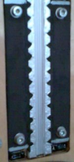

my own ribbon tweeter design built in 2002 had vertical folds ...
For this reason it has very high stiffness along the longer
(vertical) axis, which a conventional ribbon does not have.
An audible bending mode occured as a consequence, which could
be mitigated to be inaudible by introducing a center gap to the
magnets, which was considerably wider than 3mm, i guess it was
double at least. That was done to weaken the field in the center.
A modification - or 'workaround' if you like - which worked very
well in that specific design to solve that specific problem.
When using the common horizontal folding or flat membrane
configuration, that problem will not occur and the gap is presumably
useless if not detrimental.
