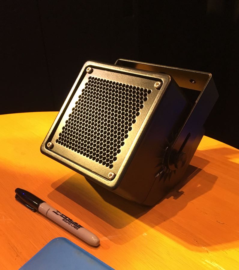

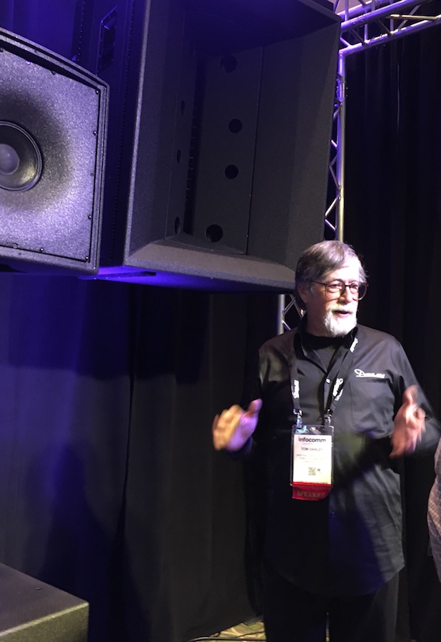

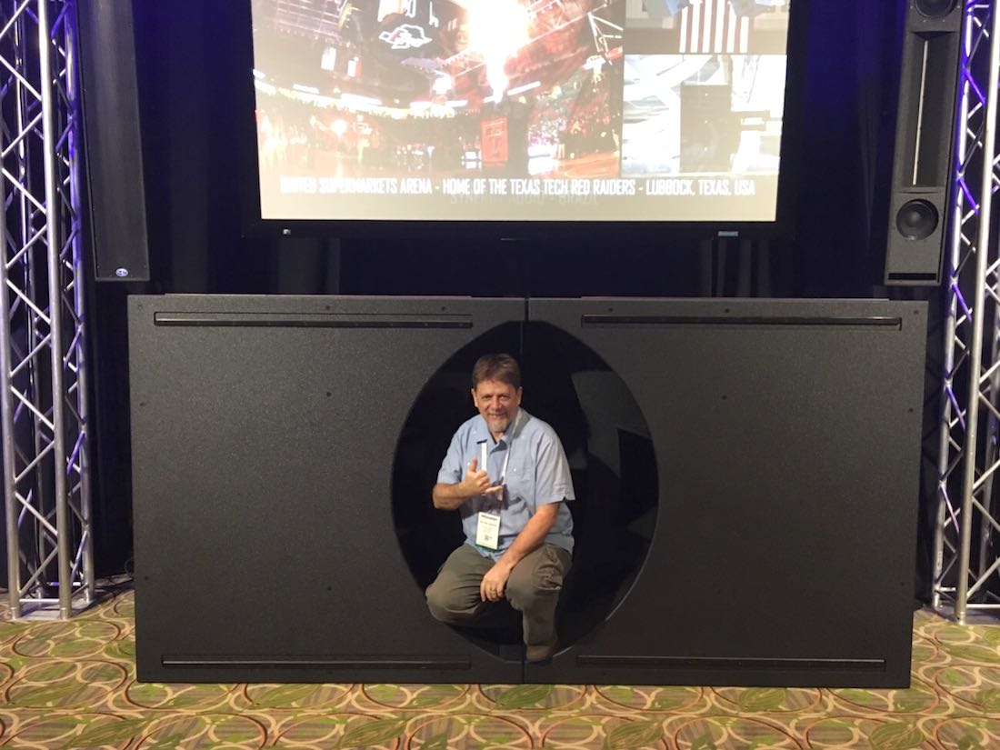

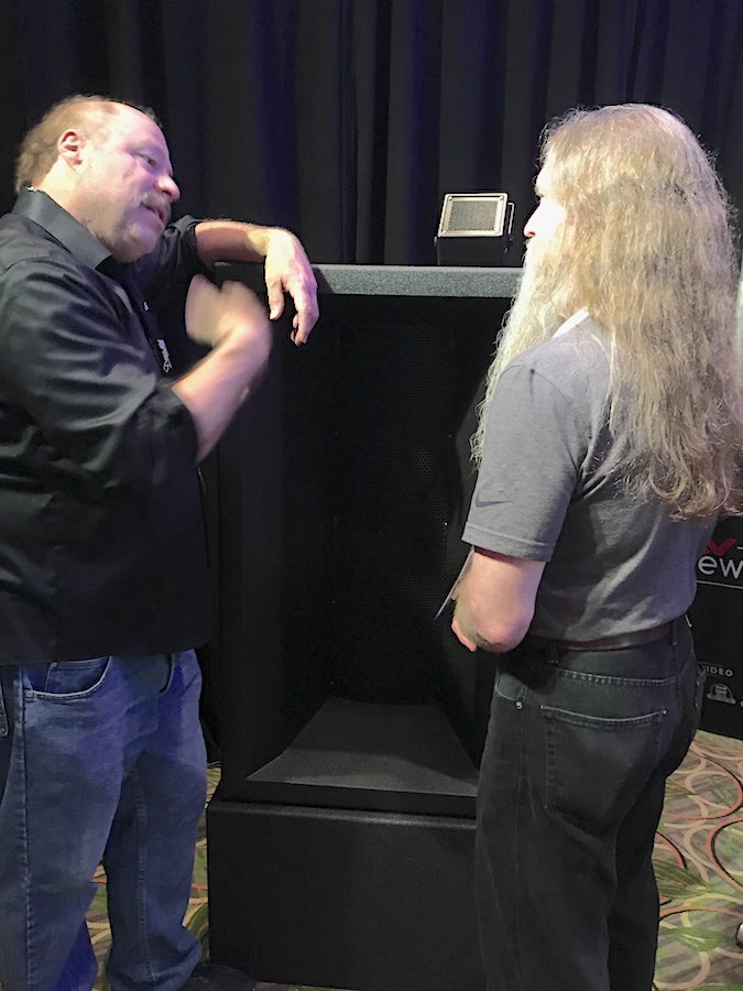

Some photos from the Danely Sound Labs demo in Orlando yesterday. Looks of cool speakers to hear and see.
The little Nano was impressive, as was the giant subwoofer. You can see Pano really "gets into" Danley Sound. ;)
Also shown is Tom in front of a Jerico, someone admiring the tapped horn with coax - they really hit hard, and a couple of guys leaning on the new narrow beam J6. Being inside, we heard it at modest levels, but it still sounded great. They said they've gotten it to over 110dB at 100 meters! :eek:
