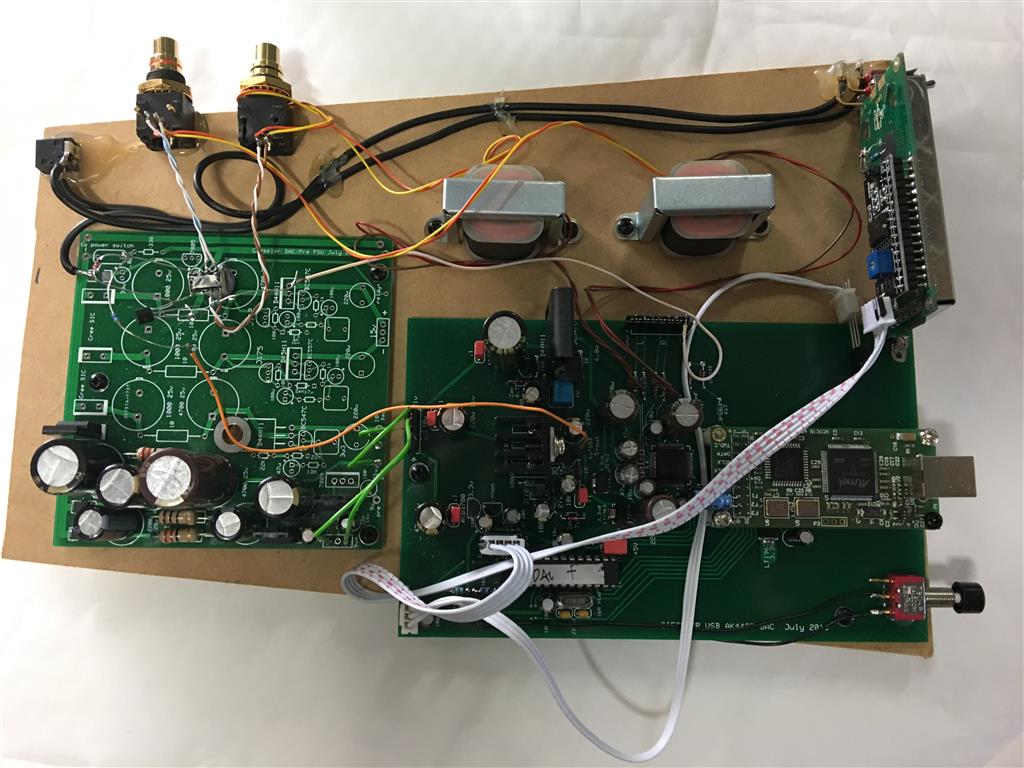

I have a Jensen jt11p with the ak4495, it sound pretty darn good.
One thing about transformers is that a lot of them ring (I have measured a few with a scope). For Jensen jt11p I use their recommended snubber 13k + 620pf across the secondary and the measurement looks good, you might want to check the snubber value for your your Jensen.
Hi Chuck,
Thanks for that info. I will fire up the scope & see how a square wave looks.
The transformers I am using are Jensen JT-11-FLCF. 1:1 standard 600/600 ohm output transformers. My board has no output stage so the transformers were just a quick lash up to have a listen. Currently no snubber or loading on the secondary but I have to admit it sounds pretty good as is.
i just wondering why using transformer with AKM dac output?
as i know AK4490/95/97 are voltage output which doesn't need IV converter.
the only need for the outputs are low pass filter to match the internal frequency response.
so AK4490/95/97 need LPF, is that output transformer act as LPF? :confused:

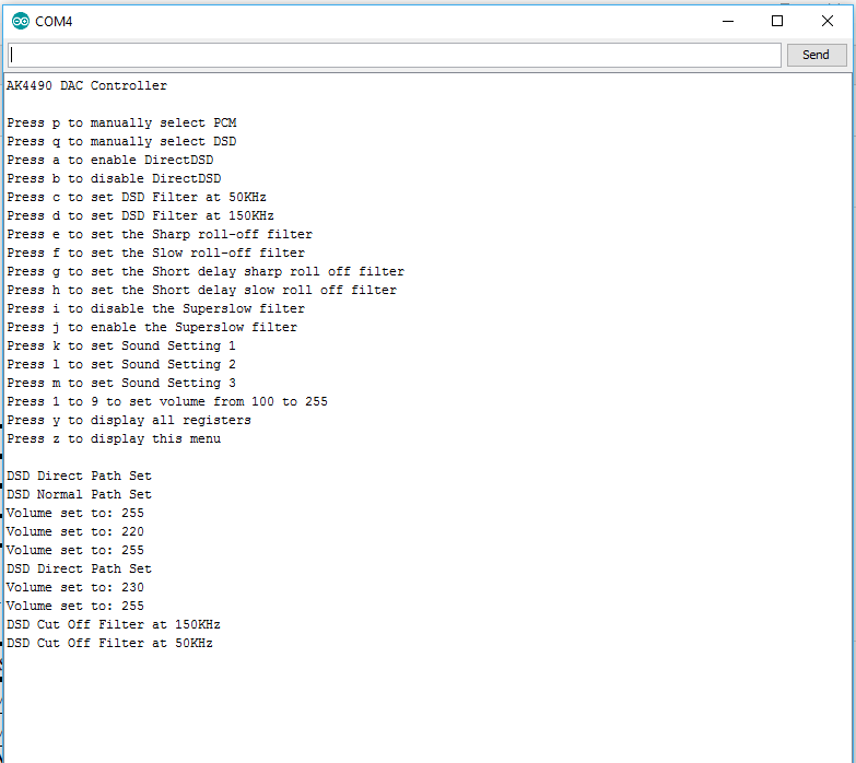

I finally received my test boards and built one to make sure that I had a proper handle on things. Everything seems to be working fine.
I wrote a piece of Arduino code to control pretty much every parameter of the chip that relates to sound quality for my single chip board. I've put it up on my blog.
It accepts commands through the serial port to change the various options. Here is its menu:
attachment.php
Next up is building a second unit so I can try dual mono operation.
What concerns me is the output stage. I've looked at the dual mono reference design for the 4497 part but I haven't gone as far as comparing the 4490's output characteristics with the 4497's so as to determine whether the 4497's reference design could be applicable to the 4490s.
I also don't like the 100uF capacitors in the signal path, before the summing of the signals. I would like to have full DC coupling if possible.
I'm a noob at analog electronics so any suggestions would be appreciated.
I'm OK with using op-amps but I would prefer something more "interesting", of the class-a discrete flavour. Balanced output would be preferable.
wengtech - the AK4497 outputs a diferental signal also with dc (2.5v)
The transformer is just a very simple way to remove the dc & also obtain a single ended output (rca) if required. Depending on the transformer there may also be some hf filtering.
